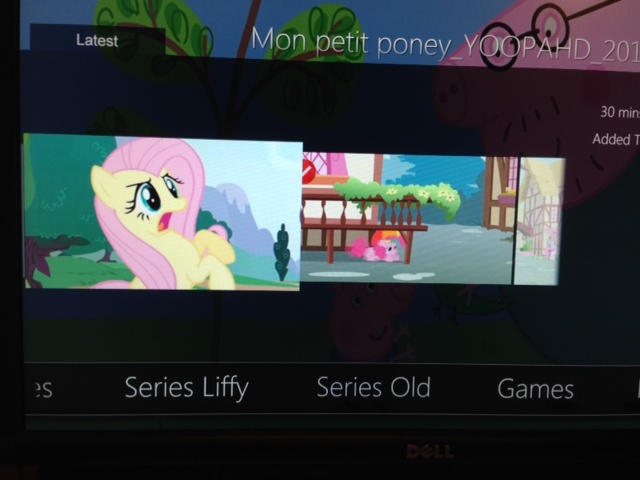

lobo683 0 Posted August 5, 2014 Author Posted August 5, 2014 (edited) The Poster Still wont Show Up in EHS but now instead of the Default blue icon i now have a screenshow of the actual Video. Anything else you can think of ? Edited August 5, 2014 by lobo683

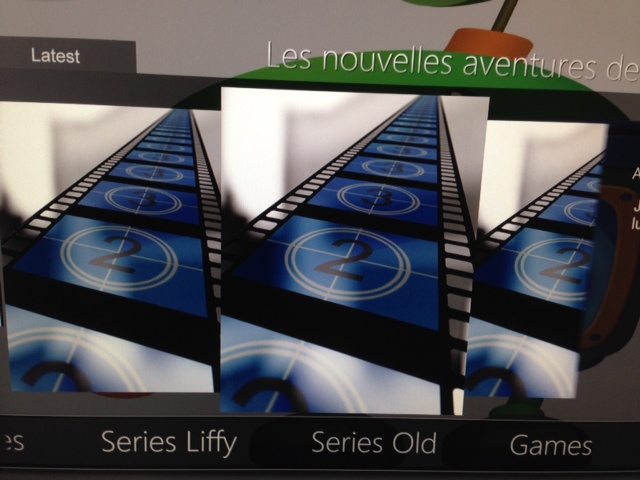

lobo683 0 Posted August 8, 2014 Author Posted August 8, 2014 Yeah did use the web interface everything show up fine Except the poster on the Ehs home screen (as you can see with my attach screenshot) But i'll give a try to change the Type as My series and movies come up fine on the home screen
