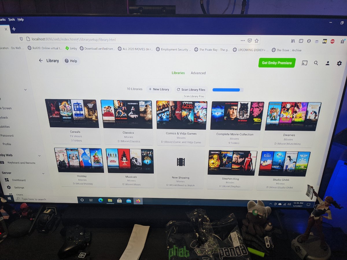

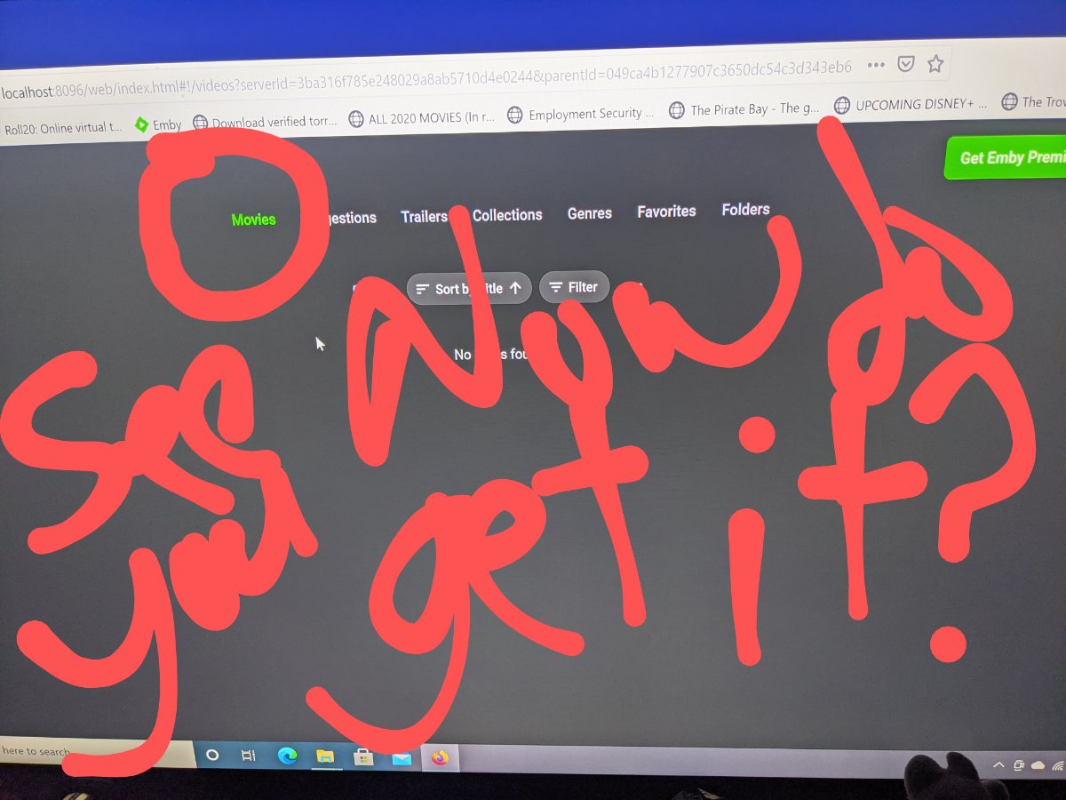

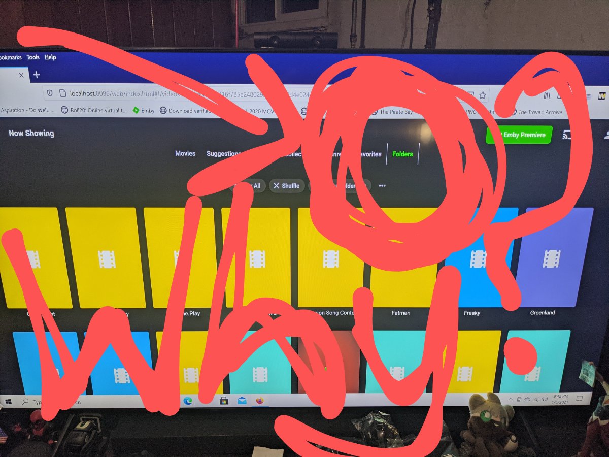

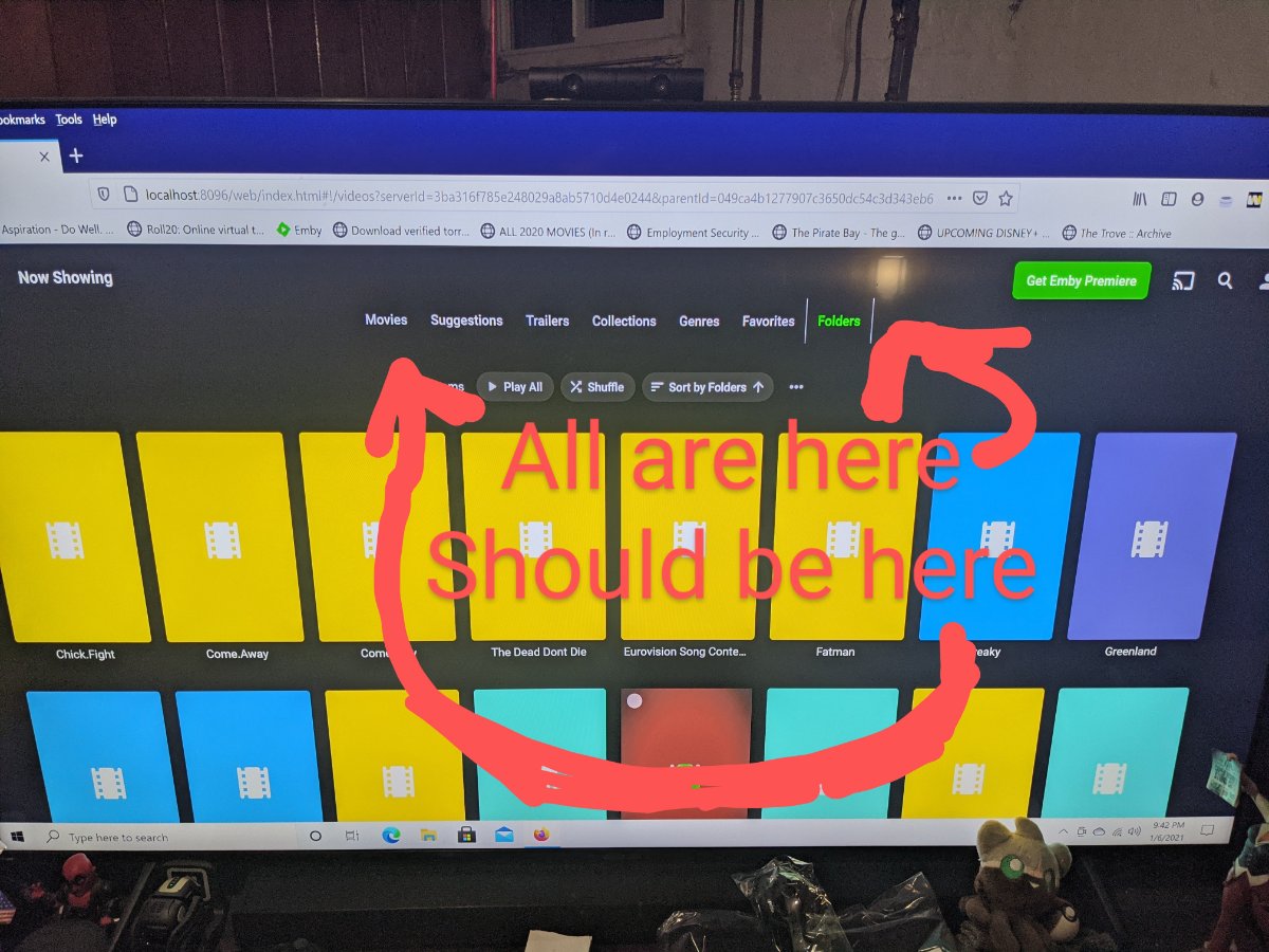

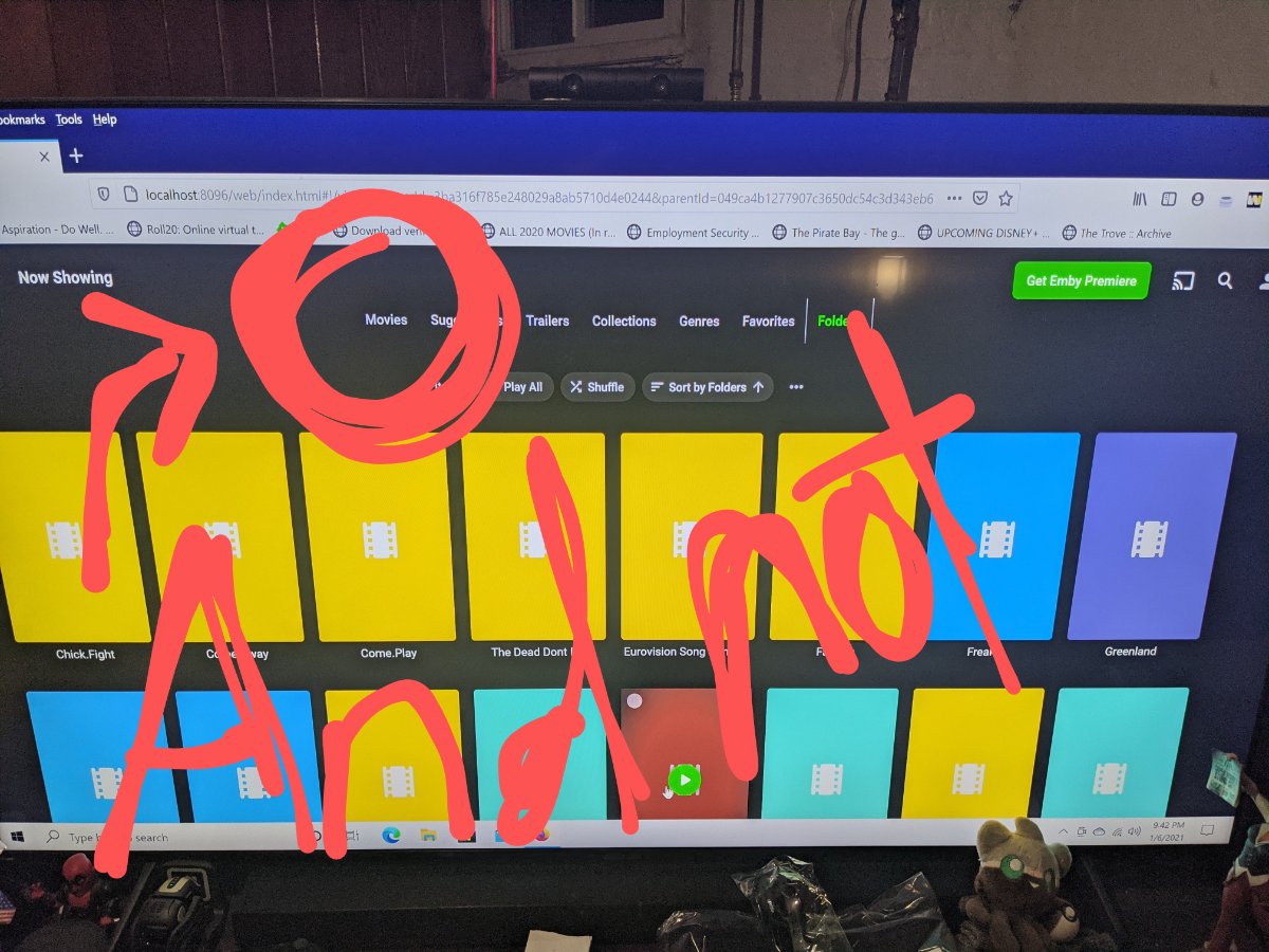

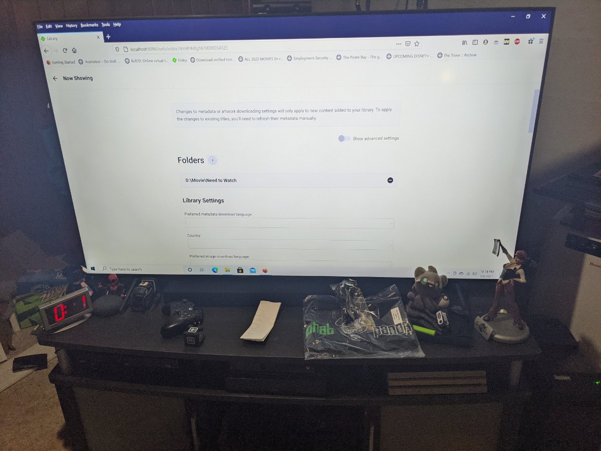

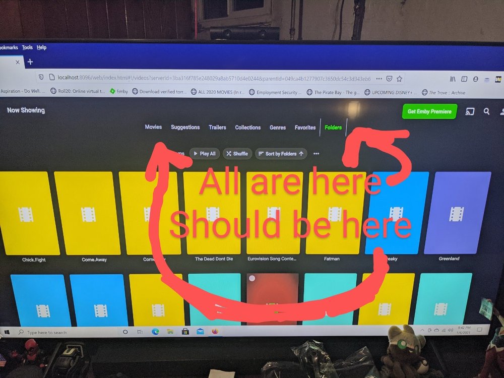

GeekInc42 1 Posted January 7, 2021 Posted January 7, 2021 (edited) I Just upgraded to a desktop from my surface, and in the process of setting up my server(not a single change in folders, file locations, AnYtHiNg) But now all my movies won't actually display Under the proper "Movies" tab instead of the "Folders" tab And this happens in ANY media library I crate that's a movie library Edited January 7, 2021 by GeekInc42 Verbage change

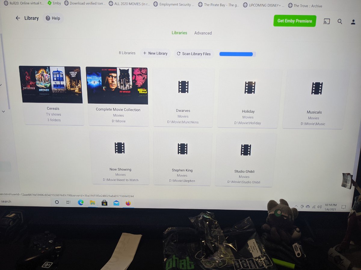

Luke 43433 Posted January 7, 2021 Posted January 7, 2021 Hi, there's a good chance the issue is this: If you don't think that it is, then please tell me how many Emby libraries you've created, and what folder path did you add to each one?

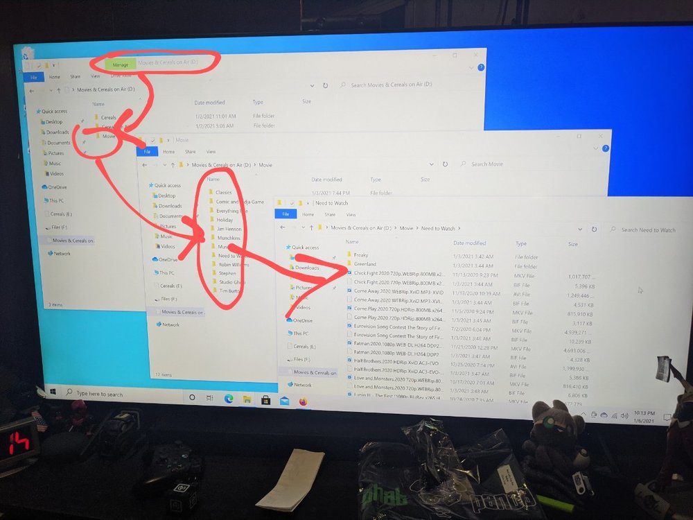

GeekInc42 1 Posted January 7, 2021 Author Posted January 7, 2021 Here ya go Because they are all deffinitely "Movie" Libraries. Again I've changed NOTHING since all the were connected to my surface and last server and the last server didn't pull a stunt like this on me. Also I've allready deleted like 3 other libraries in frustration currently And lastly I have a library that does show them all in the proper place but that is only the all Encompassing D/Movie folder. And if your going to tell me the only way to fix this is by removing the other files from my sub folders you can take that elsewhere

Solution Luke 43433 Posted January 7, 2021 Solution Posted January 7, 2021 If you have a library pointing to d:\movie, then you can't have another library pointing to d:\movie\holday It's something we'd like to be able to accommodate in the future, we're just not quite there yet.
GeekInc42 1 Posted January 7, 2021 Author Posted January 7, 2021 (edited) Problem solved, I guess in the past instead of selecting the overarching drive I've also individually selected folders in the past. It appears in my tired hazy set up of the server this time I attempted the shortcut overarch instead. I have gone back and adjusted and now once the scan completes everything will once again be as it was in the Past Edited January 7, 2021 by GeekInc42 1
