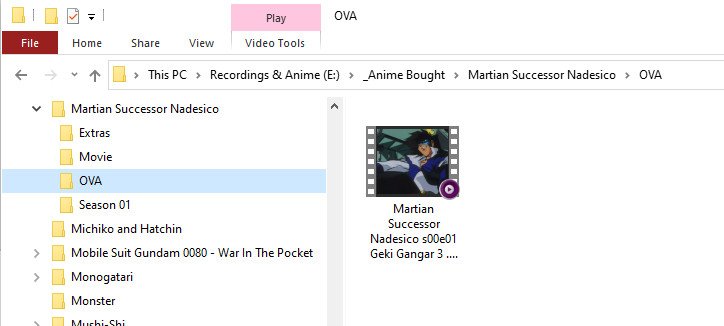

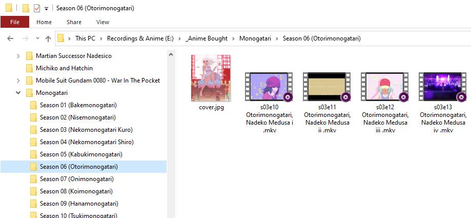

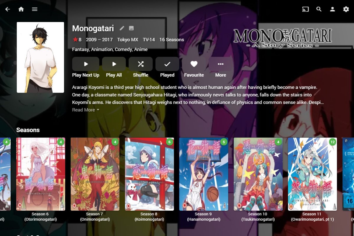

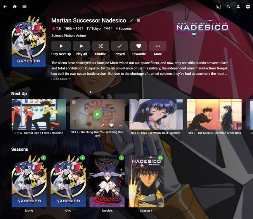

sooty234 266 Posted January 4, 2021 Posted January 4, 2021 How do you separate the extras from specials in a TV library? I had this sorta working, previously. The library would show two sperate folders/covers with different videos in them. Looking at how I set it up, the server appears to no longer allow this. There are videos that are not part of a season, and there are the specials that are interspersed into the seasons. None of this seems to work anymore. I want the non-special videos to be separate and not included with any season, like the specials for movie. And then I want the specials also in their own folder that I watch only if I choose to. Instead, what I get are the specials in the wrong place and are appearing as the 'next up', seasons ahead of where they should be. I don't want the specials to be in the 'next up' at all. No matter how name the them, arrange them, or anything I do, they get merged into one, ordered in the wrong place, don't show up at all, and/or get stuffed in the 'next up'. Literally nothing works as I want it, or just doesn't work at all. The wiki is of absolutely no help, no variation works. I have the sense that it isn't possible, and I have to remove them all and put them in a miscellaneous library.
crusher11 1134 Posted January 4, 2021 Posted January 4, 2021 Your sense that it isn't possible is correct.
sooty234 266 Posted January 4, 2021 Author Posted January 4, 2021 37 minutes ago, crusher11 said: Your sense that it isn't possible is correct. Is what I thought. How crap is that?!?! Such a basic thing, too. The present system can't even put the specials in the right place... bah!

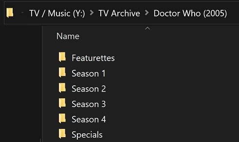

pwhodges 2028 Posted January 4, 2021 Posted January 4, 2021 (edited) It is possible if you are prepared to break away from the naming rules and use folder names which Emby doesn't understand - and also accept that the result may be broken in future updates: The order remains with Seasons at the end, because Emby recognises "Season" and does that with it; replacing the word "Season" might also be possible, but you'd probably lose season-specific metadata - I haven't tried that, though. Similarly it is possible to put episodes in the "wrong" season folders if the numbering on TVDB is completely nonsensical, In this example, half the series is put into specials by TVDB and most of the rest is combined in seasons as broadcast, when naming the separate stories makes more sense: Paul Edited January 4, 2021 by pwhodges 1

pwhodges 2028 Posted January 5, 2021 Posted January 5, 2021 3 hours ago, cayars said: Emby does already support extras for TV Shows: Sure it does. And it renames them "Specials" (see my example above); and it merges them with other specials. If you want to separate Specials and Extras (maybe separating out special episodes, commentary videos, and things like clean openings) Emby won't let you unless you get imaginative with folder naming, which works because at present it just shows you folders it doesn't recognise - at least we should be thankful that it doesn't supress them. Paul 2

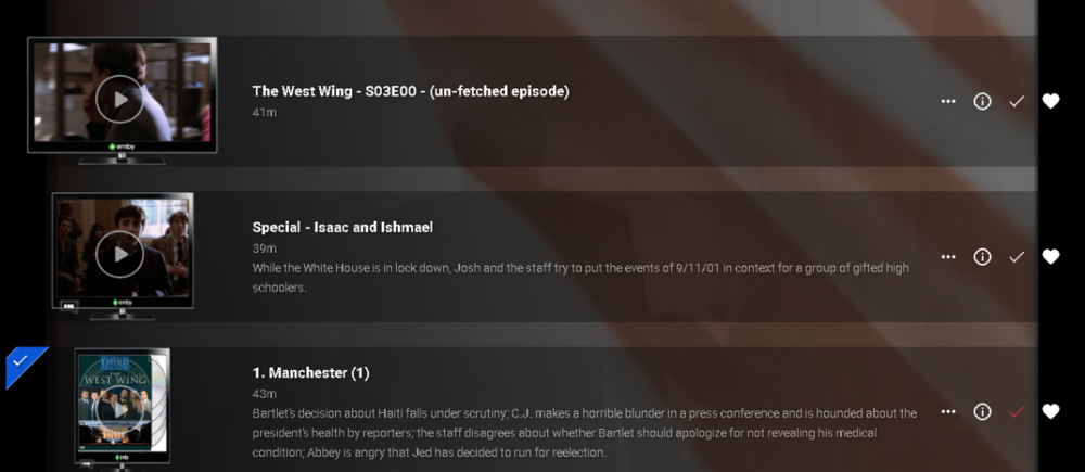

Carlo 4561 Posted January 5, 2021 Posted January 5, 2021 (edited) I have mine display inline with the seasons and not just in specials. They have to match up with meta-data from a provider. Edited January 5, 2021 by cayars
sooty234 266 Posted January 5, 2021 Author Posted January 5, 2021 7 minutes ago, cayars said: I have mine display inline with the seasons and not just in specials. They have to match up with meta-data from a provider. Well that sucks for you.
Carlo 4561 Posted January 5, 2021 Posted January 5, 2021 Why does it suck? Here's an example of a special inline from West Wing (2nd item) and an "inline" special I added to the front myself:
