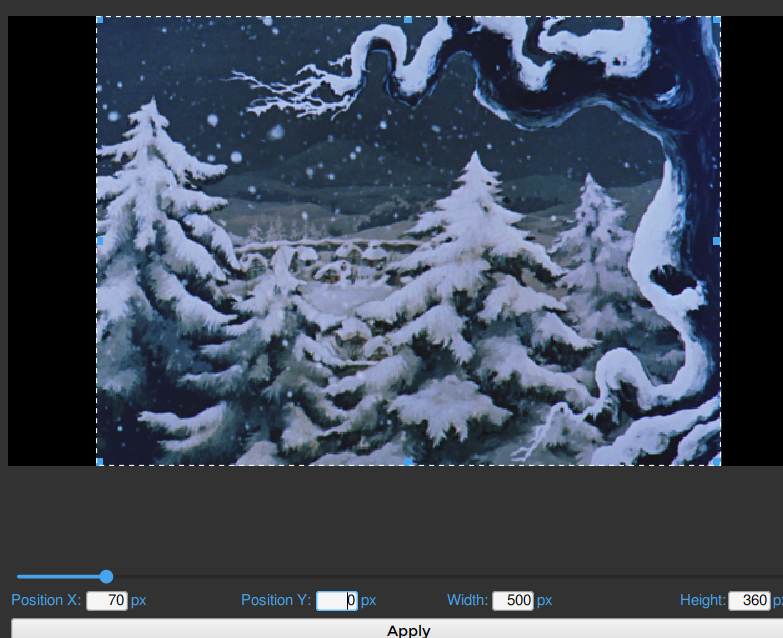

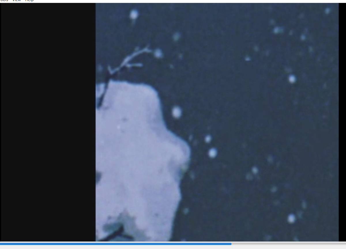

HrHauptfeld 1 Posted January 2, 2021 Posted January 2, 2021 (edited) I bought myself an OLED TV a few month back. After watching Netflix and Co. for some time, I wanted to watch my old TV-Series and Movies. The annoying thing about having a proper black on screen is, that all these older movies and series which where recorded in 4:3 or some other resolutions, now have these ugly grey areas on both sides of the original image. I think these where added when they put these movies on discs to make them into a "16:9" movie. To be honest, these stupid grey bars on both sides are driving me insane. I've already been recommended to use Shutter Encoder for removing the grey bars. I've been successful in removing the horizontal bars from a movie that was recorded in 2.35:1 by using the advanced cropping function. But I'm really struggling with the sources that have an 4:3 image. If I select the area to crop, the same way I did with the 2.35:1 movie, I'm just getting a heavily zoomed version of the top left of the original image plus the left grey/black bar. See imgs below. Selection in Shutter Encoder: Spoiler Result after converting: Spoiler Any ideas why this is happening? The only difference I've noticed is that the 4:3 source files have a resolution of 1080p, while the 2.35:1 file was just about 720p or less. The video format of the 16:9 files is also AVC (advanced video codec), while the other one was mpeg. And of course the that one has vertical bars and the other one had horizontal bars. Also quite interesting are the pixel values in the cropping selection window. I'm not sure if Shutter Encoder downscales the video so that it fits the sceen or if there's another reason for not having the full resolution of the source file. Edited January 2, 2021 by HrHauptfeld
