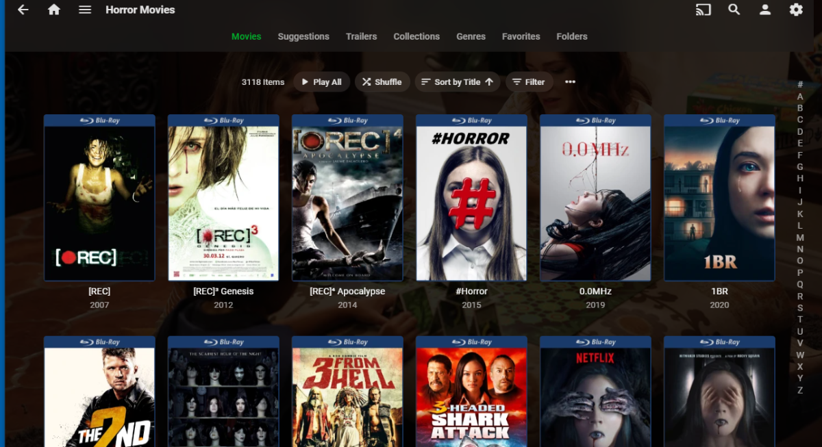

Mbppg 3 Posted December 31, 2020 Posted December 31, 2020 (edited) I have a few movies in my Horror folder not showing up. Current setup is Emby version 4.5.4.0 on an Unraid docker. I was doing a hard drive swap to bigger drives a few months ago and I lost several shows, movies etc. I have most of the movies and TV shows back but I noticed a few movies missing from horror folder on Emby. The are in the folder structure and named correctly and worked fine before the data loss. Also the Emby data was on a cache drive so no loss of data there. I have removed them from the folder and added them back to the folder and they do not show up. I have tried a few things but decided to backup and then remove the library DB. I let the discovery process run and the two of the missing movies showed back up. Until the discovery process fully completed about 24 hours later (I have over 40 TB of movies and tv shows) then they were gone again. I also do not see them in the metadata manager and they were there after the fresh DB started back up and disappeared again once the discovery process was completed. I think before I deleted the DB that I saw one of the missing movies "Teeth" was listed in the log file but then it looked like it was removed for some reason. But since the reboot, I no longer have that log file. I have included the latest one. Let me know if you need any other info or have questions. Thanks and Happy New Year (so done with 2020). embyserver-63744998631.txt Edited December 31, 2020 by Mbppg

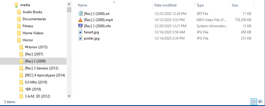

Mbppg 3 Posted January 1, 2021 Author Posted January 1, 2021 Top folder is media/Horror/movie name (year)/movie name (year).mp4. [Rec] 2 happens to be one of the movies not showing up [Rec] 2 not showing up in metadata manger

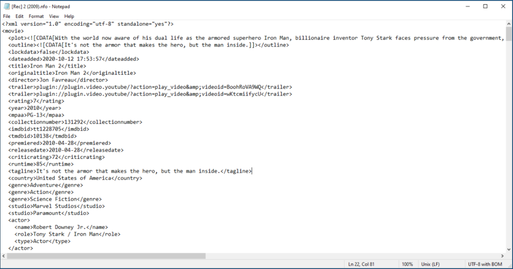

ebr 16310 Posted January 1, 2021 Posted January 1, 2021 What Cayars said. Look inside that nfo file. Dollars to doughnuts it says it is some other movie. 1
Mbppg 3 Posted January 1, 2021 Author Posted January 1, 2021 1 hour ago, Gilgamesh_48 said: I have [Rec} movies in my library and they are found and names correctly. However they have been in my library for a long time and I seem to remember that I had some trouble with their naming when first imported. What I remember is that they were named something weird and I had to do an "Identify" to get them named correctly.. Of course if you do not find the under any name then you can't "identify" them. If I remember correctly part of the problem with [Rec] is that Emby is supposed to ignore anything in square brackets so [Rec] would be ignored. Try naming those movies and folders just Rec to see if Emby can match them that way. I cannot guarantee that my old memory is correct or that what I suggest will work at all but it seems worth a try. Also when matched "[Rec]" becomes the first movie (Maybe the second behind "+1" ) in my library when it is sorted alphabetically but I change the "Sort title" to "Rec" as it seems more logical to me to have it in with the "Rs" Thanks Gilamesh, I did try that before I posted the original post and it did not work.

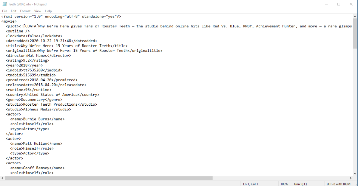

Mbppg 3 Posted January 1, 2021 Author Posted January 1, 2021 (edited) 2 hours ago, cayars said: It shows it as being "Iron Man 2" when it was deleted so that would be a good place to look. Also since you have the NFO you can open and look at this for clues. If the movie won't match correctly and the NFO has bad info you may need to remove the NFO or use it to find them movie and then manually identify it from the 3 dot menu. Okay so I opened the nfo and yes it thinks it is Iron Man. Which is funny as I have all the Iron man movies in my Movies folder and they are reporting correctly: So learning a lot here, but how does Emby pull this info in thinking it is Iron Man? Could it be the collections as that has been acting a bit weird as well? I also checked the IMDBid and the [Rec] 2 nfo file has the ID for Iron man and not the correct ID for [Rec] 2 which is tt1245112. Edited January 1, 2021 by Mbppg

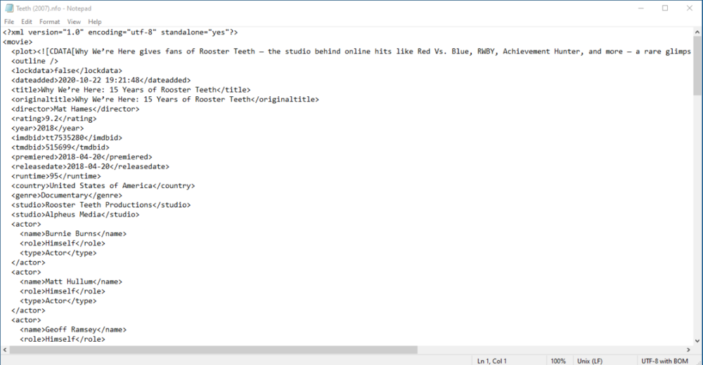

Mbppg 3 Posted January 1, 2021 Author Posted January 1, 2021 (edited) Looks like other movie Teeth is suffering from the same fate: Edited January 1, 2021 by Mbppg
Aevaris 8 Posted January 2, 2021 Posted January 2, 2021 22 hours ago, Mbppg said: Okay so I opened the nfo and yes it thinks it is Iron Man. Which is funny as I have all the Iron man movies in my Movies folder and they are reporting correctly: So learning a lot here, but how does Emby pull this info in thinking it is Iron Man? Could it be the collections as that has been acting a bit weird as well? I also checked the IMDBid and the [Rec] 2 nfo file has the ID for Iron man and not the correct ID for [Rec] 2 which is tt1245112. I found that once a media item has been given an ID, it keeps that and uses that as the source of truth (performance reasons I suspect). As a result, Emby will not attempt to re-identify unless you either remove or manually change/re-identify the ID.
Mbppg 3 Posted January 3, 2021 Author Posted January 3, 2021 21 hours ago, Aevaris said: I found that once a media item has been given an ID, it keeps that and uses that as the source of truth (performance reasons I suspect). As a result, Emby will not attempt to re-identify unless you either remove or manually change/re-identify the ID. Thanks @Aevaris, I went back and did what @Gilgamesh_48 suggested. I first deleted the nfo file, then moved the folders with the movies that were not showing up to a non linked library and ran a scan. Then I renamed the movies by added a space and then a 1 behind the name of the movie and then moved in back in the the library folder and ran another scan. Once the movie popped up I quickly identified movies with the correct data (using the identify screen) and now they are working fine. Then I verified the correct info was in the nfo file. Problem is I have over 24,000 movies and tv shows and I am sure there are a few more missing or mismatched movies and finding a few out of 24,000 if a pretty big task. But not sure if it is easy to make a tool or run a script to find mismatched movie names etc. Plus I would still like to know how Emby pulls the data in the first place. Esp. when I deleted the library DB completely, let a full new scan complete where the movies did pop up for a while but them later disappeared with the incorrect info. The one example I remember now is [Rec] 2 showed up in the library and metadata manager as the correct movie until the first scan after the new DB was completed then it disappeared and the nfo said it was Iron Man. I remember the log file said it was Iron Man before I deleted the DB as well so why or how did that carry over from a complete DB delete? Unless there is another file or DB I should have deleted as well????
