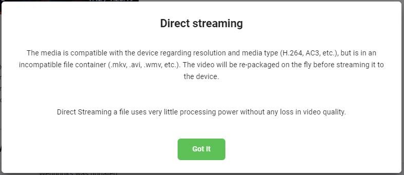

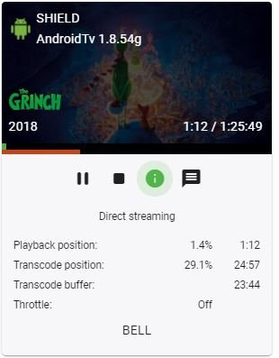

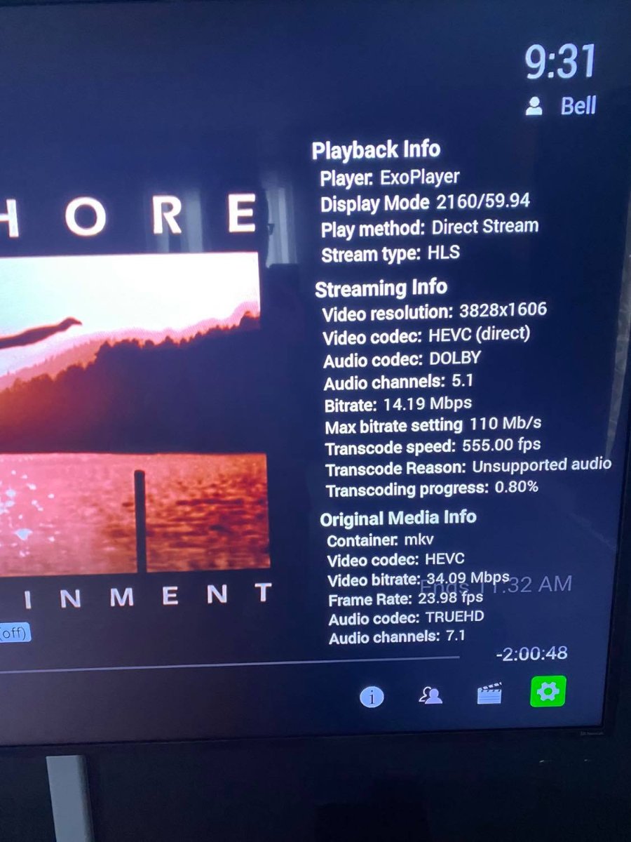

Carlo 4561 Posted December 31, 2020 Posted December 31, 2020 Sorry went back and re-read things. Nice machine BTW. Your screenshot doesn't show the file transcoding but direct streaming. Are you playing back with subtitles? Is your shield using WIFI or Ethernet? On the shield playback the file again and bring up the OSD and click the cog icon then select Stats for Nerds (SFN). Can you take a screen shot of SFN? Can you also give us a screenshot of the bottom of the detail screen for the movie that has all the meta-data info shown? If you playback the exact same file inside of Google Chrome it should be forced to transcode assuming the file is h.265/mkv. If you do this does it play without pausing/stuttering?
MathBell 0 Posted January 1, 2021 Author Posted January 1, 2021 (edited) On 31/12/2020 at 17:33, cayars said: Nice machine BTW. Thanks! Sorry I am not familiar with any of this and I have to admit that I didn't know what the difference between direct streaming and transcoding was. No, I disabled all subtitles since I thought that it could be causing the issue. My shield TV is connected to WIFI, but I can't see why it would be an issue since the same movie works perfectly on Plex. I attached the picture of the SFN information. Sorry for the picture, my shield tv does not take screenshots apparently. I also attached the metadata for the one movie in particular, but as I stated before, the problem isn't specific to a single movie but to the vast majority of my library if not all of it. It does the exact same thing within Chrome. The video in my initial post was taken on my computer using chrome, but the picture was taken on my shield TV. I also tried it on my Macbook pro using the application and I am having the same issues. Edited January 1, 2021 by MathBell

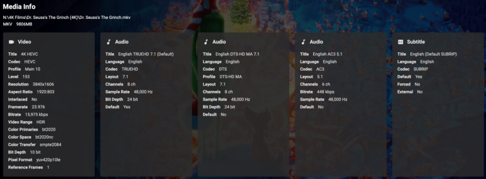

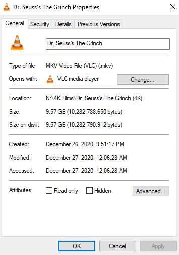

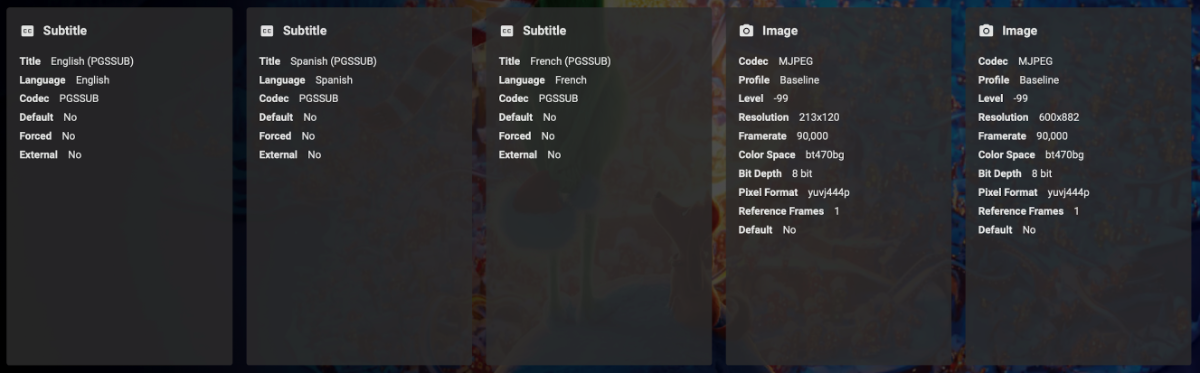

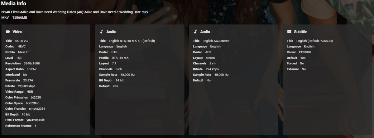

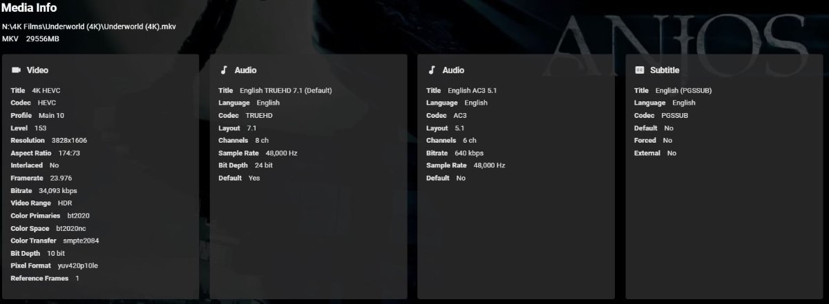

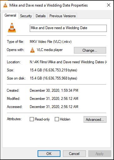

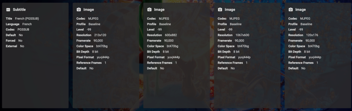

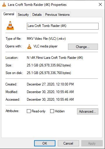

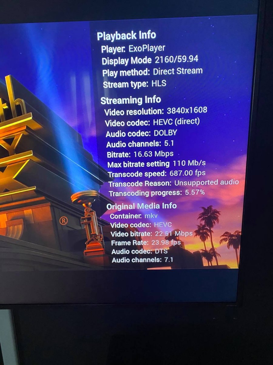

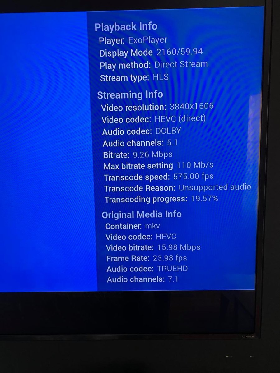

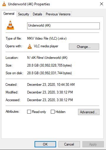

MathBell 0 Posted January 2, 2021 Author Posted January 2, 2021 (edited) Hi, New update that might help isolate the problem. I watch two movies yesterday on Emby and they worked perfectly. So I am starting to get quite confused. I believe they are all in the same format but I attached pictures of the properties, the SFN and the metadata for each movies besides the one already uploaded below. Movie that do not work properly: The Grinch & Lara Croft : Tomb Raider Movies that did work without any issues: Mike and Dave need a wedding date & Underworld I tried to find similarities or differences to the movies that do work vs. the ones that don't but I could not. Hopefully you guys can. If you need more information I'll upload as soon as I get a chance. I really appreciate anyone who is trying to help me. I really like the software and I'd like to be able to use it to it's full potential! Thank you, Mike and Dave's SFN: Tomb Raider's SFN: Underworld's SFN: Edited January 2, 2021 by MathBell
ebr 16310 Posted January 8, 2021 Posted January 8, 2021 Hi. When you tried setting a lower bitrate maximum you said you only went down to 21Mb. All the media you are playing are under that rate so the settings changes would have made no difference. Can you try setting it all the way down to something like 1 or 2 just to see if it plays smoothly? Then, start raising it slowly until you find the point where it doesn't. The server is transcoding fast enough (as it should since these are just audio) so there may be a network bottleneck.

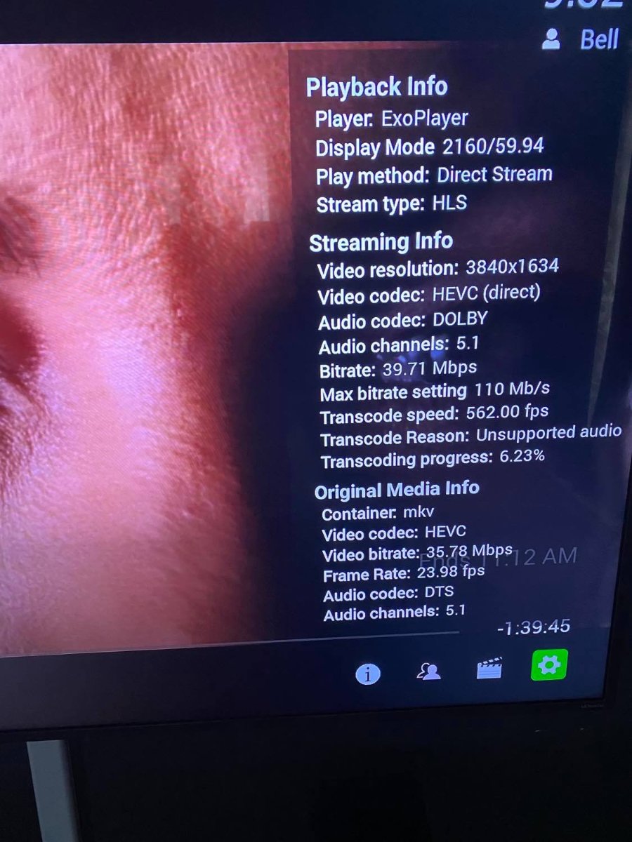

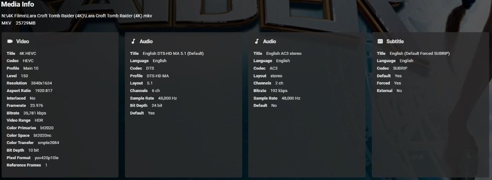

MathBell 0 Posted January 8, 2021 Author Posted January 8, 2021 (edited) Okay, so I've decided to play a different movie that has issues besides the Grinch and Lara Croft : Tomb Raider that I already showed in a previous video. So here is a recording of what the video looks like when being played on my android shield TV or my PC since they pretty much look the same on either but I can't record my tv the same way I do my computer. I will also provide the log for both the TV playback, the computer playback and the embyserver general log file. As stated previously, when using Plex, the movie plays without any problems on any system that I own. If it would help for me to record it or if you guys require any additional info just tell me and I'll be happy to provide it. I would really like to get to the bottom of this problem! P.S. The first and third movie of the resident evil sequel play work like a charm. Didn't try the rest of the series yet. ffmpeg-remux-8d893d1d-2b17-4781-8bd4-5218d11e3265_1.txt ffmpeg-transcode-0601bda5-caba-4854-b3a1-b557903d4491_1.txt embyserver.txt Edited January 8, 2021 by MathBell

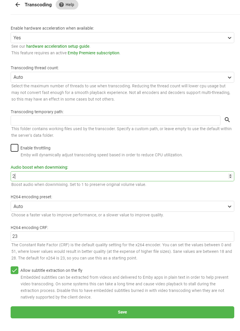

Carlo 4561 Posted January 8, 2021 Posted January 8, 2021 What do your settings look like under transcode?
Solution ebr 16310 Posted January 8, 2021 Solution Posted January 8, 2021 My guess is going to be that the issue in the web app is going to come down to something with hardware transcoding so playing with those options may correct that. Once you fix that, you will also be able to fix the issue with the remux by either not requiring an audio conversion with settings in the app or by using the Playback Correction option to cause it to transcode like the web app is.

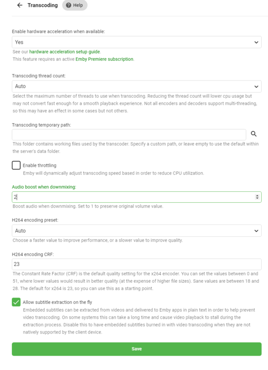

MathBell 0 Posted January 8, 2021 Author Posted January 8, 2021 2 hours ago, cayars said: What do your settings look like under transcode? Here are my settings prior to trying anything and next is the settings that make it work on the computer but not on the TV.

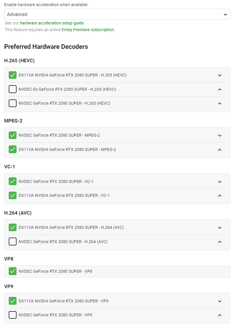

Carlo 4561 Posted January 9, 2021 Posted January 9, 2021 (edited) What version of nVidia drivers do you have installed? On my system I have NVDEC in the top spot enabled, and I never have this issue. This is with a 1650 Turing GPU. How I would test is to renable everything (for the codec being used) then deactive one by one with a test between each. With a few tests you should find the combination that works for you. Remember you have both DEcoders and ENcoders sections but from what I usually see it's the Decoders that usually cause green artifact issues. Edited January 9, 2021 by cayars
ebr 16310 Posted January 9, 2021 Posted January 9, 2021 13 hours ago, MathBell said: But I am having the exact same issues on my android Shield TV even if I disable transcoding completely. Right because it is the stream copy that is the problem there. 14 hours ago, ebr said: Once you fix that, you will also be able to fix the issue with the remux by either not requiring an audio conversion with settings in the app or by using the Playback Correction option to cause it to transcode like the web app is.
MathBell 0 Posted January 9, 2021 Author Posted January 9, 2021 I am not sure what you mean by the stream copy is the problem. But as you said, I am able to prevent any artifacts on all of my movies by changing the audio track. Using the playback correction had not effect. For some reason some movies with 7.1 audio tracks play fine and others don't. Regardless of the transcode options I have set, if I change the audio track to ac3 5.1 it works on the Shield TV. Still doesn't on the PC but if I change the transcode options then it works with any audio tracks on the PC. Being perfectly honest, I don't quite understand why that is and if anyone is willing to take the time to explain I would be grateful. But, at the moment, I am able to play every movie with a little tweaking which is what I was hoping for. Thanks to everyone that helped!
Carlo 4561 Posted January 9, 2021 Posted January 9, 2021 hi, the nutshell view is with using the alternate sound tracks you are likely able to direct play the videos and therefor bypass what causes the problem. As soon as it has to do any transcoding (video or audio) you have the problem with these Hi resolution files likely 10 bit using the encoders/decoders you had setup. The next version of the server beta will have more ffmpeg changes (ie support HDR to SDR tone mapping for 4K) and it would be appreciated if you could try that version when released in the next week or two to see if it helps with this specific problem as well. You should in the mean time experiment with the different decoders/encoder settings in the advanced transcoding menu.
ebr 16310 Posted January 9, 2021 Posted January 9, 2021 You were seeing two separate problems that looked the same. One was related to deficiencies in the hardware decoders and the other is related to trying to deliver HEVC streams in a certain way. The first was solved by you disabling the bad decoder and the second is solved by you avoiding delivering that stream in that way (by either transcoding or selecting an audio track or audio settings that will allow direct play). 1
