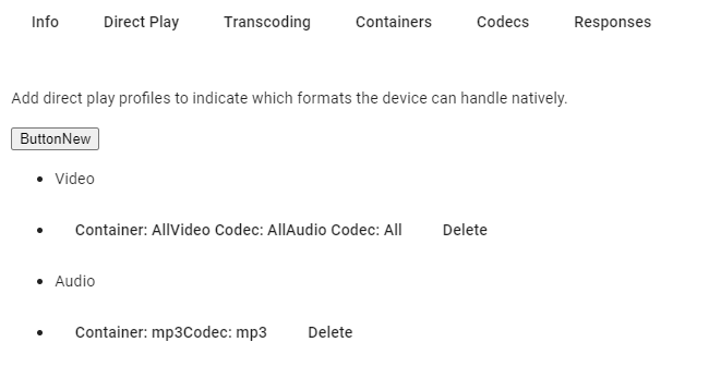

oneuser 0 Posted December 30, 2020 Posted December 30, 2020 (edited) Hello, I am trying to make Emby transcode ogg files (mp3 files play OK) to my Pioneer amplifier, but really cannot make it work. When I try to play ogg file, on the Pioneer only Connecting is displayed. Probably I have not configured profile correctly, but there is no documentation, and posts about the lack of it go back to 2015. I attach log. My profile settings are Container:mp3, Codec:mp3 for Direct Play and Container:ogg and Codec:ogg (tried also mp3) for Transcoding (all for Audio) excerpt.txt Edited December 31, 2020 by oneuser
oneuser 0 Posted December 31, 2020 Author Posted December 31, 2020 So I set DirectPlay to mp3/mp3 for Container/Codec and the same values for Transcoding - this should be OK. This is my only profile. Still, when I try to play ogg files with VLC, it shows that the stream is ogg (and the amplifier still doesn't play them, obviously)
oneuser 0 Posted December 31, 2020 Author Posted December 31, 2020 (edited) Hi, Below you can see my current setup. I try to play a file by operating in amplifier/VLC UI. MP3 files behave as expected. Attempt to play ogg via the amplifier results in the exchange starting with (then GET/200 sequence is repeated): 2020-12-30 22:56:09.387 Info Dlna: DLNA Session created for Pioneer VSX-S520 F03FC6 - VSX-S520 2020-12-30 22:56:14.160 Info Server: http/1.1 GET http://192.168.0.175:8096/audio/2237/stream.ogg?DeviceId=7d8097d9802f1303815704d46f7681f8&MediaSourceId=5dda6d659422d24a2ecb75843e1d583f&Static=true&PlaySessionId=6e4895136013533efa24e47daf92f6f4. UserAgent: GStreamer souphttpsrc libsoup/2.48.1 2020-12-30 22:56:15.910 Info Server: http/1.1 Response 200 to 192.168.0.125. Time: 1762ms. http://192.168.0.175:8096/audio/2237/stream.ogg?DeviceId=7d8097d9802f1303815704d46f7681f8&MediaSourceId=5dda6d659422d24a2ecb75843e1d583f&Static=true&PlaySessionId=6e4895136013533efa24e47daf92f6f4 Here is an mp3 that plays correctly on the amplifier: 2020-12-30 23:03:54.281 Info Server: http/1.1 GET http://192.168.0.175:8096/audio/830/stream.mp3?DeviceId=7d8097d9802f1303815704d46f7681f8&MediaSourceId=1e555f69aea58f549975a7da55395395&Static=true&PlaySessionId=348ac02c3718b4e61ffdd9aa919b412b. UserAgent: GStreamer souphttpsrc libsoup/2.48.1 2020-12-30 23:04:08.422 Info Server: http/1.1 Response 200 to 192.168.0.125. Time: 14142ms. http://192.168.0.175:8096/audio/830/stream.mp3?DeviceId=7d8097d9802f1303815704d46f7681f8&MediaSourceId=1e555f69aea58f549975a7da55395395&Static=true&PlaySessionId=348ac02c3718b4e61ffdd9aa919b412b I don't see any trace of selecting profile or (attempt of) transcoding information in emybserver.txt log (with DLNA debug logging enabled). Also added full log for interaction via VLC. I would expect ogg file played to be transcoded, but in VLC stream shows as ogg. embyserver (7).txt Edited December 31, 2020 by oneuser

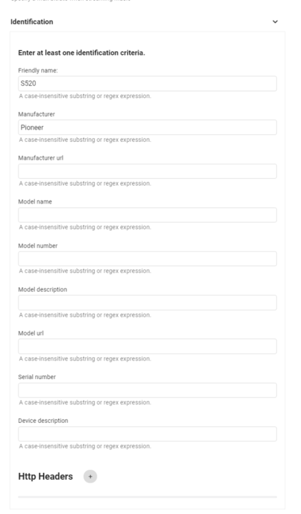

oneuser 0 Posted December 31, 2020 Author Posted December 31, 2020 (edited) I tried "Pioneer" for manufacturer and "Pioneer VSX-S520" for other items. How can I trace the profile matching process/get values to put there. I would think that empty identification matches all??? Edited December 31, 2020 by oneuser
Luke 42237 Posted December 31, 2020 Posted December 31, 2020 You can't force it. You have to put something there that will work. There's two methods of identification and both need to be filled out. You could try manufacturer Pioneer. and then for http headers user agent pioneer.
oneuser 0 Posted December 31, 2020 Author Posted December 31, 2020 Not working, see device descriptor below and profile identification settings. Is there anything wrong about it? <friendlyName>Pioneer VSX-S520 F03FC6</friendlyName> <manufacturer>Onkyo & Pioneer Corporation</manufacturer> <manufacturerURL>http://www.pioneer-audiovisual.eu</manufacturerURL> <modelName>VSX-S520</modelName> <modelNumber>Digital Media Client</modelNumber>
Luke 42237 Posted December 31, 2020 Posted December 31, 2020 You need to also add one http header. If you're playing from the device, that will use the http headers. If you're remote controlling from Emby, then that will go by the identification manufacturer/friendly name that you already filled out. That's what I meant by both detection methods. Also just pick one between friendly name and manufacturer. Adding two fields will just make it more specific and less likely to match.

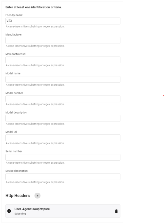

oneuser 0 Posted January 2, 2021 Author Posted January 2, 2021 Still no luck. I used Friendly name "VSX" because of: "Info Dlna: DLNA Session created for Pioneer VSX-S520 F03FC6 - VSX-S520" and "<friendlyName>Pioneer VSX-S520 F03FC6</friendlyName>" and header "souphttpsrc" because of: "Info Server: http/1.1 GET http://192.168.0.175:8096/audio/5545/stream.ogg?DeviceId=7d8097d9802f1303815704d46f7681f8&MediaSourceId=392c61d213f295613c361d5353bf51f0&Static=true&PlaySessionId=8ebd9c9fc96d2f80d38d1b8e6123f28a. UserAgent: GStreamer souphttpsrc libsoup/2.48.1"
