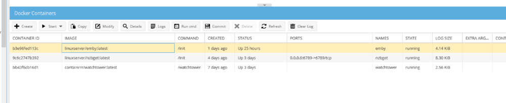

pascalheister 1 Posted December 31, 2020 Author Posted December 31, 2020 1 minute ago, MRobi said: If your latest log is Dec. 22nd, I'm putting my money on Emby isn't running. Start the docker container. Docker says it's running ?? see image

MRobi 161 Posted December 31, 2020 Posted December 31, 2020 12 minutes ago, pascalheister said: Docker says it's running ?? see image I'm still learning docker, and not familiar with OMV at all, so I may not be the best to help you yet. But I'm not seeing a port binded from the host to the container. See how NZBGet has port 6789? The linuxserver.io emby container needs -p 8096:8096. Could you possibly have missed this step?
pascalheister 1 Posted December 31, 2020 Author Posted December 31, 2020 (edited) 1 hour ago, MRobi said: I'm still learning docker, and not familiar with OMV at all, so I may not be the best to help you yet. But I'm not seeing a port binded from the host to the container. See how NZBGet has port 6789? The linuxserver.io emby container needs -p 8096:8096. Could you possibly have missed this step? It it always been on host (and worked perfect), not with a special port. Maby i will give it a try > to bad no effect Edited December 31, 2020 by pascalheister

Q-Droid 1011 Posted January 1, 2021 Posted January 1, 2021 While that wasn't my suggestion it is good to try different things. The container status above showed no port mappings which is why that was mentioned. What we've asked for is confirmation that the emby server is actually running. The server process itself, not the container. You have not posted current logs that include the server startup and runtime activity. The posted log was old, did not include server startup (rotated log) and appeared to have shutdown at the end. After you restart emby check to see if it's responding on the standard port from the host command line, upper case letter "O" below: wget -O- http://localhost:8096

MRobi 161 Posted January 3, 2021 Posted January 3, 2021 I'm the one asking about the ports. The linuxserver emby image maps ports in bridge mode. -p 8096:8096 \ -p 8920:8920 `#optional` \ From your screenshot, you don't have these ports mapped. So when you removed and re-installed did you miss this step or did you configure your network differently? If you missed this step, when you navigate to 192.168.X.XXX:8096 there's nothing that tells it to direct the request to that container which would make it inaccessible.
