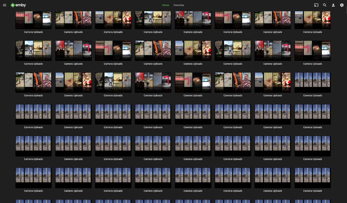

socalredneck 11 Posted December 30, 2020 Posted December 30, 2020 (edited) I just did the same thing. I noticed the phone that I've had for nearly a year hasn't be sync'g with emby. When it did sync last night, it uploaded 1000+ pics which is great, but it created 80+ "Camera Uploads" features on the home page. Several of the libraries have 85 pics in them, as if there is a max upload limit of 85 files that creates a new library each time a limit is hit. But some of the libraries are copies of each other. Any way to fix this???? Edited December 30, 2020 by socalredneck

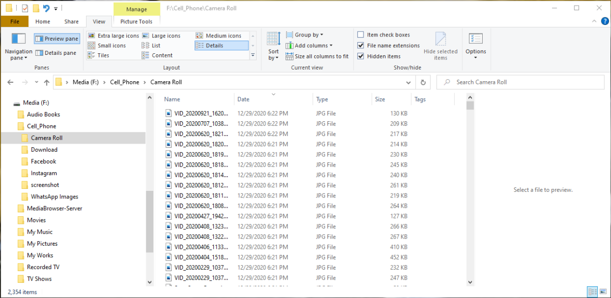

socalredneck 11 Posted December 30, 2020 Posted December 30, 2020 I have a dedicated drive for emby. I'm not sure if this is what you're asking for or not.

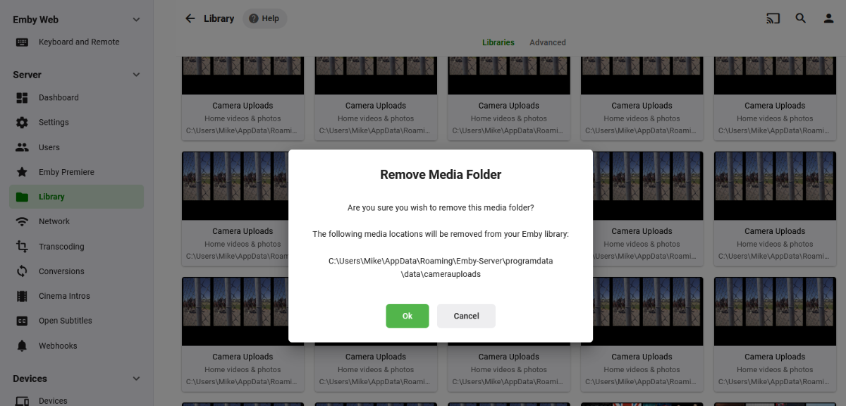

socalredneck 11 Posted December 30, 2020 Posted December 30, 2020 (edited) If I remove each Camera Upload library, but one, can I then "Scan Library Files" to fix it? Or if I Remove one, will it remove all of the Camera Upload libraries? Edited December 30, 2020 by socalredneck
Carlo 4561 Posted December 30, 2020 Posted December 30, 2020 What does C:\Users\Mike\AppData\Emby-Server\programdata\data\camerauploads folder look like on disc? Can you take a pic of that please?
