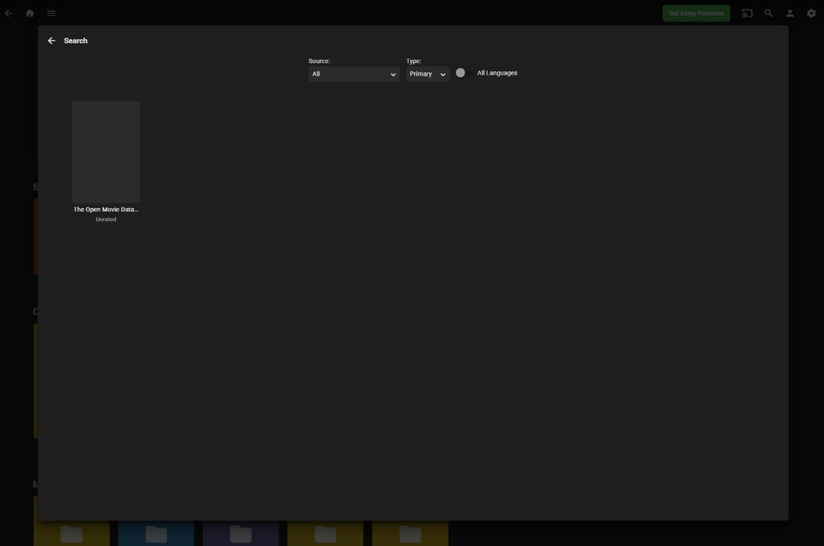

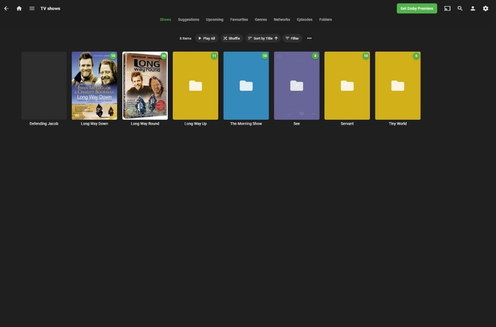

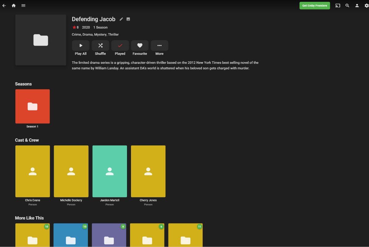

SDEW201997 0 Posted December 29, 2020 Posted December 29, 2020 I have been setting up my new Emby Server, unfortunately it fails to pull in images for show covers, season posters, thumbnails, actors, everything. Same for movies. (images below) I have the metadata set to scan TVDB, Open Movie Database, The Movie Database, put it isn't doing it. Does any one have any idea how to fix this? Much appreciated.

SDEW201997 0 Posted December 29, 2020 Author Posted December 29, 2020 10 minutes ago, vdatanet said: Did you follow the naming conventions? Media Preparation : Emby Does it work by identifying an item manually? Hi, Yes I have followed the proper naming convention, just double checked. In regards to identifying manually, the show is self identified by Emby already, in the second screenshot it shows that it knows what the show is and who's in it, it just cant pull any images. I have tried manually identifying it anyway and it makes no difference unfortunately. Thanks.
