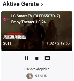

nanuk 36 Posted November 2, 2020 Posted November 2, 2020 Hi, since a few months Dolby Vision (single layer) is possible in mkv files. Since the new Version of Emby Server (4.5.2.0) the forced srt Subtitles are no longer shown when playing these mkv files. I restored to Emby Version 4.4.3.0 and here the forced srt subs are displayed correctly. It doesn't seem to be a general problem with srt forces subs as other 4k Remuxes (HDR only) are working correctly in Version 4.4.3.0 AND 4.5.2.0 And it seems to be a problem only for LG TVs (I own 3 of them and the behavior is the same on all 3 (different web os versions and models)) With my FireTV Stick the forced srt subs in Dolby Vision mkv files are playing without any problem. So... to make a long story short here's my summary: No forced srt subs shown on LG TV's when playing 4K UHDBD Remux-mkv files with dolby vision layer having Emby 4.5.2.0 installed I know this one is very specific Any Idea? Let me know if I can help with some more details
