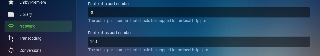

Carlo 4561 Posted December 28, 2020 Posted December 28, 2020 Keep in mind if using an SSL cert you need to access the Emby using the domain associated with the cert not by IP address. If you are trying to set this up to run under Cloudflare you can not use port 8920 as it's not a support port they recognize. Instead setup your firewall to forward port 443 on the WAN port to 8920 of your Emby Server IP address. Now use these settings in Emby: This should allow Cloudflare to work with your Emby setup. If you can't figure this out send me a PM and we can setup a TeamViewer session and I can help you get this setup and squared away. I use Cloudflare myself and have helped many a user with this setup.

Carlo 4561 Posted December 28, 2020 Posted December 28, 2020 Cloudflare won't use port 8920. You need to do what I mentioned above and switch things over to port 443 which it will use.
Carlo 4561 Posted December 28, 2020 Posted December 28, 2020 35 minutes ago, csimmons222 said: Cayars, When I go to https://media.mydomain.com:8920, I receive a "Service Unavailable. The server is temporarily unable to service your request due to maintenance downtime or capacity problems. Please try again later." error. Prior to me screwing this up, I could go to https://media.mydomain.com:8920. Cloudflare would redirect my request to https://<my public ip>:8920. My Sophos firewall would then handle the Let's Encrypt SSL Certificate for media.mydomain.com. I would then be able to log in to Emby over an encrypted connection. For testing purposes, I can do all of this over HTTP using http://media.mydomain.com:8096 and everything works great. It's just HTTPS that is giving me the problem. Assuming you are using Cloudflare you have them generate the CERT for you then you convert it and use that for Emby. Cloudflare and your Emby server need to both use the shared cert so they can talk back and forth if you want Cloudflare proxy and it's security. To get things working I'd turn off your local firewall software so it's not in the way or blocking you in any manner.
