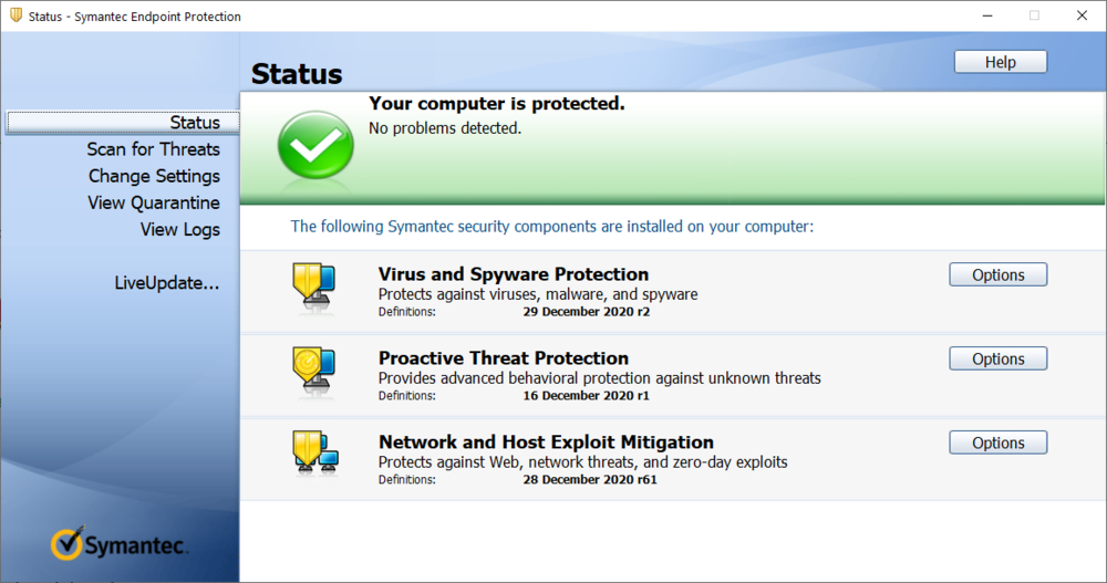

amatala 8 Posted December 29, 2020 Author Posted December 29, 2020 Just now, Luke said: What security software do you have on the machine? Something appears to be blocking the server from starting up. I am using Symantec Endpoint Protection and I have thought about that... stopping SEP didn't solve the problem at the time... and now SEP is up and running and Emby is running just fine today...

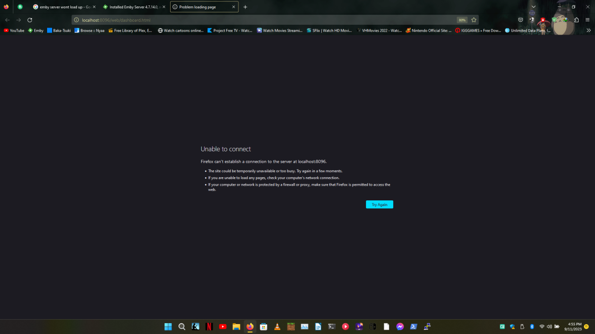

MarkE2794 1 Posted September 12, 2023 Posted September 12, 2023 (edited) Hi I Restarted my Computer and Went to Start up my server and i get this Edited September 12, 2023 by MarkE2794
MarkE2794 1 Posted September 12, 2023 Posted September 12, 2023 here is my log embyserver-63830048399.txt
Luke 42185 Posted September 12, 2023 Posted September 12, 2023 18 minutes ago, MarkE2794 said: here is my log embyserver-63830048399.txt 66.5 kB · 0 downloads @MarkE2794It looks like you went back and forth between beta and stable? That's not supported. I would suggest going back to the beta and then reporting whatever issue you had with it in the testing area of the community. To go back to 4.7 you'll need to do a fresh install.
MarkE2794 1 Posted September 12, 2023 Posted September 12, 2023 i reverted back to beta and it fixed it
