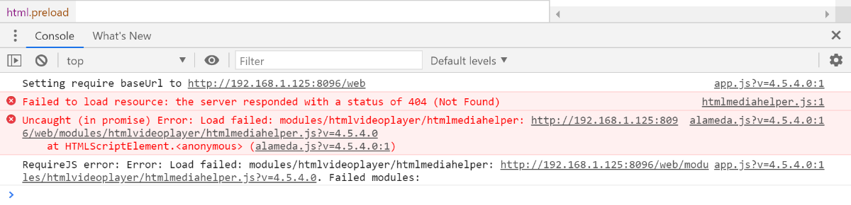

Milofow 3 Posted December 27, 2020 Posted December 27, 2020 (edited) Hi, Yesterday I updated my emby server running on freenas from 4.0.1.0 to 4.5.4.0. Since then if I try to reach the webapp it is just stuck on the emby logo, weirdly enough if I try to reach emby through an app it works fine. My browsers doesn't give any errors except for these: and he couldn't find this file, while it is there this is the server log around the time I try to reach the web app 2020-12-28 13:48:05.584 Error Server: Error processing request *** Error Report *** Version: 4.5.4.0 Command line: /usr/local/lib/emby-server/system/EmbyServer.exe -os freebsd -ffdetect /usr/local/lib/emby-server/bin/ffdetect -ffmpeg /usr/local/lib/emby-server/bin/ffmpeg -ffprobe /usr/local/lib/emby-server/bin/ffprobe -programdata /var/db/emby-server -updatepackage emby-server-freebsd11_{version}_amd64.txz Operating system: Unix 11.3.11.0 Framework: Mono: 5.10.1.57 (5.10.1.57 Tue Dec 15 14:49:13 UTC 2020) OS/Process: X64/X64 Runtime: usr/local/lib/mono/4.5/mscorlib.dll Processor count: 2 Data path: /var/db/emby-server Application path: /usr/local/lib/emby-server/system System.IO.DirectoryNotFoundException: System.IO.DirectoryNotFoundException: Could not find a part of the path "/usr/local/lib/emby-server/system/dashboard-ui/modules/htmlvideoplayer/htmlmediahelper.js". at System.IO.FileStream..ctor (System.String path, System.IO.FileMode mode, System.IO.FileAccess access, System.IO.FileShare share, System.Int32 bufferSize, System.Boolean anonymous, System.IO.FileOptions options) [0x00164] in <0e06830de9a44394a7e366951eabca52>:0 at System.IO.FileStream..ctor (System.String path, System.IO.FileMode mode, System.IO.FileAccess access, System.IO.FileShare share, System.Int32 bufferSize, System.IO.FileOptions options) [0x00000] in <0e06830de9a44394a7e366951eabca52>:0 at (wrapper remoting-invoke-with-check) System.IO.FileStream..ctor(string,System.IO.FileMode,System.IO.FileAccess,System.IO.FileShare,int,System.IO.FileOptions) at Emby.Server.Implementations.IO.ManagedFileSystem.GetFileStream (System.String path, MediaBrowser.Model.IO.FileOpenMode mode, MediaBrowser.Model.IO.FileAccessMode access, MediaBrowser.Model.IO.FileShareMode share, System.Int32 bufferSize, MediaBrowser.Model.IO.FileOpenOptions fileOpenOptions) [0x00052] in <690051a8047b487181d736f4befb907e>:0 at Emby.Server.Implementations.IO.ManagedFileSystem.GetFileStream (System.String path, MediaBrowser.Model.IO.FileOpenMode mode, MediaBrowser.Model.IO.FileAccessMode access, MediaBrowser.Model.IO.FileShareMode share, MediaBrowser.Model.IO.FileOpenOptions fileOpenOptions) [0x00000] in <690051a8047b487181d736f4befb907e>:0 at Emby.Server.Implementations.IO.IOManager.GetResponse (MediaBrowser.Common.Net.HttpRequestOptions options, MediaBrowser.Model.MediaInfo.MediaProtocol protocol) [0x00033] in <690051a8047b487181d736f4befb907e>:0 at Emby.Server.Implementations.IO.IOManager.GetResponse (MediaBrowser.Common.Net.HttpRequestOptions options) [0x00013] in <690051a8047b487181d736f4befb907e>:0 at Emby.Server.Implementations.HttpServer.HttpResultFactory+<GetContent>d__29.MoveNext () [0x00115] in <690051a8047b487181d736f4befb907e>:0 --- End of stack trace from previous location where exception was thrown --- at System.Runtime.ExceptionServices.ExceptionDispatchInfo.Throw () [0x0000c] in <0e06830de9a44394a7e366951eabca52>:0 at System.Runtime.CompilerServices.TaskAwaiter.ThrowForNonSuccess (System.Threading.Tasks.Task task) [0x0003e] in <0e06830de9a44394a7e366951eabca52>:0 at System.Runtime.CompilerServices.TaskAwaiter.HandleNonSuccessAndDebuggerNotification (System.Threading.Tasks.Task task) [0x00028] in <0e06830de9a44394a7e366951eabca52>:0 at System.Runtime.CompilerServices.TaskAwaiter.ValidateEnd (System.Threading.Tasks.Task task) [0x00008] in <0e06830de9a44394a7e366951eabca52>:0 at System.Runtime.CompilerServices.ConfiguredTaskAwaitable`1+ConfiguredTaskAwaiter[TResult].GetResult () [0x00000] in <0e06830de9a44394a7e366951eabca52>:0 at Emby.Server.Implementations.HttpServer.FileWriter+<SetContentResponseHeaders>d__38.MoveNext () [0x0012e] in <690051a8047b487181d736f4befb907e>:0 --- End of stack trace from previous location where exception was thrown --- at System.Runtime.ExceptionServices.ExceptionDispatchInfo.Throw () [0x0000c] in <0e06830de9a44394a7e366951eabca52>:0 at System.Runtime.CompilerServices.TaskAwaiter.ThrowForNonSuccess (System.Threading.Tasks.Task task) [0x0003e] in <0e06830de9a44394a7e366951eabca52>:0 at System.Runtime.CompilerServices.TaskAwaiter.HandleNonSuccessAndDebuggerNotification (System.Threading.Tasks.Task task) [0x00028] in <0e06830de9a44394a7e366951eabca52>:0 at System.Runtime.CompilerServices.TaskAwaiter.ValidateEnd (System.Threading.Tasks.Task task) [0x00008] in <0e06830de9a44394a7e366951eabca52>:0 at System.Runtime.CompilerServices.ConfiguredTaskAwaitable+ConfiguredTaskAwaiter.GetResult () [0x00000] in <0e06830de9a44394a7e366951eabca52>:0 at Emby.Server.Implementations.HttpServer.HttpResultFactory+<GetStaticResult>d__31.MoveNext () [0x0030c] in <690051a8047b487181d736f4befb907e>:0 --- End of stack trace from previous location where exception was thrown --- at System.Runtime.ExceptionServices.ExceptionDispatchInfo.Throw () [0x0000c] in <0e06830de9a44394a7e366951eabca52>:0 at System.Runtime.CompilerServices.TaskAwaiter.ThrowForNonSuccess (System.Threading.Tasks.Task task) [0x0003e] in <0e06830de9a44394a7e366951eabca52>:0 at System.Runtime.CompilerServices.TaskAwaiter.HandleNonSuccessAndDebuggerNotification (System.Threading.Tasks.Task task) [0x00028] in <0e06830de9a44394a7e366951eabca52>:0 at System.Runtime.CompilerServices.TaskAwaiter.ValidateEnd (System.Threading.Tasks.Task task) [0x00008] in <0e06830de9a44394a7e366951eabca52>:0 at System.Runtime.CompilerServices.ConfiguredTaskAwaitable`1+ConfiguredTaskAwaiter[TResult].GetResult () [0x00000] in <0e06830de9a44394a7e366951eabca52>:0 at Emby.Web.Api.DashboardService+<Get>d__22.MoveNext () [0x00416] in <2e8f209c3c124da0a911a687e1f336f1>:0 --- End of stack trace from previous location where exception was thrown --- at System.Runtime.ExceptionServices.ExceptionDispatchInfo.Throw () [0x0000c] in <0e06830de9a44394a7e366951eabca52>:0 at System.Runtime.CompilerServices.TaskAwaiter.ThrowForNonSuccess (System.Threading.Tasks.Task task) [0x0003e] in <0e06830de9a44394a7e366951eabca52>:0 at System.Runtime.CompilerServices.TaskAwaiter.HandleNonSuccessAndDebuggerNotification (System.Threading.Tasks.Task task) [0x00028] in <0e06830de9a44394a7e366951eabca52>:0 at System.Runtime.CompilerServices.TaskAwaiter.ValidateEnd (System.Threading.Tasks.Task task) [0x00008] in <0e06830de9a44394a7e366951eabca52>:0 at System.Runtime.CompilerServices.ConfiguredTaskAwaitable`1+ConfiguredTaskAwaiter[TResult].GetResult () [0x00000] in <0e06830de9a44394a7e366951eabca52>:0 at Emby.Server.Implementations.Services.ServiceController+<GetTaskResult>d__12.MoveNext () [0x00081] in <690051a8047b487181d736f4befb907e>:0 --- End of stack trace from previous location where exception was thrown --- at System.Runtime.ExceptionServices.ExceptionDispatchInfo.Throw () [0x0000c] in <0e06830de9a44394a7e366951eabca52>:0 at System.Runtime.CompilerServices.TaskAwaiter.ThrowForNonSuccess (System.Threading.Tasks.Task task) [0x0003e] in <0e06830de9a44394a7e366951eabca52>:0 at System.Runtime.CompilerServices.TaskAwaiter.HandleNonSuccessAndDebuggerNotification (System.Threading.Tasks.Task task) [0x00028] in <0e06830de9a44394a7e366951eabca52>:0 at System.Runtime.CompilerServices.TaskAwaiter.ValidateEnd (System.Threading.Tasks.Task task) [0x00008] in <0e06830de9a44394a7e366951eabca52>:0 at System.Runtime.CompilerServices.ConfiguredTaskAwaitable`1+ConfiguredTaskAwaiter[TResult].GetResult () [0x00000] in <0e06830de9a44394a7e366951eabca52>:0 at Emby.Server.Implementations.Services.ServiceHandler+<ProcessRequestAsync>d__4.MoveNext () [0x001da] in <690051a8047b487181d736f4befb907e>:0 --- End of stack trace from previous location where exception was thrown --- at System.Runtime.ExceptionServices.ExceptionDispatchInfo.Throw () [0x0000c] in <0e06830de9a44394a7e366951eabca52>:0 at System.Runtime.CompilerServices.TaskAwaiter.ThrowForNonSuccess (System.Threading.Tasks.Task task) [0x0003e] in <0e06830de9a44394a7e366951eabca52>:0 at System.Runtime.CompilerServices.TaskAwaiter.HandleNonSuccessAndDebuggerNotification (System.Threading.Tasks.Task task) [0x00028] in <0e06830de9a44394a7e366951eabca52>:0 at System.Runtime.CompilerServices.TaskAwaiter.ValidateEnd (System.Threading.Tasks.Task task) [0x00008] in <0e06830de9a44394a7e366951eabca52>:0 at System.Runtime.CompilerServices.ConfiguredTaskAwaitable+ConfiguredTaskAwaiter.GetResult () [0x00000] in <0e06830de9a44394a7e366951eabca52>:0 at Emby.Server.Implementations.HttpServer.HttpListenerHost+<RequestHandler>d__45.MoveNext () [0x00bcc] in <690051a8047b487181d736f4befb907e>:0 Source: mscorlib TargetSite: Void Throw() 2020-12-28 13:48:05.589 Info Server: http/1.1 GET http://192.168.1.125:8096/web/favicon.ico. UserAgent: Mozilla/5.0 (Windows NT 10.0; Win64; x64) AppleWebKit/537.36 (KHTML, like Gecko) Chrome/87.0.4280.88 Safari/537.36 2020-12-28 13:48:05.591 Info Server: http/1.1 Response 200 to 192.168.1.100. Time: 2ms. http://192.168.1.125:8096/web/favicon.ico 2020-12-28 13:48:10.210 Info Server: http/1.1 GET http://192.168.1.125:8096/emby/Users/a4fdfbdbea2b491aae69fc6044710852?X-Emby-Client=Emby Theater&X-Emby-Device-Name=DESKTOP-GGH4DLL&X-Emby-Device-Id=DESKTOP-GGH4DLL&X-Emby-Client-Version=3.0.13. UserAgent: Mozilla/5.0 (Windows NT 10.0; Win64; x64) AppleWebKit/537.36 (KHTML, like Gecko) EmbyTheater/3.0.13 Chrome/85.0.4183.121 Electron/10.2.0 Safari/537.36 2020-12-28 13:48:10.228 Info Server: http/1.1 Response 200 to 192.168.1.100. Time: 19ms. http://192.168.1.125:8096/emby/Users/a4fdfbdbea2b491aae69fc6044710852?X-Emby-Client=Emby Theater&X-Emby-Device-Name=DESKTOP-GGH4DLL&X-Emby-Device-Id=DESKTOP-GGH4DLL&X-Emby-Client-Version=3.0.13 2020-12-28 13:48:10.235 Info Server: http/1.1 GET http://192.168.1.125:8096/emby/System/Configuration?X-Emby-Client=Emby Theater&X-Emby-Device-Name=DESKTOP-GGH4DLL&X-Emby-Device-Id=DESKTOP-GGH4DLL&X-Emby-Client-Version=3.0.13. UserAgent: Mozilla/5.0 (Windows NT 10.0; Win64; x64) AppleWebKit/537.36 (KHTML, like Gecko) EmbyTheater/3.0.13 Chrome/85.0.4183.121 Electron/10.2.0 Safari/537.36 2020-12-28 13:48:10.272 Info Server: http/1.1 Response 200 to 192.168.1.100. Time: 38ms. http://192.168.1.125:8096/emby/System/Configuration?X-Emby-Client=Emby Theater&X-Emby-Device-Name=DESKTOP-GGH4DLL&X-Emby-Device-Id=DESKTOP-GGH4DLL&X-Emby-Client-Version=3.0.13 2020-12-28 13:48:10.635 Info Server: http/1.1 GET http://192.168.1.125:8096/emby/System/Logs?SortBy=IsFolder,SortName&SortOrder=Ascending&Fields=BasicSyncInfo,CanDelete&ImageTypeLimit=1&EnableImageTypes=Primary,Backdrop,Thumb&StartIndex=0&Limit=50&X-Emby-Client=Emby Theater&X-Emby-Device-Name=DESKTOP-GGH4DLL&X-Emby-Device-Id=DESKTOP-GGH4DLL&X-Emby-Client-Version=3.0.13. UserAgent: Mozilla/5.0 (Windows NT 10.0; Win64; x64) AppleWebKit/537.36 (KHTML, like Gecko) EmbyTheater/3.0.13 Chrome/85.0.4183.121 Electron/10.2.0 Safari/537.36 2020-12-28 13:48:10.690 Info Server: http/1.1 Response 200 to 192.168.1.100. Time: 55ms. http://192.168.1.125:8096/emby/System/Logs?SortBy=IsFolder,SortName&SortOrder=Ascending&Fields=BasicSyncInfo,CanDelete&ImageTypeLimit=1&EnableImageTypes=Primary,Backdrop,Thumb&StartIndex=0&Limit=50&X-Emby-Client=Emby Theater&X-Emby-Device-Name=DESKTOP-GGH4DLL&X-Emby-Device-Id=DESKTOP-GGH4DLL&X-Emby-Client-Version=3.0.13 2020-12-28 13:48:12.628 Info Server: http/1.1 GET http://192.168.1.125:8096/emby/System/Logs/embyserver.txt/Lines?SortBy=IsFolder,SortName&SortOrder=Ascending&Fields=BasicSyncInfo,CanDelete,ProductionYear,Status,EndDate&ImageTypeLimit=1&EnableImageTypes=Primary,Backdrop,Thumb&StartIndex=0&Limit=100&X-Emby-Client=Emby Theater&X-Emby-Device-Name=DESKTOP-GGH4DLL&X-Emby-Device-Id=DESKTOP-GGH4DLL&X-Emby-Client-Version=3.0.13. UserAgent: Mozilla/5.0 (Windows NT 10.0; Win64; x64) AppleWebKit/537.36 (KHTML, like Gecko) EmbyTheater/3.0.13 Chrome/85.0.4183.121 Electron/10.2.0 Safari/537.36 2020-12-28 13:48:12.664 Info Server: http/1.1 Response 200 to 192.168.1.100. Time: 36ms. http://192.168.1.125:8096/emby/System/Logs/embyserver.txt/Lines?SortBy=IsFolder,SortName&SortOrder=Ascending&Fields=BasicSyncInfo,CanDelete,ProductionYear,Status,EndDate&ImageTypeLimit=1&EnableImageTypes=Primary,Backdrop,Thumb&StartIndex=0&Limit=100&X-Emby-Client=Emby Theater&X-Emby-Device-Name=DESKTOP-GGH4DLL&X-Emby-Device-Id=DESKTOP-GGH4DLL&X-Emby-Client-Version=3.0.13 2020-12-28 13:48:14.595 Info Server: http/1.1 GET http://192.168.1.125:8096/emby/System/Logs/embyserver.txt/Lines?SortBy=IsFolder,SortName&SortOrder=Ascending&Fields=BasicSyncInfo,CanDelete,ProductionYear,Status,EndDate&ImageTypeLimit=1&EnableImageTypes=Primary,Backdrop,Thumb&StartIndex=100&Limit=100&EnableTotalRecordCount=false&X-Emby-Client=Emby Theater&X-Emby-Device-Name=DESKTOP-GGH4DLL&X-Emby-Device-Id=DESKTOP-GGH4DLL&X-Emby-Client-Version=3.0.13. UserAgent: Mozilla/5.0 (Windows NT 10.0; Win64; x64) AppleWebKit/537.36 (KHTML, like Gecko) EmbyTheater/3.0.13 Chrome/85.0.4183.121 Electron/10.2.0 Safari/537.36 2020-12-28 13:48:14.603 Info Server: http/1.1 Response 200 to 192.168.1.100. Time: 8ms. http://192.168.1.125:8096/emby/System/Logs/embyserver.txt/Lines?SortBy=IsFolder,SortName&SortOrder=Ascending&Fields=BasicSyncInfo,CanDelete,ProductionYear,Status,EndDate&ImageTypeLimit=1&EnableImageTypes=Primary,Backdrop,Thumb&StartIndex=100&Limit=100&EnableTotalRecordCount=false&X-Emby-Client=Emby Theater&X-Emby-Device-Name=DESKTOP-GGH4DLL&X-Emby-Device-Id=DESKTOP-GGH4DLL&X-Emby-Client-Version=3.0.13 2020-12-28 13:48:19.650 Info Server: http/1.1 GET http://192.168.1.125:8096/emby/System/Logs/embyserver.txt. UserAgent: Mozilla/5.0 (Windows NT 10.0; Win64; x64) AppleWebKit/537.36 (KHTML, like Gecko) EmbyTheater/3.0.13 Chrome/85.0.4183.121 Electron/10.2.0 Safari/537.36 Edited December 28, 2020 by Milofow more info

Milofow 3 Posted December 28, 2020 Author Posted December 28, 2020 18 hours ago, Luke said: Hi there, please attach the information requested in how to report a problem. thanks ! Hope this makes things a little bit clearer

Luke 42241 Posted December 31, 2020 Posted December 31, 2020 Hi, are you still running into this? Can you try clearing browsing data in the browser and see if that helps? Also, does this file exist on your server? /usr/local/lib/emby-server/system/dashboard-ui/modules/htmlvideoplayer/htmlmediahelper.js
Milofow 3 Posted December 31, 2020 Author Posted December 31, 2020 7 hours ago, Luke said: Hi, are you still running into this? Can you try clearing browsing data in the browser and see if that helps? Also, does this file exist on your server? /usr/local/lib/emby-server/system/dashboard-ui/modules/htmlvideoplayer/htmlmediahelper.js Unfortunately it still doesn’t work, I tried clearing the browser data but that didn’t do it. The file also exists on my server
