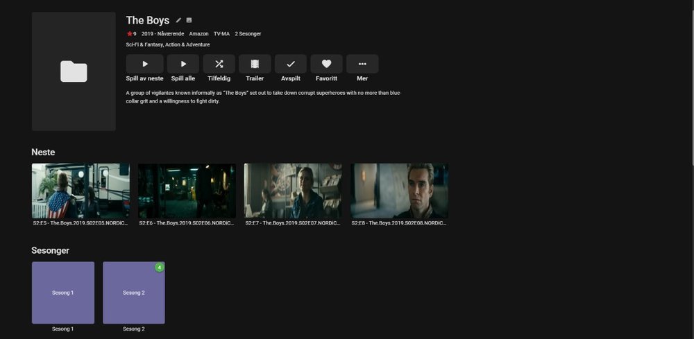

kimare 0 Posted December 27, 2020 Posted December 27, 2020 (edited) For some reason the server no longer import metadata. No longer covers and proper episode name are displayed. The Emby setting have been unchanged. I don't know if this has happened after an update or if there is any other reason. I've tried to refresh several times, but no luck. No message, it's just nothing happening. Last time also the cover images of several shows disappeared. The show is linked with the correct shows at the different db's. Edited December 27, 2020 by kimare

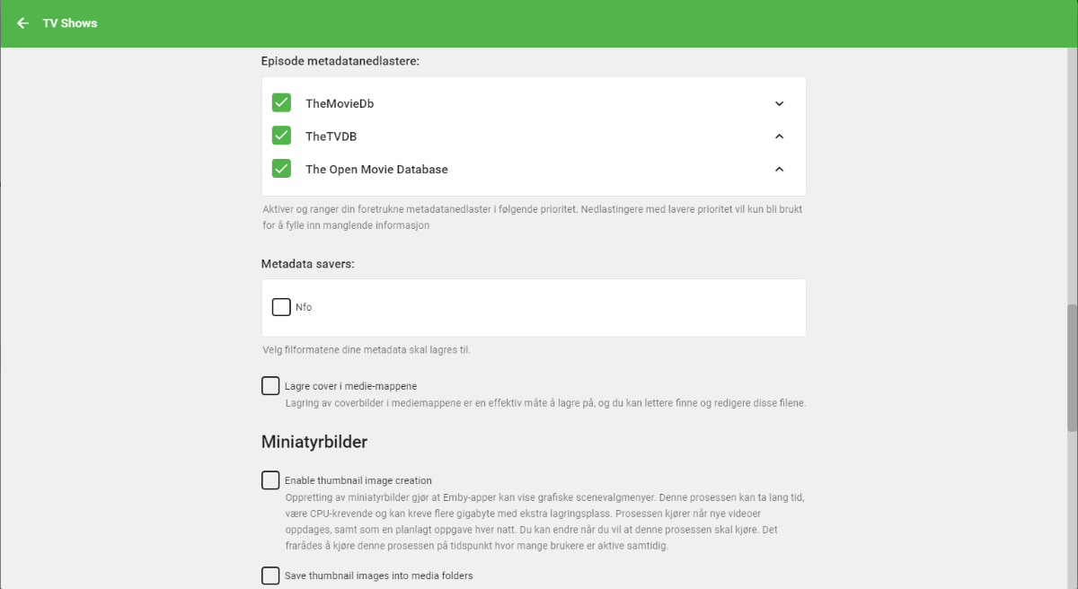

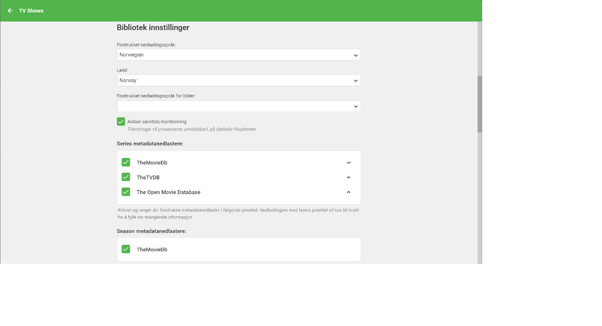

Luke 43434 Posted December 27, 2020 Posted December 27, 2020 Hi there, what metadata providers are enabled on the library, and in what order? How are the files named and organized?
kimare 0 Posted December 27, 2020 Author Posted December 27, 2020 (edited) 39 minutes ago, Luke said: Hi there, what metadata providers are enabled on the library, and in what order? How are the files named and organized? Files are organized like this: F:\\Shows\Category\Show\Show S01\Show S01E01.mkv After I encountered the problems I've tried several setting for metadata providers. Currently I have these. Edited December 27, 2020 by kimare

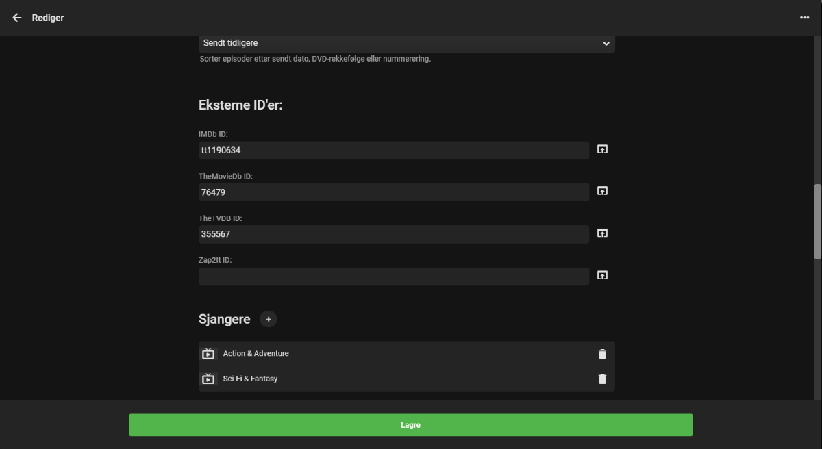

Happy2Play 9840 Posted December 27, 2020 Posted December 27, 2020 Looking at the first post it would appear the Series is partially identified but the episodes are not identified as the episode titles are not right. What externalid appear for this example?
ebr 16947 Posted December 27, 2020 Posted December 27, 2020 13 hours ago, kimare said: F:\\Shows\Category\Show\Show S01\Show S01E01.mkv Is that a supported Season folder name?
kimare 0 Posted December 28, 2020 Author Posted December 28, 2020 (edited) I've looked over when was the last time Emby collected the correct metadata. It looks like it this was at the end of may 2020. The first time where I'm certain correct metadata isn't loaded is probably at the end of june or beginning of july. 22 hours ago, Luke said: Ok, please try refreshing the metadata for a series, then attach the emby server log so that we can see what's going on. thanks. Refreshed the same show as in the first post. Also added another season of an existing show and a totally new show. Latest server log attached. 22 hours ago, Happy2Play said: Looking at the first post it would appear the Series is partially identified but the episodes are not identified as the episode titles are not right. What externalid appear for this example? That's because season 1 was added before Emby refused to add metadata The external-ids are correct. 11 hours ago, ebr said: Is that a supported Season folder name? I don't know. But for sure it wasn't a problem before june 2020. The filestructure have been unchanged. Edited December 28, 2020 by kimare
