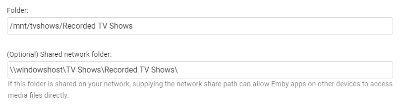

Jonathon 5 Posted December 26, 2020 Author Posted December 26, 2020 I used the mount location under "Folder" and entered the unc path in "Shared Network Folder": We played movies all day yesterday with minimal issues. The problem seems to when playing large files, the Windows share seems to become unresponsive. After the 180 seconds is over, the video starts playing again. I definitely don't think this is an Emby issue, so I am looking for a best practice suggestion. Emby server is more responsive when running on the Linux VM instead of running directly on the Windows host, that's why I am running in this configuration. Thanks! Jon
