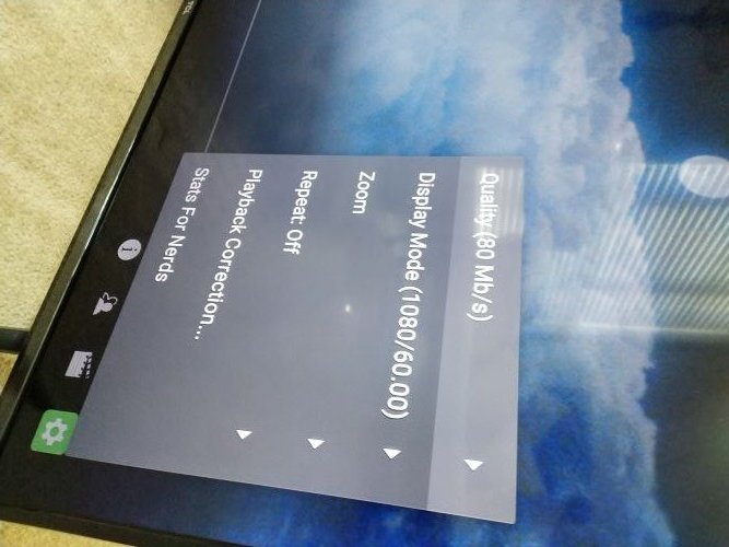

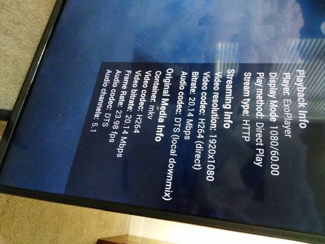

roaku 842 Posted December 23, 2020 Posted December 23, 2020 (edited) Android TV client: 1.8.54g / Server: 4.5.4 Content is Direct Played. I just picked up a budget friendly TCL 4 Series with Android TV. This is my first/only Android TV and experience with the Emby client for this platform. I'm seeing what looks like judder with all H264 content played through Emby, both 1080p and 480p. I have one 1080p movie ripped from the same source to both H264 and HEVC...the HEVC version plays back perfectly. Is there a setting somewhere I can adjust to fix this? I've already found and checked Enable Refresh Rate Switching and Match Video Resolution, but neither had any observable effect. Edit: Sorry the forum is rotating the images... Edited December 23, 2020 by roaku
ebr 16338 Posted December 23, 2020 Posted December 23, 2020 The source frame rate is 23.98 but the display is in 60 and your "budget" TV probably doesn't do a super job of reconciling that. It also probably doesn't support frame rate switching. Does it have a 23.98 mode you can manually switch to?

roaku 842 Posted December 23, 2020 Author Posted December 23, 2020 (edited) Just to update, I plugged my older Roku Express into this TV and playback and picture are great, and the TV is displaying the Roku output at 1080p/60hz. Also, my HEVC file, which plays back normally on the Emby Android TV client, has the same 23.976 frame rate as my H264 files which judder. So, it does seem to be something specific about the Emby Android TV client and how it handles my H264 files. Edited December 23, 2020 by roaku
