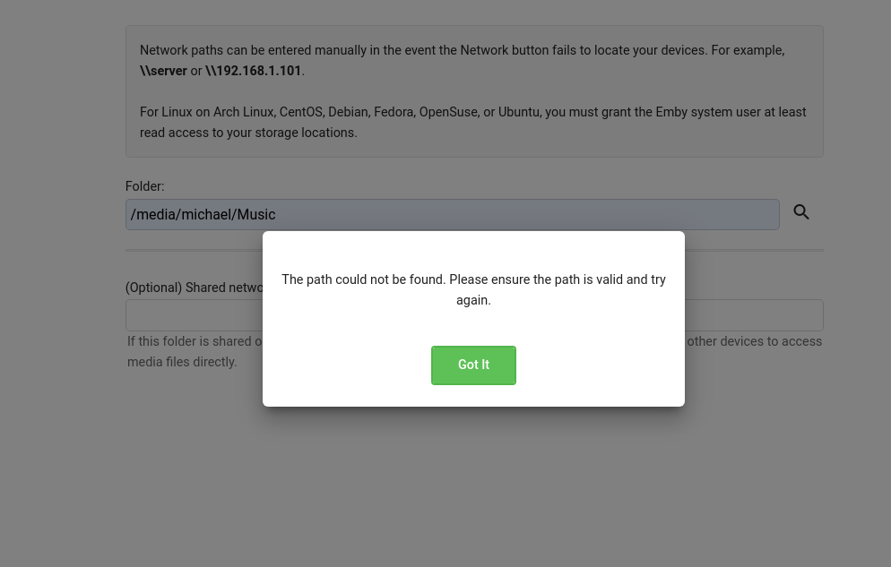

Michael1952 1 Posted December 22, 2020 Posted December 22, 2020 Ok, I am fairly new to Ubuntu, but i have a basic knowledge of file structure and paths. My problem is that when I try to set up my library and indicate the path in the appropriate place it is rejected and I am shown an error message: I have tried any number of combinations of path but I am sure I am using the correct one. It is: ~/media/michael/Music/ . Caps and syntax are correct. Here's a screen shot of the disk location: Oh, I also checked the permissions for the folders and they all have read/write/and edit permissions. I am at a loss for anything else to try. If some kind sole would point me in the proper direction I would be grateful. Thanks in advance. M1952

mark-in-dallas 87 Posted December 24, 2020 Posted December 24, 2020 Did your enter your password after entering the command: sudo usermod -a -G michael emby? What happened after doing so?
Michael1952 1 Posted December 24, 2020 Author Posted December 24, 2020 Hi Mark yes i did enter the password and it gave me an error message. Can't remember now what the message was now tho.

Michael1952 1 Posted December 24, 2020 Author Posted December 24, 2020 Mark i looked back on the thread we were on on the 17th and when i put in my password nothing happened it just went to a prompt.
mark-in-dallas 87 Posted December 24, 2020 Posted December 24, 2020 Okay, what might be easier than instructing you on installing OpenSSH would be to just have you download Team Viewer open the one time use option and PM me the ID and Password, and that way you can see what I'm doing.
mark-in-dallas 87 Posted December 24, 2020 Posted December 24, 2020 7 minutes ago, Michael1952 said: Mark i looked back on the thread we were on on the 17th and when i put in my password nothing happened it just went to a prompt. What was in front of the $ after you typed in your password? Was it michael or root?

mark-in-dallas 87 Posted December 24, 2020 Posted December 24, 2020 (edited) Just got off the phone with Michael and we were able to resolve the issue. The problems were due to: 1. ACL permissions set for media directory. 2. michael directory ownership set to root root. 3. michael directory permissions not set correctly. To resolve, we removed ACL permissions, changed michael directory ownership to michael michael and added michael to the emby group, and set read/write/execute permissions to michael directory. Edited December 25, 2020 by mark-in-dallas
