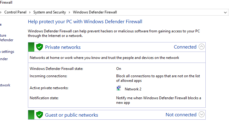

glennsfield 1 Posted January 5, 2021 Author Posted January 5, 2021 Problem solved - for some reason my network adapter swapped from being connected to a "Private" connection to "Guest or public" . As soon as I switched it back to a "Private" Connection, playback started working again. It would be nice of Emby Theatre was able to alert the user of the port block and even make the appropriate firewall rule change.
Carlo 4561 Posted January 5, 2021 Posted January 5, 2021 What was strange about this is that Web worked locally for playback but not Theater. I could also access and use his server including playback from Theater on my side all through port 8096, but his Theater could not playback from my system yet could show all media. @glennsfield You can safely remove the Carlo user from your system now.
