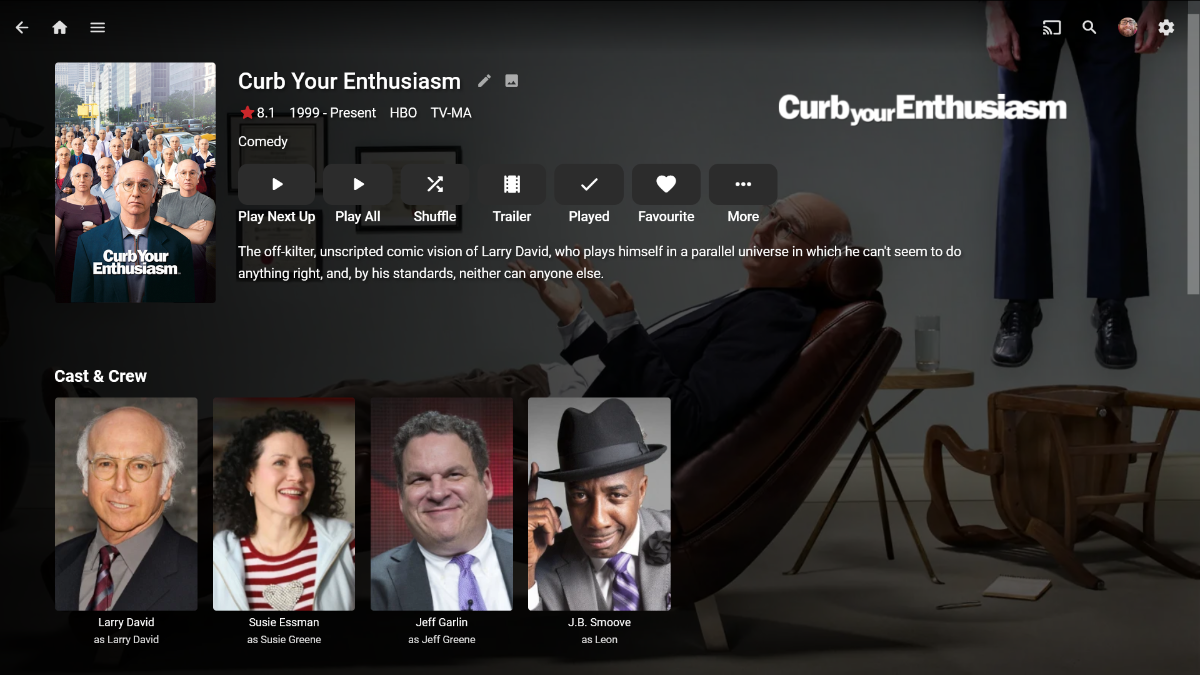

HandsGroober 0 Posted December 20, 2020 Posted December 20, 2020 Hi all Ive had a little issue with my Emby setup and I need help. I've moved from a Nvidia Shield to a new Synology DS220+ by creating a server backup and and moving my libraries. I also moved my metadata folder. It was all working fine until a couple of days ago when I noticed my metadata had been replaced and my tv seasons were missing from from the menu (Ive attached a picture). The episodes are all still there it seems only to be the tv seasons. So I thought I'll delete my metadata folder and start again. Still no tv seasons in the menu. I dont think I made any changes that would have caused this other than update the emby server. I tried searching the forum for a solution to this but I was not able to find any guidance. If someone could help i would be greatful. This is my first post here. 10/10 for the guys at Emby. I love it Thanks

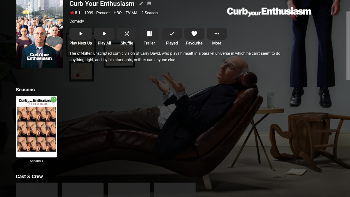

Solution Gilgamesh_48 1243 Posted December 20, 2020 Solution Posted December 20, 2020 6 minutes ago, HandsGroober said: Curb Your Enthusiasm / Curb Your Enthusiasm S01 / Curb Your Enthusiasm S01E01 First I would correct that naming to: Curb Your Enthusiasm / Season 01 / Curb Your Enthusiasm - S01E01 It is best to conform to correct naming 100% 1
HandsGroober 0 Posted December 20, 2020 Author Posted December 20, 2020 5 minutes ago, Luke said: Have you created any other Emby libraries besides TV shows? I did. I created two other movie libraries that I have yet to populate with movies. This problem would have occured around the same time. 3 minutes ago, Gilgamesh_48 said: First I would correct that naming to: Curb Your Enthusiasm / Season 01 / Curb Your Enthusiasm - S01E01 It is best to conform to correct naming 100% Yeah I know about this. I need to make time to go through and fix my labeling. I was happy it was working before so I didnt change it but ill try that now. Thanks

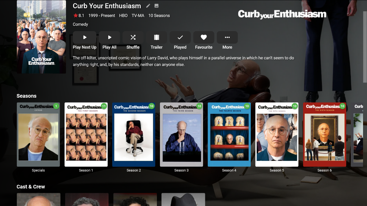

HandsGroober 0 Posted December 20, 2020 Author Posted December 20, 2020 Thanks Gilgamesh_48 and Luke. I renamed Curb season 01 to the correct naming format and it worked! I also deleted the new libraries I created recently. Is there any automated way to rename my tv shows correctly other than editing every file individually? Otherwise this is going to be a really tedious task. Also, I was ignorant of file naming before but I never had a problem. I wonder why this happened now. Was it the creation of the two new movie libraries?
