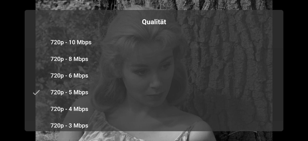

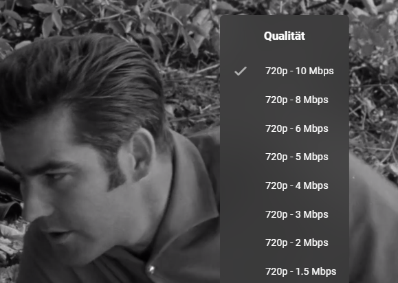

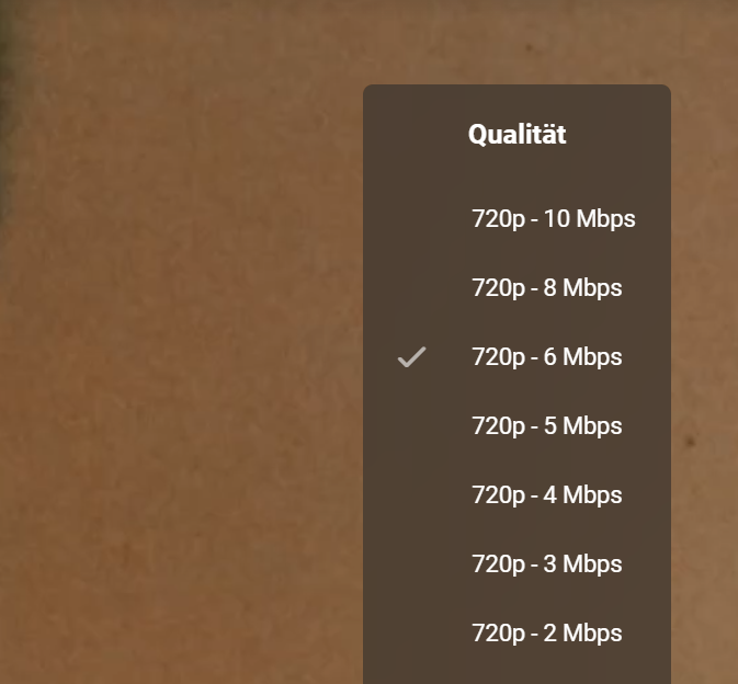

mholin 23 Posted December 20, 2020 Posted December 20, 2020 Hi guys today I would like to report this issue, what I was facing quiete a long time now. I found, that movies in my collection, with are encoded as 1080p would be listed as 720p type on the client, when I try to adjust playback-bitrate. I give you two examples: "Angry Silence" encoded 1800x1080. Playback bit rate can only be changed with 720 value. Both on Browser and Android app. "Murder by Contract" encoded 1408x1080. same it looks like, playback values are not set by vertical value 1080 but by horizontal 1800 or 1408, which is lower than 1920. can this be checked and corrected? It affects almost every 4:3 movies. bye Michael

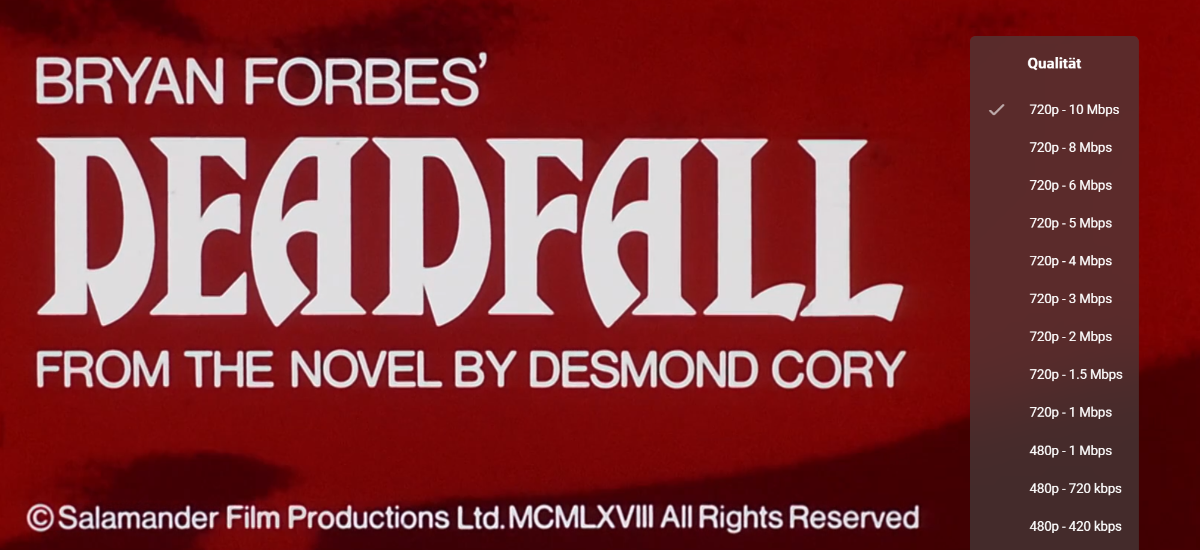

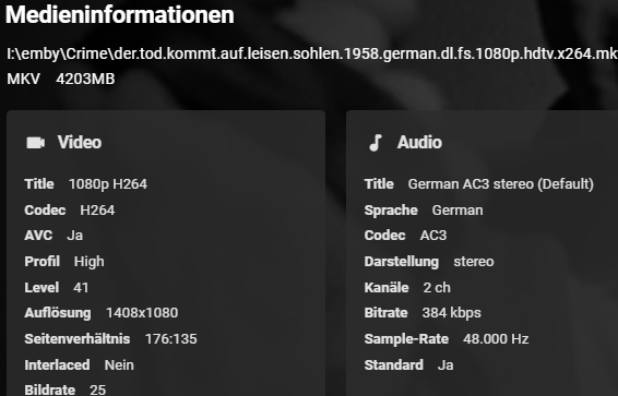

mholin 23 Posted December 29, 2020 Author Posted December 29, 2020 (edited) I do not believe this is an issue of bitrate. Here is my version of 1968 'Deadfall" All my movies with horizontal pixel between I guess 1280 - 1800 are tagged as 720p movie during playback. This really does affect all my 4:3 and 5:3 movies. Nobody else with this issue here? strange Edited December 29, 2020 by mholin

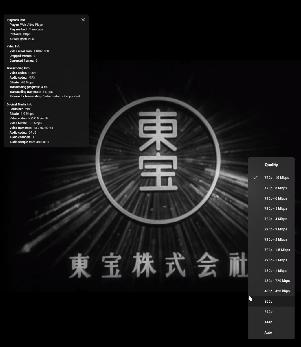

pwhodges 2028 Posted December 29, 2020 Posted December 29, 2020 (edited) I can confirm that when playing a 4:3 movie at 1080 resolution, the quality selection options all say 720. However, when I selected one the stats for nerds still showed the displayed video as being 1480x1080 (in my case). So I suspect it's just a display oddity which doesn't affect the actual processing. Paul Edited December 29, 2020 by pwhodges

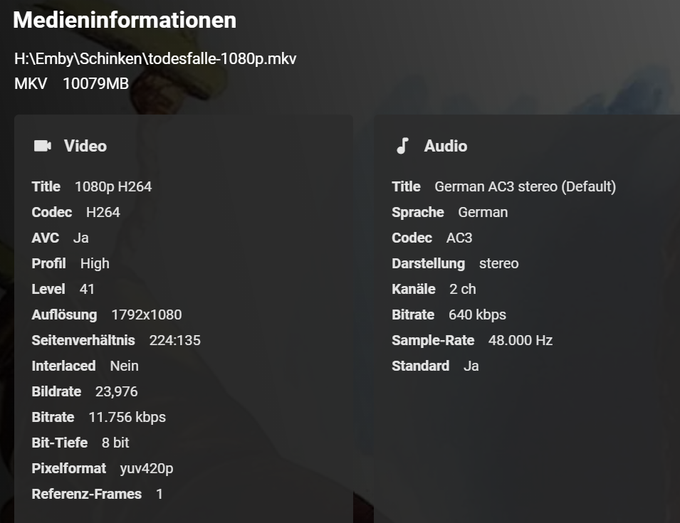

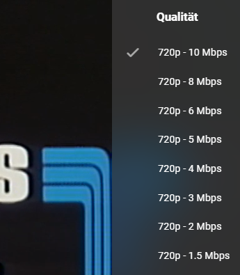

mholin 23 Posted December 30, 2020 Author Posted December 30, 2020 I did a further analysis on the 'Deadfall' movie. During playback, I only see bitrate options to set with max 720p 10 mbit. I choosed 720p 10 mbit. Here are some lines from ffmpeg-transcode log: 18:25:34.042 encoder : libebml v1.2.2 + libmatroska v1.3.0 18:25:34.042 creation_time : 2013-12-05T07:03:53.000000Z 18:25:34.042 Duration: 01:59:51.26, start: 0.000000, bitrate: 11756 kb/s 18:25:34.042 Stream #0:0: Video: h264 (High), yuv420p(progressive), 1792x1080, SAR 1:1 DAR 224:135, Level 41, 23.98 fps, 23.98 tbr, 1k tbn, 47.95 tbc (default) 18:25:34.043 Stream #0:1(ger): Audio: ac3, 48000 Hz, stereo, fltp, 640 kb/s (default) 18:25:34.043 Metadata: 18:25:34.043 title : German 18:25:34.043 Stream #0:2(eng): Audio: ac3, 48000 Hz, stereo, fltp, 640 kb/s 18:25:34.043 Metadata: 18:25:34.043 title : English 18:25:34.296 Stream mapping: 18:25:34.296 Stream #0:0 -> #0:0 (h264 (h264_cuvid) -> h264 (h264_nvenc)) 18:25:34.296 Stream #0:1 -> #0:1 (ac3 (native) -> mp3 (libmp3lame)) 18:25:34.296 Press [q] to stop, [?] for help 18:25:34.432 Output #0, segment, to 'v:\transcoding-temp\81D384_%d.ts': 18:25:34.432 Metadata: 18:25:34.432 encoder : Lavf58.35.100 18:25:34.432 Stream #0:0: Video: h264 (h264_nvenc) (High), cuda, 1792x1080 [SAR 1:1 DAR 224:135], q=-1--1, 9360 kb/s, 23.98 fps, 90k tbn, 23.98 tbc (default) 18:25:34.432 Metadata: 18:25:34.432 encoder : Lavc58.62.100 h264_nvenc 18:25:34.432 Side data: 18:25:34.432 cpb: bitrate max/min/avg: 9360000/0/9360000 buffer size: 18720000 vbv_delay: N/A 18:25:34.433 Stream #0:1(ger): Audio: mp3 (libmp3lame), 48000 Hz, stereo, fltp, 192 kb/s (default) then I choosed 720p 6 mbit. Here are some lines from ffmpeg-transcode log: 10:44:27.878 encoder : libebml v1.2.2 + libmatroska v1.3.0 10:44:27.878 creation_time : 2013-12-05T07:03:53.000000Z 10:44:27.878 Duration: 01:59:51.26, start: 0.000000, bitrate: 11756 kb/s 10:44:27.879 Stream #0:0: Video: h264 (High), yuv420p(progressive), 1792x1080, SAR 1:1 DAR 224:135, Level 41, 23.98 fps, 23.98 tbr, 1k tbn, 47.95 tbc (default) 10:44:27.879 Stream #0:1(ger): Audio: ac3, 48000 Hz, stereo, fltp, 640 kb/s (default) 10:44:27.879 Metadata: 10:44:27.879 title : German 10:44:27.879 Stream #0:2(eng): Audio: ac3, 48000 Hz, stereo, fltp, 640 kb/s 10:44:27.879 Metadata: 10:44:27.879 title : English 10:44:28.236 Stream mapping: 10:44:28.236 Stream #0:0 -> #0:0 (h264 (h264_cuvid) -> h264 (h264_nvenc)) 10:44:28.236 Stream #0:1 -> #0:1 (ac3 (native) -> mp3 (libmp3lame)) 10:44:28.236 Press [q] to stop, [?] for help 10:44:28.477 Output #0, segment, to 'v:\transcoding-temp\758BCE_%d.ts': 10:44:28.477 Metadata: 10:44:28.477 encoder : Lavf58.35.100 10:44:28.477 Stream #0:0: Video: h264 (h264_nvenc) (High), cuda, 1792x1080 [SAR 1:1 DAR 224:135], q=-1--1, 5360 kb/s, 23.98 fps, 90k tbn, 23.98 tbc (default) 10:44:28.477 Metadata: 10:44:28.477 encoder : Lavc58.62.100 h264_nvenc 10:44:28.478 Side data: 10:44:28.478 cpb: bitrate max/min/avg: 5360000/0/5360000 buffer size: 10720000 vbv_delay: N/A 10:44:28.478 Stream #0:1(ger): Audio: mp3 (libmp3lame), 48000 Hz, stereo, fltp, 192 kb/s (default) it looks like, the 720p from the 'quality menu' is ignored, but the bitrate is set properly. 1
