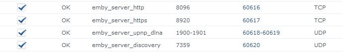

Snakebait 6 Posted December 18, 2020 Author Posted December 18, 2020 Hi. I have added a screen shot of the ports Emby is using on my DS415+. Hope this helps in resolving my issue. Tom

Solution Luke 42243 Posted December 18, 2020 Solution Posted December 18, 2020 Ok wait you're mapping external port 8096 to internal port 8920? Try mapping that to internal port 8096.
Snakebait 6 Posted December 19, 2020 Author Posted December 19, 2020 Hi, Working...Thank you and Merry Christmas!!!
