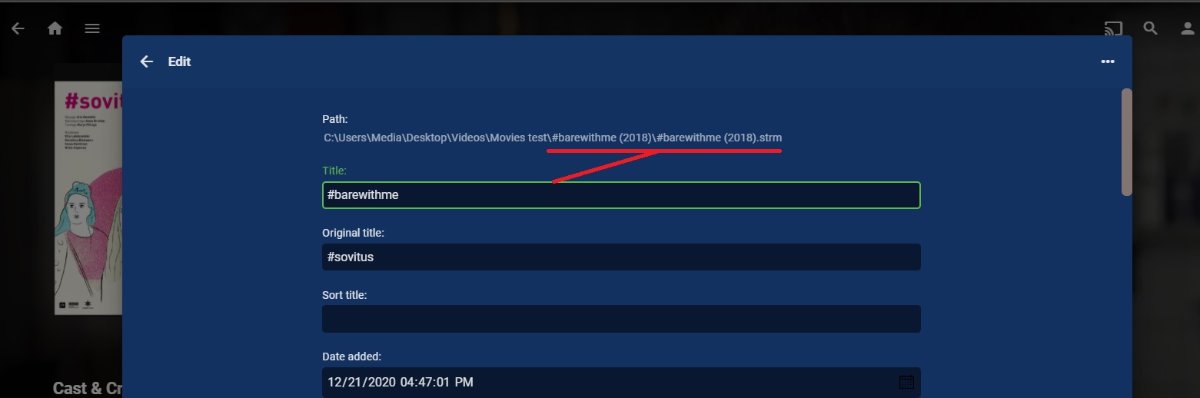

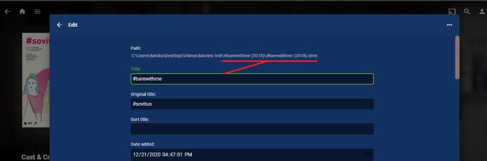

Happy2Play 9813 Posted December 22, 2020 Posted December 22, 2020 Is this a specific Content type issue? New portable

crfloyd0932 5 Posted December 22, 2020 Author Posted December 22, 2020 3 hours ago, Happy2Play said: Is this a specific Content type issue? New portable Maybe its just a linux release issue?, I just installed server in a windows vm, and was also able to add files with a hashtag in them. i can try with a linux vm and see if its the same result. i've always run the windows version so this is my first go around with the linux release.
Luke 42246 Posted December 30, 2020 Posted December 30, 2020 Are you sure it's related to # anywhere in the name, or rather, files and folders that start with a # ?
