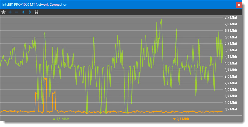

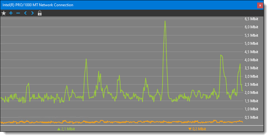

plessers@gmail.com 32 Posted June 11, 2024 Posted June 11, 2024 Hi everyone, I still have problems with streaming movies trough nginx. Following case - movie 3Mbps - ISP upstream limit 10Mbps If I stream direct from my server to a client outside my netwerk http://myserver.org:8096 the file is streamed fine (direct play) with a +/- constant stream of +/- 4Mbps: However, if I stream trough nginx, it keeps stuttering I already figured out that I needed to disable buffering proxy_buffering off; But with this setting (and only this setting), my upstream seems to be "soft-limited" to +/- 2Mbps: (No need to mention that connection server --> nginx --> router is all 1Gbps) Is there any explanation for this behavior? How can I disable buffering (because than I had other problems) but still able to play my video's? kind regards, bartplessers PS I'm not using vanilla nginx, but "Nginx Proxy Manager" https://nginxproxymanager.com/ as an addon on my Home Assistant server https://www.home-assistant.io/

weble 19 Posted June 11, 2024 Posted June 11, 2024 @plessers@gmail.com If your using NPM you need to setup a custom location for emby and ideally you also use advanced. I just spun up a docker container to test this, it works great, nice interface but I am old school and prefer nginx config files. Under Advanced tab use this: include mime.types; default_type application/octet-stream; server_tokens off; sendfile off; ##sendfile not used in a proxy env proxy_buffering off; gzip on; ## Compresses the content to the client, speeds up client browsing. gzip_disable "msie6"; gzip_comp_level 6; gzip_min_length 1100; gzip_buffers 16 8k; gzip_proxied any; gzip_types text/plain text/css text/js text/xml text/javascript application/javascript application/x-javascript application/json application/xml application/rss+xml image/svg+xml; proxy_connect_timeout 1h; proxy_send_timeout 1h; proxy_read_timeout 1h; tcp_nodelay on; ## Sends data as fast as it can not buffering large chunks Under custom location use this: location / { proxy_pass http://xxx.xxx.xxx.xxx:8096; ## Enter the IP and port of the backend emby server here. client_max_body_size 1000M; ## Allows for mobile device large photo uploads. proxy_hide_header X-Powered-By; ## Hides nginx server version from bad guys. proxy_set_header Range $http_range; ## Allows specific chunks of a file to be requested. proxy_set_header If-Range $http_if_range; ## Allows specific chunks of a file to be requested. proxy_set_header X-Real-IP $remote_addr; ## Passes the real client IP to the backend server. #proxy_set_header X-Real-IP $http_CF_Connecting_IP; ## if you use cloudflare un-comment this line and comment out above line. proxy_set_header Host $host; ## Passes the requested domain name to the backend server. proxy_set_header X-Forwarded-For $proxy_add_x_forwarded_for; ## Adds forwarded IP to the list of IPs that were forwarded to the backend server. ## ADDITIONAL SECURITY SETTINGS ## ## Optional settings to improve security ## ## add these after you have completed your testing and ssl setup ## ## NOTICE: For the Strict-Transport-Security setting below, I would recommend ramping up to this value ## ## See https://hstspreload.org/ read through the "Deployment Recommendations" section first! ## add_header 'Referrer-Policy' 'origin-when-cross-origin'; add_header Strict-Transport-Security "max-age=15552000; preload" always; add_header X-Frame-Options "SAMEORIGIN" always; add_header X-Content-Type-Options "nosniff" always; add_header X-XSS-Protection "1; mode=block" always; ## WEBSOCKET SETTINGS ## Used to pass two way real time info to and from emby and the client. proxy_http_version 1.1; proxy_set_header Upgrade $http_upgrade; proxy_set_header Connection $http_connection; } If your still having issues, its possible your client or server is limiting the bitrate. Double check your emby settings for that. 2 1
plessers@gmail.com 32 Posted June 11, 2024 Posted June 11, 2024 1 hour ago, weble said: If your still having issues, its possible your client or server is limiting the bitrate. Double check your emby settings for that. wow. quick reaction and..... problem seems to be solved (tested for +/- 45min) thanx a lot!!! 1

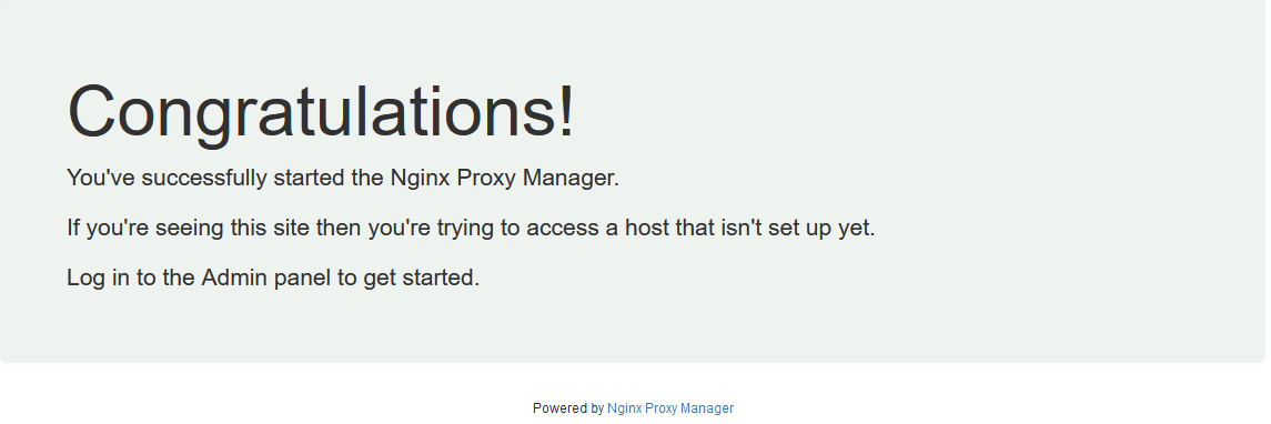

offroadguy56 0 Posted August 12, 2024 Posted August 12, 2024 I too am using NPM. I did copy paste the original block of text from OP into the config file. But when I navigate to the domain I am greeted with the default welcome to nginx proxy manager, the host isn't up yet message. I came to the end of the topic and found the NPM specific setups but when I pasted those in I am still greeted with the same message. When I enable SSL I either get a 502 or nothing loads on the page depending on what settings I've used above. Not sure of the issue.
offroadguy56 0 Posted August 12, 2024 Posted August 12, 2024 Can't edit a post. An update to the above. I changed the network type from Host to br0. Instead of using IP of the host server it's now using the IP off the local network. Quick initial testing shows that it is working with and without the NPM specific settings located further above.
guunter 49 Posted August 13, 2024 Posted August 13, 2024 5 hours ago, offroadguy56 said: Can't edit a post. An update to the above. I changed the network type from Host to br0. Instead of using IP of the host server it's now using the IP off the local network. Quick initial testing shows that it is working with and without the NPM specific settings located further above. You don’t need to define a location for NPM to work.
