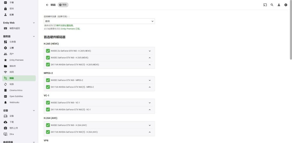

fallenevil 0 Posted December 16, 2020 Posted December 16, 2020 (edited) System:winserver2019 Emby version:4.5.4.0 GPU:GTX960 I am a Premiere user. ALL other files can be transcoded by GPU except 4K HEVC files. How to solve it? ffmpeg-transcode-0bd7739b-4d7f-493a-bbb7-99fa92eab33e_1.txt Edited December 16, 2020 by fallenevil add ffmpeg log

Carlo 4561 Posted December 16, 2020 Posted December 16, 2020 Hi, the ffmpeg log is complaining about an error 21:11:28.208 [scale_cuda@f1 @ 000002eaf517d300] cu->cuModuleLoadData(&s->cu_module, vf_scale_cuda_ptx) failed -> CUDA_ERROR_JIT_COMPILER_NOT_FOUND: PTX JIT compiler library not found @softworkz Can you take a look?
Luke 42204 Posted December 16, 2020 Posted December 16, 2020 Hi there, please attach the emby server and hardware detection logs as well. thanks.
Solution softworkz 5129 Posted December 17, 2020 Solution Posted December 17, 2020 @fallenevil - Did you install the latest drivers from the Nvidia website? If yes, please: 12 hours ago, Luke said: Hi there, please attach the emby server and hardware detection logs as well. thanks.
