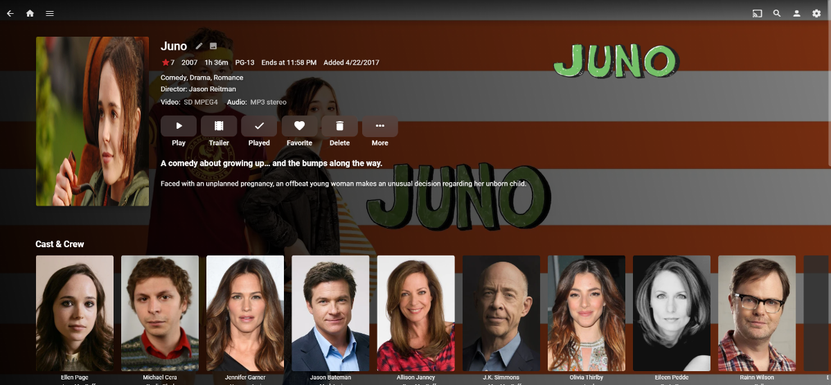

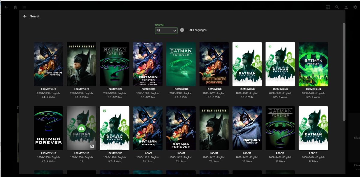

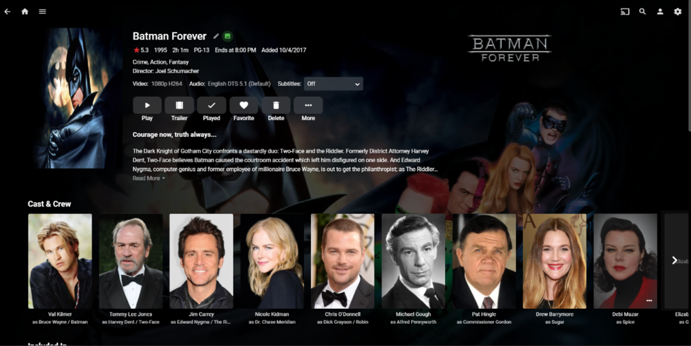

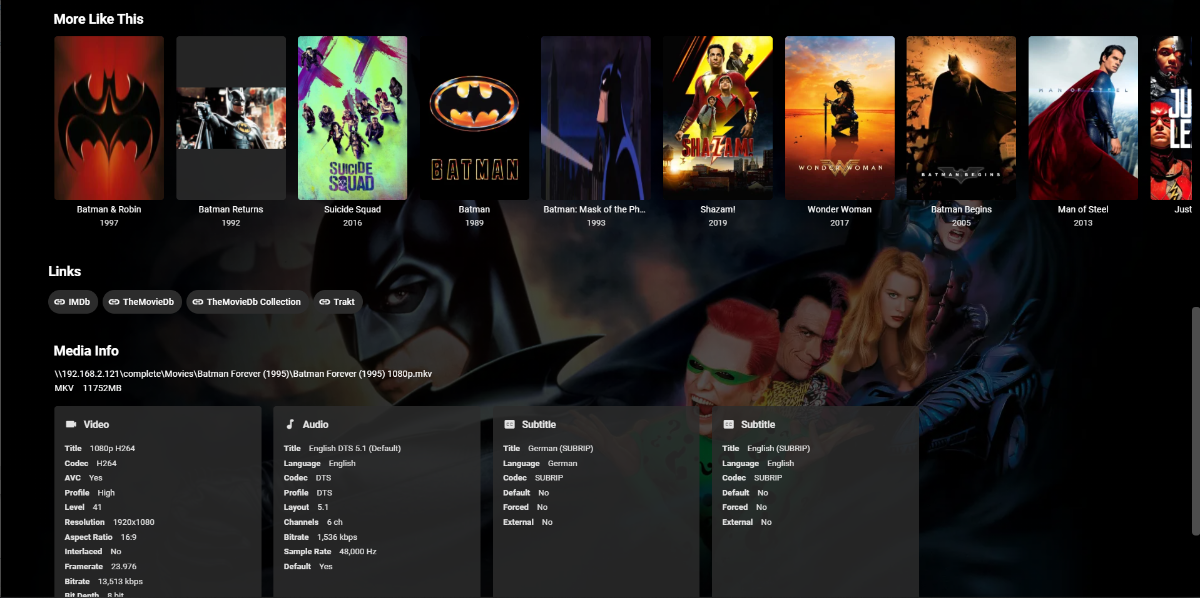

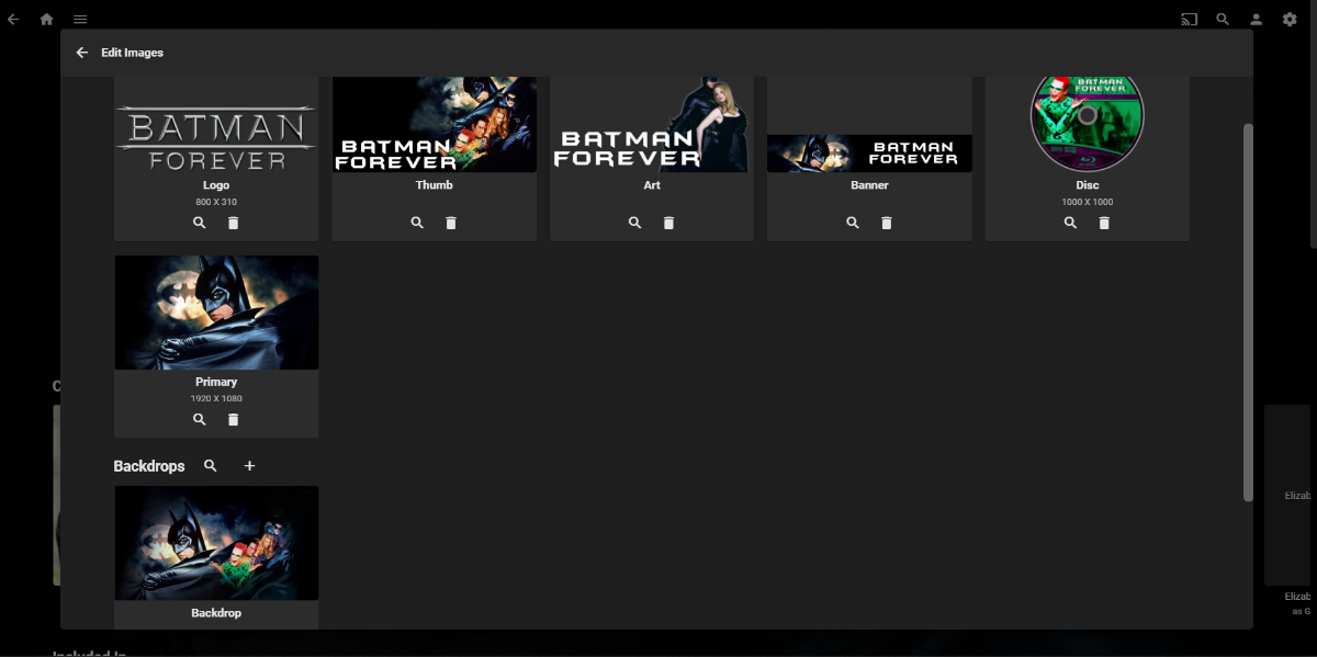

lqpartyrock 2 Posted December 15, 2020 Posted December 15, 2020 I'm having trouble displaying primary poster for a lot of my movies. If I manually click edit and download a new primary image it works. Some primary images are showing the backdrop image weirdly scaled or or missing the image metadata, but everything else such as description show fine. I've attached a couple screenshots. First one shows the wrong primary image, second is the edit screen, 3rd is search, 4th is more of the same issue showing for other movies. A refresh of metadata doesnt work, rescanning the library doesnt work. This is prevalent on a lot of older movies as apart of my initial scan. This rarely happens when adding new movies, but it does happen on occasion. I manually fix the new ones and some of the old ones I catch, but there are thousands like this. Any ideas?

Happy2Play 9802 Posted December 15, 2020 Posted December 15, 2020 (edited) I guess the first question is why your existing Poster/Folder image is a Backdrop and not Poster? On item details the placeholder expects a 3:2 image not 16:9. 6 minutes ago, lqpartyrock said: A refresh of metadata doesnt work Did you select replace images also? As you have a issue with your current images being wrong. Edited December 15, 2020 by Happy2Play

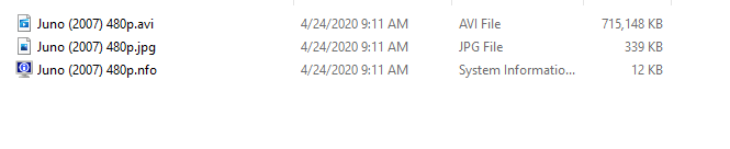

lqpartyrock 2 Posted December 19, 2020 Author Posted December 19, 2020 I guess I was wrong. Still happening on some movies. Removed .tbn and .jpg files from the folder. Some titles still show the wrong primary. All the other Metadata is there.
Happy2Play 9802 Posted December 19, 2020 Posted December 19, 2020 What is that "Juno (2007) 480p.jpg" shown in the folder? My guess is it is the image shown as the poster. Per the KB image naming "Juno (2007) 480p.jpg" is a Primary image. Image Type Supported file names Primary {name}.ext {name}-poster.ext {name}-cover.ext {name}-default.ext {name}-movie.ext folder.ext poster.ext cover.ext default.ext movie.ext
lqpartyrock 2 Posted December 19, 2020 Author Posted December 19, 2020 4 minutes ago, Happy2Play said: What is that "Juno (2007) 480p.jpg" shown in the folder? My guess is it is the image shown as the poster. Per the KB image naming "Juno (2007) 480p.jpg" is a Primary image. Image Type Supported file names Primary {name}.ext {name}-poster.ext {name}-cover.ext {name}-default.ext {name}-movie.ext folder.ext poster.ext cover.ext default.ext movie.ext I thought the same, but i removed that .jpg rescanned library and refreshed metadata, no change
Happy2Play 9802 Posted December 19, 2020 Posted December 19, 2020 2 minutes ago, lqpartyrock said: I thought the same, but i removed that .jpg rescanned library and refreshed metadata, no change Only thing I can think of is a cache issue. What happens if you Refresh w/replace images on that item?
lqpartyrock 2 Posted December 19, 2020 Author Posted December 19, 2020 8 minutes ago, Happy2Play said: Only thing I can think of is a cache issue. What happens if you Refresh w/replace images on that item? Once again you may be right. Found another post from 2016 . Luke responded. I need to delete all .jpg files. Looks like it's choosing those as the default. Caching seems to be an issue, as i've checked now and the correct juno poster is displayed. 1
