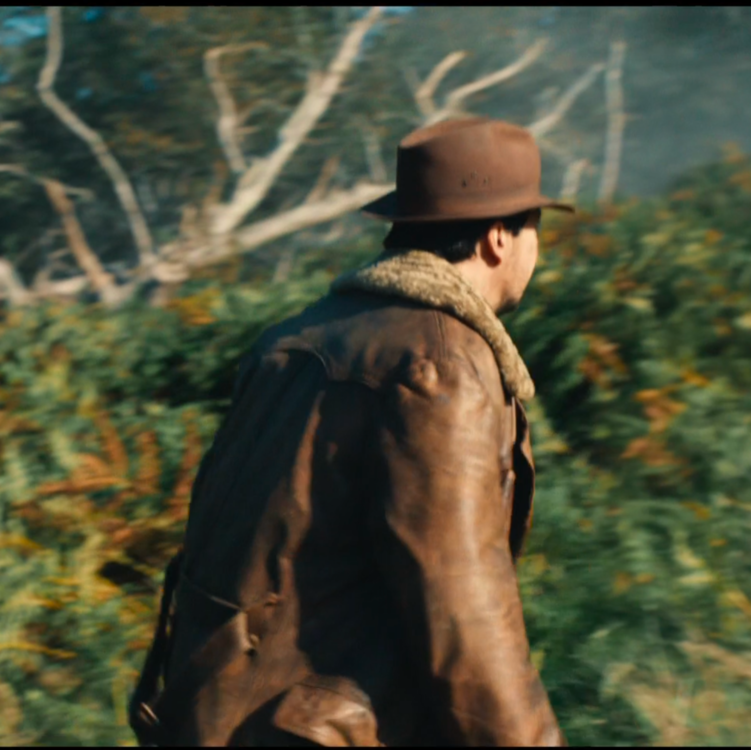

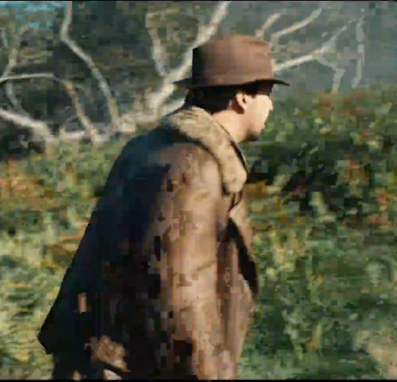

karlshea 8 Posted December 15, 2020 Posted December 15, 2020 Playing an h264 mkv to Kodi does not require transcoding, and the video looks great. Playing to Chrome ("audio codec not supported") or an Apple TV 4K ("container not supported") produces super pixelated transcode with a lot of banding. HW acceleration is on, preset is Auto (but "slow" still has an issue), and CRF is 18. Chrome: VLC: embyserver.txt ffmpeg-transcode-e700d052-af19-4208-8c3e-f0aedca0abf8_1.txt

softworkz 5133 Posted December 15, 2020 Posted December 15, 2020 @karlshea - Thanks for creating a separate issue. One thing that I can already tell is that your case is totally different from the other one where you had posted before (https://emby.media/community/index.php?/topic/92331-why-is-my-transcoding-quality-so-bad) Your Issue Other Issue Encoder VAAPI HW libx264 SW Deinterlacing Yes No Source vs. output bitrate Roughly Equal Output much lower than source etc. Back to your issue: Does your screenshot comparison correspond to the ffmpeg log that you have posted? For further investigation, could you please install the Diagnostics Plugin?https://mediabrowser.github.io/Emby.DiagnosticsPlugin/ Thanks
karlshea 8 Posted December 15, 2020 Author Posted December 15, 2020 @softworkz good to know! Yes, the log and screenshot are both from the first ~10 seconds of the same file. I've installed the diagnostics plugin.

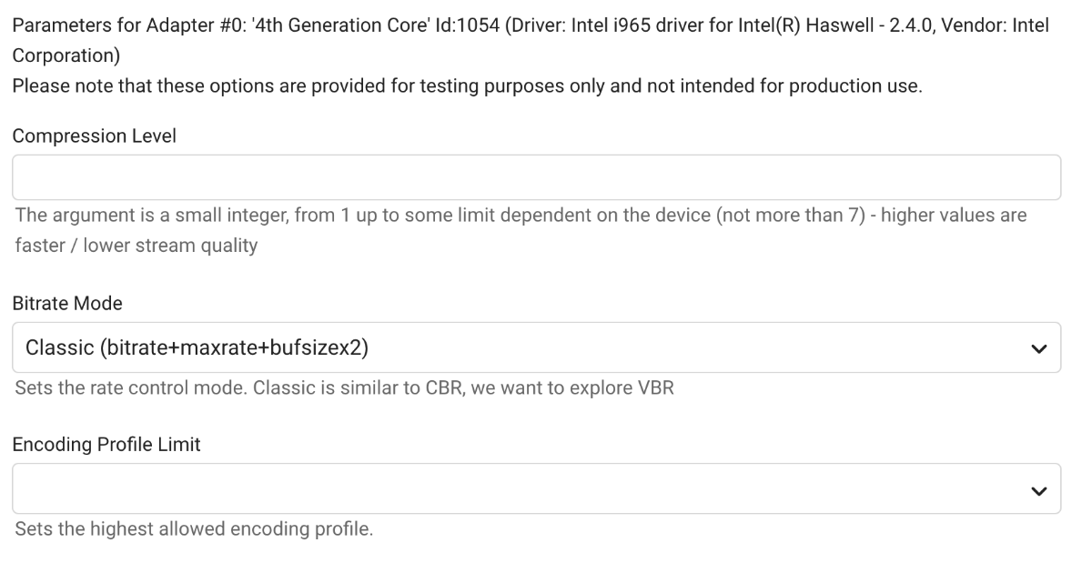

softworkz 5133 Posted December 15, 2020 Posted December 15, 2020 When the plugin is installed, there's an additional entry "Codec Parameters": It will look differently in your case but quite similar. What you need is the "H.264 VAAPI Encoder" (similar). When you click the gear-icon, you'll be able to change a number of settings to adjust the VAAPI hardware encoding quality with which you can play a bit.
karlshea 8 Posted December 15, 2020 Author Posted December 15, 2020 That page is completely blank for me except for the "Codec Parameters" header.
softworkz 5133 Posted December 15, 2020 Posted December 15, 2020 Ah yea, please go to the "Transcoding" page, choose "Advanced" from the dropdown and save. Then go back to "Codec Parameters".
karlshea 8 Posted December 16, 2020 Author Posted December 16, 2020 The only hardware encoder that's configurable is "VAAPI 4th Generation Core - H.264 (AVC)". What should I be looking at changing?
softworkz 5133 Posted December 16, 2020 Posted December 16, 2020 17 hours ago, karlshea said: The only hardware encoder that's configurable is "VAAPI 4th Generation Core - H.264 (AVC)". What should I be looking at changing? You can try different different presets.
karlshea 8 Posted December 16, 2020 Author Posted December 16, 2020 What should I be looking at here to fix interlaced videos?
softworkz 5133 Posted December 16, 2020 Posted December 16, 2020 Sorry, the "Preset" selection is hidden. Don't remember why. Try different "Compression level" values. Leave the other two unchanged.
karlshea 8 Posted December 16, 2020 Author Posted December 16, 2020 I tried setting it to "1" and it didn't make a noticeable difference with pixelation during movement.

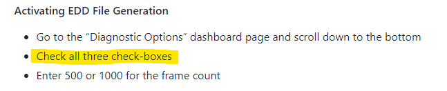

softworkz 5133 Posted December 16, 2020 Posted December 16, 2020 Thanks for the log. It think I got an idea know about what's probably happening. It seems that the deinterlacing doesn't work correctly and is outputting duplicate frames or even still fields. Could you please create an EDD file as described here: https://mediabrowser.github.io/Emby.DiagnosticsPlugin/#generating-edd-files Just run like for 30s, after stopping it takes a while, then you'll see the edd file.
karlshea 8 Posted December 16, 2020 Author Posted December 16, 2020 diag_74573cb93a834786b20ab064f4c42f86.edd
softworkz 5133 Posted December 17, 2020 Posted December 17, 2020 Thanks. The output HLS segments haven't been analyzed. Die you check "Media Analysis"?
karlshea 8 Posted December 17, 2020 Author Posted December 17, 2020 Yes, I did it again just to be sure: 2020-12-17 18:33:00.390 Info EncodingDiagnostics: ProbeHlsOutput complete 2020-12-17 18:33:00.393 Info App: ProcessRun 'StreamTranscode 67663d': Stopping ffmpeg process with q command for /config/transcoding-temp/1AE268_0.ts 2020-12-17 18:33:00.394 Info EncodingDiagnostics: ProcessRun 'EncodingDiagnostics' Execute: /bin/ffprobe -hide_banner -i "/mnt/chef_multimedia/TV/His Dark Materials/Season 2/His Dark Materials - S02E06 - Malice HDTV-1080p Proper.mkv" -show_format -show_streams -show_frames -print_format json -read_intervals %+#1000 2020-12-17 18:33:00.437 Info App: AppendExtraLogData - Read graph file: /config/logs/ffmpeg-transcode-67663d9d-c9da-4728-813c-78d619ea2acd_1graph.txt 2020-12-17 18:33:00.460 Info App: AppendExtraLogData - Deserialized GraphData fileStream: {0:n} bytes Graph Count: 2 2020-12-17 18:33:00.460 Info App: AppendExtraLogData - File Deleted 2020-12-17 18:33:00.567 Info App: ProcessRun 'StreamTranscode 67663d' Process exited with code 0 2020-12-17 18:33:00.576 Info SessionManager: Playback stopped reported by app Emby Web 4.5.4.0 playing Malice. Stopped at 44676 ms 2020-12-17 18:33:00.670 Info Server: http/1.1 Response 204 to 192.168.10.50. Time: 307ms. http://citywall.weil-st.net:8096/emby/Sessions/Playing/Stopped?X-Emby-Client=Emby Web&X-Emby-Device-Name=Chrome&X-Emby-Device-Id=TW96aWxsYS81LjAgKE1hY2ludG9zaDsgSW50ZWwgTWFjIE9TIFggMTBfMTRfNSkgQXBwbGVXZWJLaXQvNTM3LjM2IChLSFRNTCwgbGlrZSBHZWNrbykgQ2hyb21lLzc0LjAuMzcyOS4xNjkgU2FmYXJpLzUzNy4zNnwxNTU5NTQzNTk0NTQ4&X-Emby-Client-Version=4.5.4.0 2020-12-17 18:33:00.676 Info PlaybackReporting - EventMonitorEntryPoint: _sessionManager_PlaybackStop : Entered 2020-12-17 18:33:00.676 Info PlaybackReporting - EventMonitorEntryPoint: Saving final duration for Item : TW96aWxsYS81LjAgKE1hY2ludG9zaDsgSW50ZWwgTWFjIE9TIFggMTBfMTRfNSkgQXBwbGVXZWJLaXQvNTM3LjM2IChLSFRNTCwgbGlrZSBHZWNrbykgQ2hyb21lLzc0LjAuMzcyOS4xNjkgU2FmYXJpLzUzNy4zNnwxNTU5NTQzNTk0NTQ4-378f394f550b4e4398c5af8ff545cb63-22256 2020-12-17 18:33:00.688 Info PlaybackReporting - EventMonitorEntryPoint: Removing Old Key from playback_trackers : TW96aWxsYS81LjAgKE1hY2ludG9zaDsgSW50ZWwgTWFjIE9TIFggMTBfMTRfNSkgQXBwbGVXZWJLaXQvNTM3LjM2IChLSFRNTCwgbGlrZSBHZWNrbykgQ2hyb21lLzc0LjAuMzcyOS4xNjkgU2FmYXJpLzUzNy4zNnwxNTU5NTQzNTk0NTQ4-378f394f550b4e4398c5af8ff545cb63-22256 2020-12-17 18:33:02.137 Info EncodingDiagnostics: ProcessRun 'EncodingDiagnostics' Process exited with code 0 diag_7144d375edf24ce1986792dbee481f6c.edd
