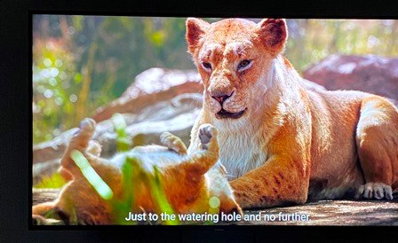

CogyG 3 Posted December 12, 2020 Author Posted December 12, 2020 (edited) Thank you SamEs for the nice explanation. I tried to extract the subtitles but it takes ages to do only one. And i got a lot of movies with PGS subs.. I can DirectPlay, PGS subs on my Nvidia Shield, downstairs, so without transcoding. It this because of the Shield? Below you can see how low the subtitles are, this is for every movie. If it's possible i would like to have the variable option for the subtitles Thank you sir Edited December 12, 2020 by CogyG 1

SamES 1084 Posted December 12, 2020 Posted December 12, 2020 Yes, possibly the Shield can handle PGS due to its processing capabilities, but it would be a rare case. So in your picture, the subs appear to be at the bottom of the screen, which is how they should be in Samsung app now. So even for this case you would want them higher, or is this the right position for this aspect ratio/format?

FrostByte 5453 Posted December 12, 2020 Posted December 12, 2020 (edited) 23 minutes ago, SamES said: Yes, possibly the Shield can handle PGS due to its processing capabilities, but it would be a rare case. So in your picture, the subs appear to be at the bottom of the screen, which is how they should be in Samsung app now. So even for this case you would want them higher, or is this the right position for this aspect ratio/format? In his picture that's where I want them Or, maybe a little higher on a IMAX movie where the picture takes up the whole screen. How would the Samsung app know where the picture ends and the black bars start with a remuxed movie (with black bars)? The file would be 3840*2160 with black bars, but the picture part could almost be anything down to 3840*1600. In that case either the user defines the position in their subs (ASS can do that), or the client would need to have an option to move them on the fly as the resolution of the picture part will differ with every movie. Edited December 12, 2020 by FrostByte 1

FrostByte 5453 Posted December 12, 2020 Posted December 12, 2020 I like the second one better. My eyes are more closely centered on the picture and not way down in the dirt. I haven't quite woken up this morning and the snow is blowing so hard outside I can't see our barn. So if what I say doesn't make sense it's because my brain isn't functioning yet.
SamES 1084 Posted December 12, 2020 Posted December 12, 2020 8 hours ago, FrostByte said: How would the Samsung app know where the picture ends and the black bars start with a remuxed movie (with black bars)? Yes, this is the problem. The best I could do is look at the height of the media item and ensure the subs are located within this height. This will be a problem if the black bars are encoded in the file, which I don't think is often the case. Worst case, it will look the same as now, and for most media without the black bars encoded, it will look more like you want. It won't be perfect, but definitely closer, more often. Is this typically where subs are located on other clients (Shield?), over the content and out of the black bars? I find text over the image can be hard to read and prefer them in the bottom, but I don't use subs a lot, so I can imagine that those that use them often may like them to be more centered. Which clients have the ability to adjust the subs? I can look at how that's implemented. It will really depend on what @Lukewants for consistency across clients. 1
