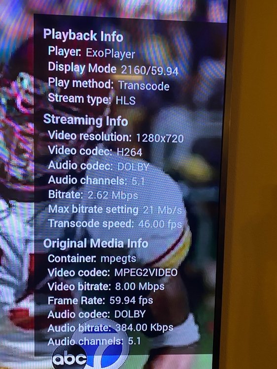

samson1701 0 Posted December 11, 2020 Posted December 11, 2020 (edited) Hello, I’m new to all of this so it’s very possible that it’s just a case of pilot error. With that said: I have the server set up on my Nvidia Shield Pro. When watching live OTA TV, I get constant pausing. But, when I watch OTA on my Roku TV, it plays smooth as butter. But, has constant pausing on my iPad and iPhone. I’m using an HDHomeRun Duo attached to my Nvidia Shield Pro. I’ve tried adjusting the playback bit rate. Also, how do I enable OTA live TV subtitles on the Emby Roku app? What am I doing wrong? From the Nvidia Shield ffmpeg-transcode-3b3060dc-c55a-471e-b5f6-d792d11c4914_1.txt embyserver.txt Edited December 11, 2020 by samson1701

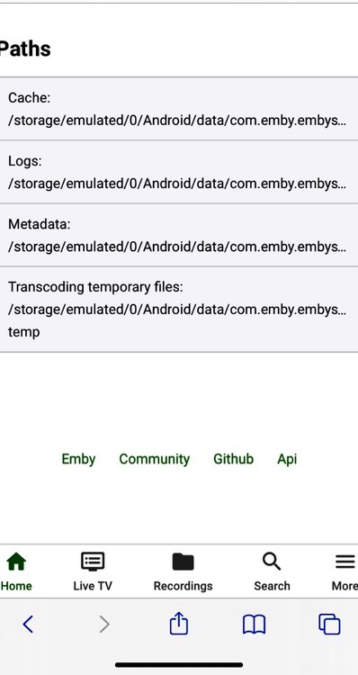

ebr 16337 Posted December 11, 2020 Posted December 11, 2020 5 hours ago, samson1701 said: I’ve also tried enabling Direct Play, which does solve the problem. That would suggest to me that there is an I/O bottleneck on the device as its being used as server, transcoder and playback device. Where is your transcoding temp folder?
samson1701 0 Posted December 11, 2020 Author Posted December 11, 2020 3 hours ago, ebr said: That would suggest to me that there is an I/O bottleneck on the device as its being used as server, transcoder and playback device. Where is your transcoding temp folder? The transcoding temporary path box on the Transcoding page is empty. I also took a screenshot of the paths section.

Carlo 4561 Posted December 16, 2020 Posted December 16, 2020 Hi, the question that I'd ask is why this is being transcoded in the first place? That 720p channels should have no problem direct streaming with full CC and trickplay support. Live TV is pretty high IO and is right on the border IMHO of what the Shield TV handles. When you add the extra IO for Transcoding and writing all those HLS packets, it becomes a bottle neck on many devices. Then considering this device is doing double duty as the player as well with yet more IO the HLS processing and it's close to impossible to work reliable. With that said some good news is the pipeline in the new Live TV implementation in progress uses far less IO and will go a long way in making the Shield TV and other devices with limited IO ability to handle this type of thing much better.
