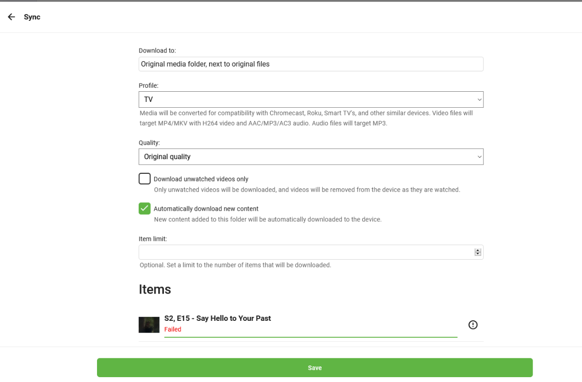

kadorken 1 Posted December 9, 2020 Author Posted December 9, 2020 In my conversions page, I have one defined called "TV Shows" which I thought I needed to converted the DVR recording to a TV format so we could watch them on the LG TV. The settings are as outlined in the attached image. I suspect having the Original media folder, next to original files" combined with "Automatically download new content" is causing the cycle of conversions (new content plus put in same folder causes new content etc.) Not sure why I have this; I set it up when I got the homerun box thinking it was required to convert the .ts file to a format for the LG TV. but there is no need to preconvert it I think, just convert it while watching should suffice. I will remove the conversion step until I can figure out why I had it. Thanks for the hint of where to look.

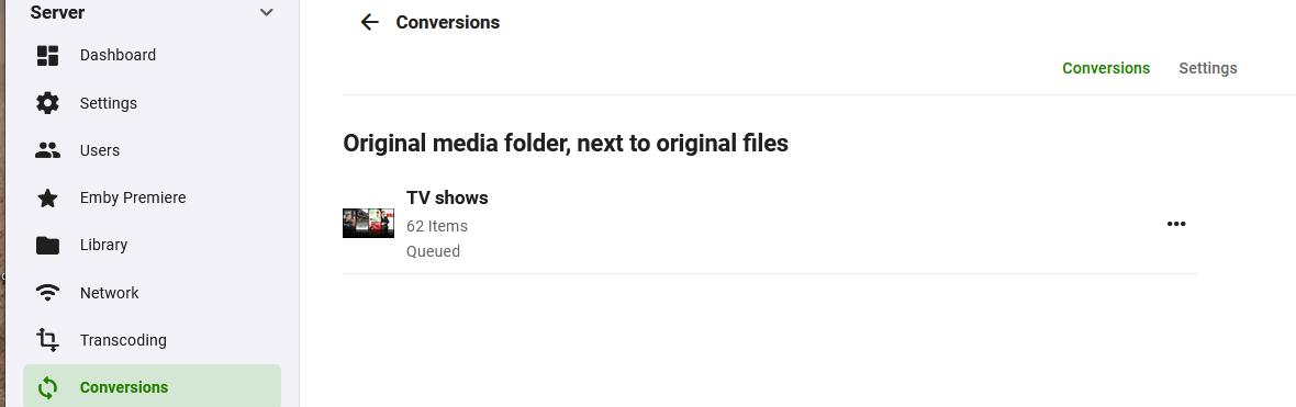

Q-Droid 1011 Posted December 9, 2020 Posted December 9, 2020 Convert and Sync were somewhat intertwined in previous releases of the Emby server. There's a clearer separation in more recent versions. No plug-in needed. Are you trying to get rid of the conversion job or create new ones? You can remove it from Manage Emby Server -> Conversions -> 3-dot -> Remove download. It won't get rid of the media, only the job. You can create conversions from any of the 3-dot menus on the media. A single conversion runs at the movie and TV episode level. At higher levels like season, series, library it can create a job that can run on a schedule. Transcoding in advance for better playback on browser and/or lower bitrates is how I use conversions.
kadorken 1 Posted December 10, 2020 Author Posted December 10, 2020 I am trying to set up transcoding in advance (as you do) so new recordings are already ready for the TV and my poor NAS isn't tasked to do it when we decide to watch a show. I removed the one I created long ago. So I don't need the Folder Sync plugin I guess. I'll poke around more but I fail to see still how you create conversions from the 3-dot menus 'on the media' (I am likely misunderstanding what 'on the media ' is). All the 3 dot menu items I see on 'TV Shows' (for example) are Settings with View: and Show Fields with check boxes. No Sync/Conversion. I do find Conversion if I use the 3 dots on a particular recording but I think I was trying to do it for ALL/ANY recordings that appear (at the top level).

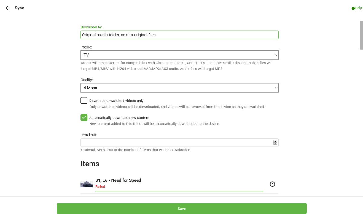

kadorken 1 Posted December 14, 2020 Author Posted December 14, 2020 Okay, a few days have gone by. I have noticed endless conversions being created with my newly created conversion task. Only seems to occur on these recordings that date back to April 2020 (both in the magnum directory); (I am only showing one of the episodes that have multiple (daily) conversions; I had deleted the others but they were in the same directory.) The first image is a screenshot of windows explorer window showing the multiple files, each with an increasing file name of "- tv" appended to it. Emby server 4.5.3.0, on Symbology NAS embyserverEndlessConversionsLog.txt
Luke 42243 Posted December 14, 2020 Posted December 14, 2020 4.5.4 is about to roll out so please see if that helps. It won't make the current queue go away, so you may need to delete the excess jobs, but hopefully it won't happen again after that. 1
