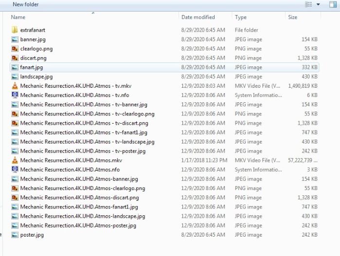

Spyderturbo007 19 Posted December 9, 2020 Author Posted December 9, 2020 (edited) I went ahead and converted one as a test. It appears as though it creates another file and they appear side by side in the interface. It looks like there is no way to know which one is 4K unless you open up each movie and check the file attributes? Edited December 9, 2020 by Spyderturbo007

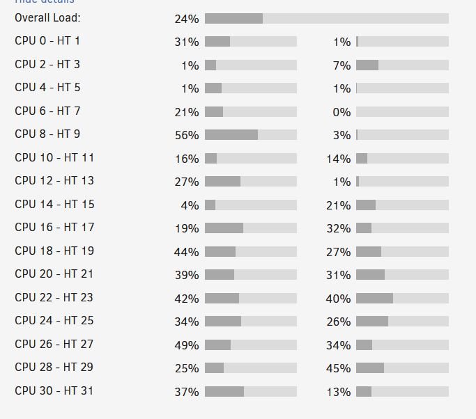

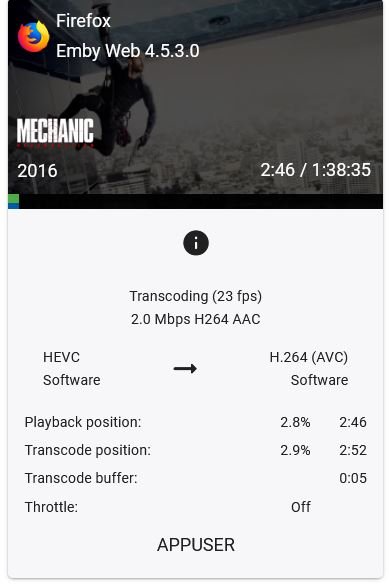

Spyderturbo007 19 Posted December 12, 2020 Author Posted December 12, 2020 So, I'm back trying to get this to work correctly. I upgraded the server to 2 x 16 core CPUs with a 2.5GHz base clock and a boost to 3.4GHz. I'm still running into the same issue. The transcode of 4K material starts out just fine at ~40fps and then slowly degrades down to ~22fps at which point the buffer is overrun and the video stutters. The transcoding temp file is on an SSD so I don't see that as being a bottle neck. I can write to that drive at about 130MB/s. It just isn't using the CPUs properly. They are really just sitting there waiting for something to do. Stream Start: After about 3 minutes CPU utilization ffmpeg-transcode-c4dfc363-7269-497b-8b43-e8754354371d_1.txt
