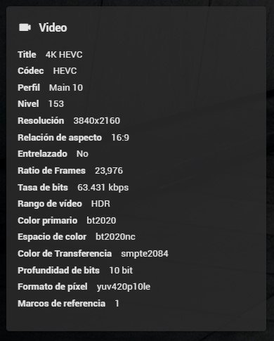

vdatanet 1619 Posted December 7, 2020 Posted December 7, 2020 (edited) In media info section, is labeled as HDR? MakeMKV will retain HDR and HDR10+ metadata as they are embedded in the video track. Edited December 7, 2020 by vdatanet

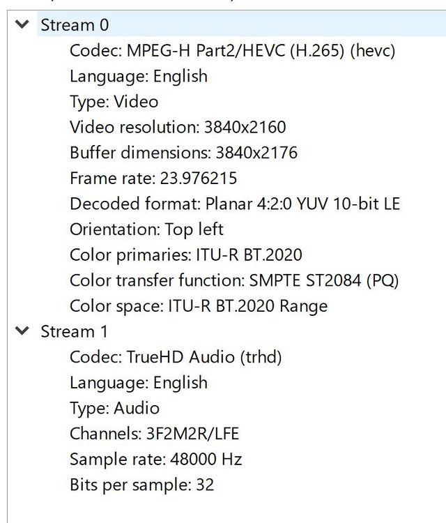

Spyderturbo007 19 Posted December 7, 2020 Author Posted December 7, 2020 I'm attaching the ffmpeg log from the file. It looks like it might be picking up the HDR flag, but I'm no expert at reading these things. I found "VideoRange" : "HDR" in the log. Just a side note, let's say the file is ripped correctly, would a Shield play it just like it was the disk? Thanks! ffmpeg-remux-a31ee143-3f98-42c4-84f4-cc2d3970078b_1.txt
vdatanet 1619 Posted December 7, 2020 Posted December 7, 2020 19 minutes ago, Spyderturbo007 said: I'm attaching the ffmpeg log from the file. It looks like it might be picking up the HDR flag, but I'm no expert at reading these things. I found "VideoRange" : "HDR" in the log. Just a side note, let's say the file is ripped correctly, would a Shield play it just like it was the disk? Thanks! ffmpeg-remux-a31ee143-3f98-42c4-84f4-cc2d3970078b_1.txt 58.16 kB · 1 download I have no experience with Rokus because they are not available in my country, but using Nvidia Shield HDR it is triggered if only audio is converted, although there is a segmentation problem and sometimes green glitches may appear.
ebr 16310 Posted December 7, 2020 Posted December 7, 2020 Hi. In the example you posted, we are passing the video through untouched so any quality degradation has to be either in the source, the Roku itself or the connections.
Spyderturbo007 19 Posted December 7, 2020 Author Posted December 7, 2020 Is the one I posted HDR? It doesn't appear on the Roku when I start playing as HDR. I'm assuming that's the difference.

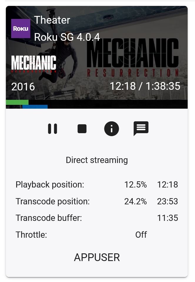

speechles 2062 Posted December 7, 2020 Posted December 7, 2020 (edited) 11 minutes ago, cayars said: @speechles Any chance you can show the currently being used color space on the SFN display? Entirely possible. Also possible to have "Stream Cards" like Android TV has which appear as a row on the detail screen. There is limited room though on these displays so what appears there must be important. Can also likely get a "transcoding progress" bar to appear on the video player transport bar on the Roku for transcoded progress with blue. Same exact way you see Android TV do this. Same exact way the server display it. Same colors. Same everything. Then you would know by the presence of that blue bar on the Roku that is was transcoding something. Then use stats for nerds to see what exactly is happening. Edited December 7, 2020 by speechles 1

ebr 16310 Posted December 7, 2020 Posted December 7, 2020 4 hours ago, speechles said: Can also likely get a "transcoding progress" bar to appear on the video player transport bar on the Roku for transcoded progress with blue. Same exact way you see Android TV That is not transcoding progress. That is the local player buffer. 1
speechles 2062 Posted December 7, 2020 Posted December 7, 2020 (edited) 1 hour ago, ebr said: That is not transcoding progress. That is the local player buffer. What color is transcoding progress? The local player buffer isn't exposed on the Roku. The best we have is the transcoding progress can be used against the playback position to give a transport buffer when transcoding. The stats for nerds is already doing all the maths to make it possible. Edited December 7, 2020 by speechles
ebr 16310 Posted December 8, 2020 Posted December 8, 2020 15 hours ago, speechles said: What color is transcoding progress? The local player buffer isn't exposed on the Roku. The best we have is the transcoding progress can be used against the playback position to give a transport buffer when transcoding. The stats for nerds is already doing all the maths to make it possible. No color at all. We don't show that in the player progress anywhere other than on the server dashboard.
