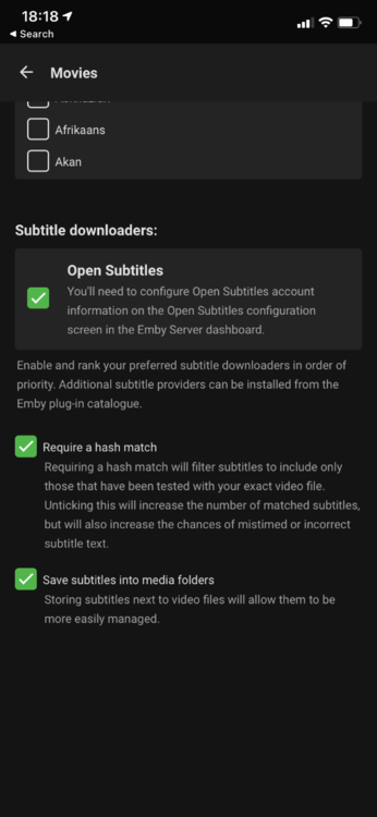

Depechie 12 Posted December 5, 2020 Posted December 5, 2020 Just wondering if I'm missing something obvious or not...? When I manually trigger a subtitle search ( with a configured opensubtitles account ), the downloaded srt is put into a subfolder of the config folder /config/metadata/library/27/27f84e82e8d988e18b038c6eae992b88/... instead of where the media file resides. Although I checked the setting for the Library and there is is indicated to save the srt with the media file.
Luke 42186 Posted December 5, 2020 Posted December 5, 2020 Hi there, did you explore the subtitle download options for your library?
Luke 42186 Posted December 5, 2020 Posted December 5, 2020 Then the server is most likely being denied write permission to your media folders. The server log can help confirm that.
