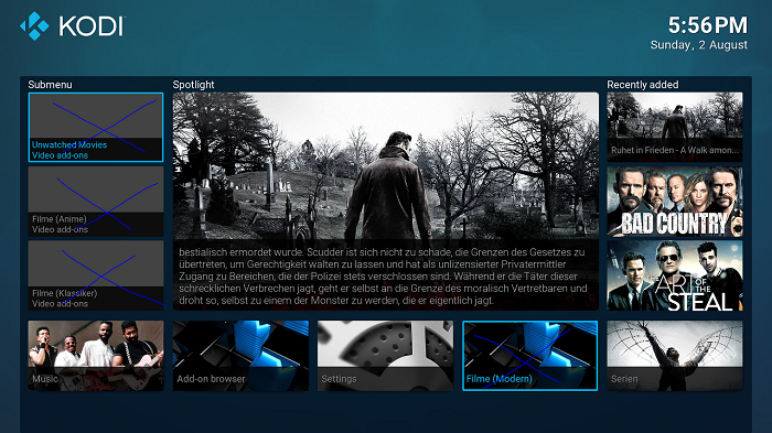

pünktchen 1411 Posted August 2, 2015 Posted August 2, 2015 Hi Marcel, maybe it was answered in this thread already, but up until now i've used an old version of Titan (before the theme/color overhaul) and also the old outdated Mediabrowser addon (never had any problem with this)... That's why i've followed only sporadic all the Titan posts. Now i've updated to the latest beta versions of Titan and the Emby addon and i'm a little bit lost. In my old setup every media section of Mediabrowser i put on the homescreen, shows their own random images within the tiles. Now with the Emby addon, the different media sections only show a "folder" placeholder image. I know i can choose some predefined "multiimages" like latest movies, but they are mixed across all movie libraries and therefore don't fit to the respective tiles [emoji20] Do i have to live with that, is something broken in my setup or is there no other way round?

pünktchen 1411 Posted August 2, 2015 Posted August 2, 2015 So i deleted guisettings.xml, Titan and skinshortcuts. Cached all images to Kodi texture cache in the Emby addon. Reinstalled Titan and added some smartshortcuts to the homescreen and get this: As you can see it works for series (they are grouped in the Emby server settings) but not for single movie libraries!
marcelveldt 736 Posted August 2, 2015 Author Posted August 2, 2015 @@pünktchen This is strange. Do you mind send me your Kodi log for review?

marcelveldt 736 Posted August 2, 2015 Author Posted August 2, 2015 Only have the latest 2. If i should start after cleanup or with debug mode enabled, just say it! I don't see anything strange in your logfiles. I'm suspecting a Unicode issue, as I also saw your post regarding the texture cache issue, which is also a Unicode problem (special chars). Could you please try the following ? 1. close Kodi 2. navigate to c:\users\username\appdata\roaming\kodi\addon_data\script.titanskin.helpers 3. subfolder resources\lib, open the file Utils.py in a texteditor 4. on line 8 change the line doDebugLog=False to doDebugLog=True 5. Start Kodi and let it run for about 10 minutes or so.Thjs will flood your kodi logfile with logging... 6. close down Kodi and undo the above change to Utils.py 7. send me the Kodi logfile that was just created I hope that I get some more info from that debug logfile because atm I don't understand why it's failing for you
