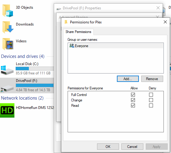

prestonplex 0 Posted December 4, 2020 Author Posted December 4, 2020 9 minutes ago, cayars said: I'm seeing entries in your log file such as System.UnauthorizedAccessException: System.UnauthorizedAccessException: Access to the path '/storage/GPDPBOX/Plex/PlexMedia/Plex Complete/TV/Surviving R.Kelly' is denied. ---> System.IO.IOException: Permission denied This looks like a permission problem. I don't understand why? The whole server is shared across the network. See attached my share permissions. Nvidia shield can access, Plex can access it..... but why can't Emby?
prestonplex 0 Posted December 4, 2020 Author Posted December 4, 2020 There's no password or login for local users on the network either.
