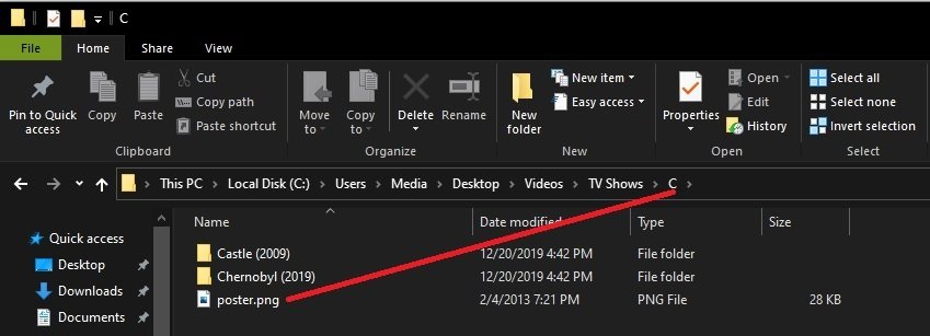

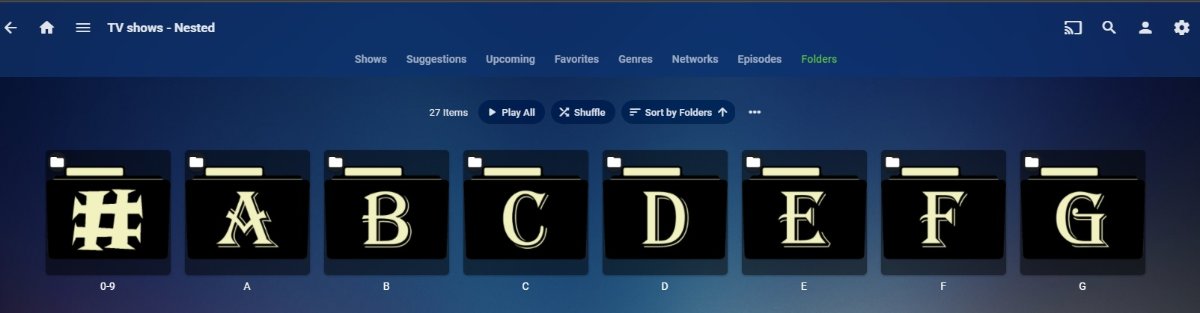

Happy2Play 9802 Posted December 1, 2020 Posted December 1, 2020 Yes folder or poster. Example this C folder shows the assigned folder image
