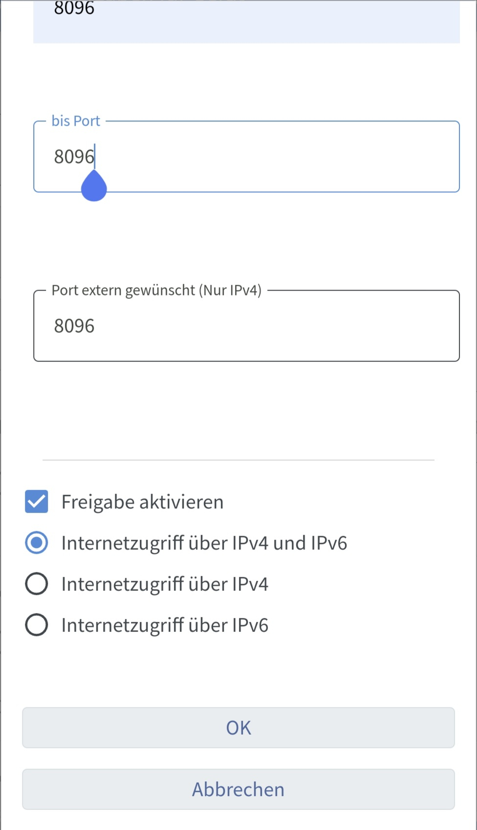

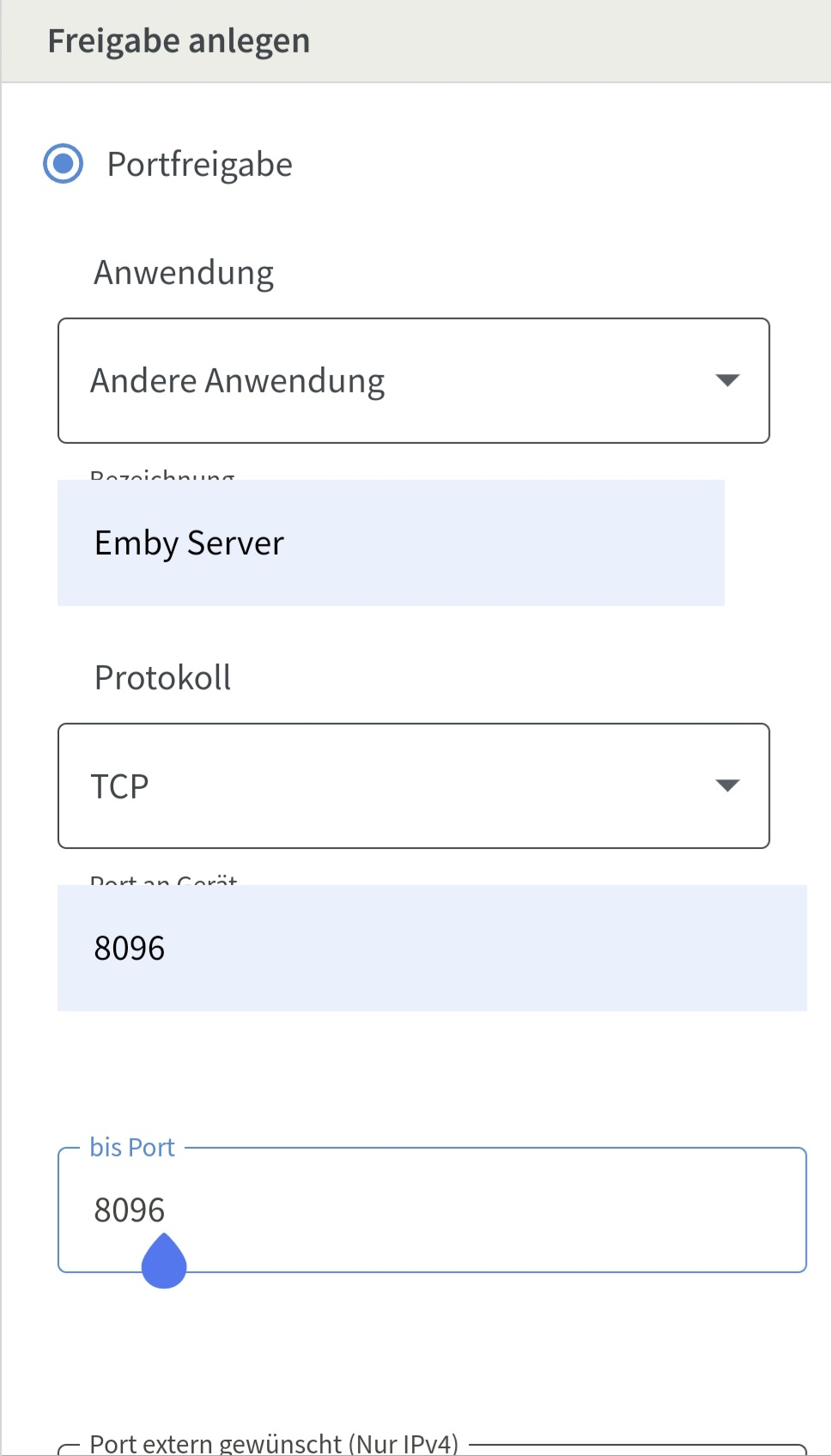

ChaoOos 2 Posted December 1, 2020 Author Posted December 1, 2020 @Luke Die 2 Links können mir nicht helfen. @cayars yea it's the same ip Die Einstellungen für Port Forwarding
Carlo 4561 Posted December 1, 2020 Posted December 1, 2020 That looks good. Try this. If windows open a command box and type: tracert 8.8.8.8 Copy/paste or screen grab the results and PM them to me (so people can't see your IP). What we're looking for is the first couple sets of IPs that show up past your WAN IP address. If they happen to be in the 10.x range, 192.x or 176.x range then that will indicate you're behind a cgnat (carrier grade network address translation).
