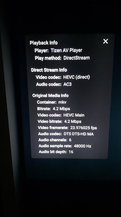

Hi,
I recorgnized, that the transcoding/remuxing reason seems not to be the real reason.
I have a Samsung Q90R (2019) and we all know this model is not able to direct play DTS.
My Movie actually has a DTS-HD-MA sound codec and it is just telling me "Direct Stream" AFAIK this means it is just changing the Container, but DTS isn't a container.
I also recorgnized this a few times it tells me the same "Direct Stream" on MKV Files and some other MKV Files are Direct Play.
So in my opinion there can just be a problem with the transcoding infos/reasons.
Maybe someone can explain this to me, could be i missed a thing.
thanks

This File only has a DTS-HD Codec, so for my understanding it must transcode because this TV is not able to play DTS.
Happy2Play
And if you click the info button what does it say?
Painkiller88

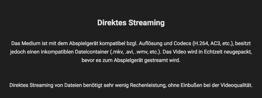

It tells me it supports all codecs (h264, ac3 etc...) but the container is incompatible. Don't remember the correct words but i can make a screenshot and translate if you need the exact phrase
Hi, Yes please.  Also if possible a screenshot/translation from stats for nerds on the client as well.
Imo the file is being remuxed to the not supported audio (DTS HD -> AC3).
But, only the logs can tell the truth though... 😉

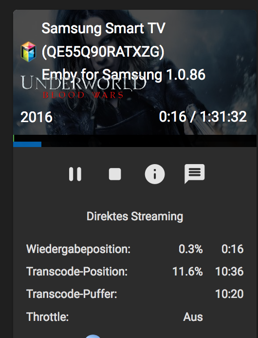

Here are the screenshots
The Text in Direct streams means the medium is compatible with all codecs (h264, ac3 etc.) but has an incompatible container.
In the nerds stats you can see, the original audio stream has been converted to AC3, so this is not a container and it should be transcoding. AC3 or DTS is not a container it is an audio codec and if it isn't supported like here on my tv, this message is wrong imo

It doesn't matter if it is transcoding, reencoding, remux, or what else if we have a more detailed overview in the next version.

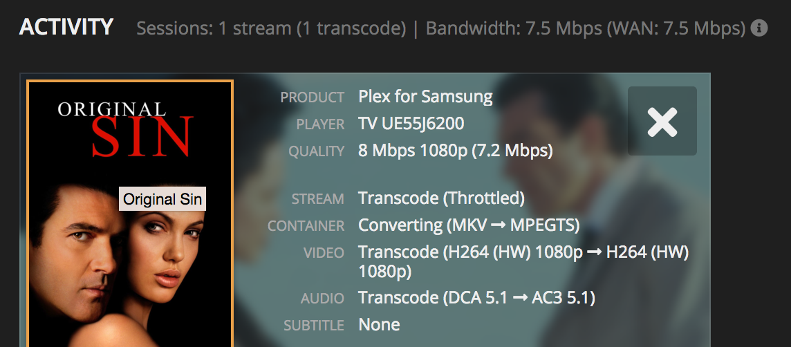

This is what we can see in plex or tautully, maybe you can take this as an idea, i think this makes much more easier to the people and it doesn't matter how it is called.
