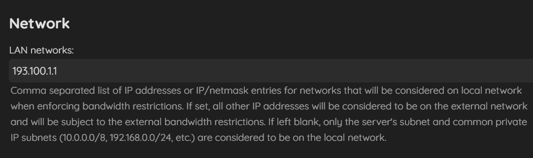

kaj 339 Posted November 29, 2020 Author Posted November 29, 2020 (edited) So if I put, in Server - Network - Lan networks a complete junk IP address (I rebooted Emby after this), I can still connect through to Emby, on the local network. It seems as if Emby is ignoring this? Edited November 29, 2020 by kaj
Luke 42246 Posted November 30, 2020 Posted November 30, 2020 19 hours ago, kaj said: So if I put, in Server - Network - Lan networks a complete junk IP address (I rebooted Emby after this), I can still connect through to Emby, on the local network. It seems as if Emby is ignoring this? Hi, did you read the help text underneath the option?
kaj 339 Posted November 30, 2020 Author Posted November 30, 2020 6 minutes ago, Luke said: Hi, did you read the help text underneath the option? I did. I think it means that all connections, apart from the 193.100.1.1, will be treated as remote connection. But they are not, they are all treated as local connections
Luke 42246 Posted November 30, 2020 Posted November 30, 2020 What you probably want to do instead is configure the proxy so that emby server will see the original ip addresses of the remote connections. Then on the server dashboard activity viewer you'll see the correct ip address for each remote connection.

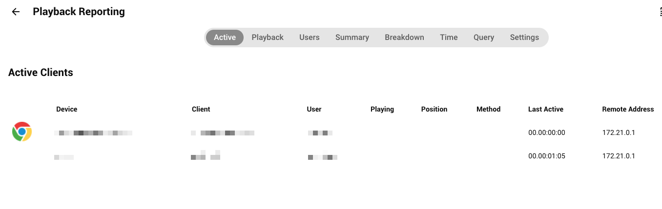

iBoss 31 Posted May 27, 2022 Posted May 27, 2022 @Luke please I need your support I think I have the same issue here or related. My issue when I use emby with reverse proxy all users connected have seen as local IP. Please see the screenshoot here emby Not Docker (4.7.1.0) Using Docker Nginx Proxy Manager 2.9.18 My config: server { set $forward_scheme http; set $server "172.21.0.1"; set $port 8096; listen 80; listen [::]:80; listen 443 ssl http2; listen [::]:443 ssl http2; server_name subdomain.mydomain.com; # Let's Encrypt SSL include conf.d/include/letsencrypt-acme-challenge.conf; include conf.d/include/ssl-ciphers.conf; ssl_certificate /etc/letsencrypt/live/npm-20/fullchain.pem; ssl_certificate_key /etc/letsencrypt/live/npm-20/privkey.pem; # HSTS (ngx_http_headers_module is required) (63072000 seconds = 2 years) add_header Strict-Transport-Security "max-age=63072000; preload" always; # Force SSL include conf.d/include/force-ssl.conf; access_log /data/logs/proxy-host-14_access.log proxy; error_log /data/logs/proxy-host-14_error.log warn; listen 8096; proxy_buffering off; sendfile off; gzip_disable "msie6"; gzip_comp_level 6; gzip_min_length 1100; gzip_buffers 16 8k; gzip_proxied any; gzip_types text/plain text/css text/js text/xml text/javascript application/javascript application/x-javascript application/json application/xml application/rss+xml image/svg+xml; proxy_connect_timeout 1h; proxy_send_timeout 1h; proxy_read_timeout 1h; location / { proxy_hide_header X-Powered-By; proxy_set_header Range $http_range; proxy_set_header If-Range $http_if_range; proxy_set_header X-Forwarded-For $proxy_add_x_forwarded_for; # Proxy! include conf.d/include/proxy.conf; } # Custom include /data/nginx/custom/server_proxy[.]conf; }
Luke 42246 Posted May 27, 2022 Posted May 27, 2022 3 hours ago, iBoss said: @Luke please I need your support I think I have the same issue here or related. My issue when I use emby with reverse proxy all users connected have seen as local IP. Please see the screenshoot here emby Not Docker (4.7.1.0) Using Docker Nginx Proxy Manager 2.9.18 My config: server { set $forward_scheme http; set $server "172.21.0.1"; set $port 8096; listen 80; listen [::]:80; listen 443 ssl http2; listen [::]:443 ssl http2; server_name subdomain.mydomain.com; # Let's Encrypt SSL include conf.d/include/letsencrypt-acme-challenge.conf; include conf.d/include/ssl-ciphers.conf; ssl_certificate /etc/letsencrypt/live/npm-20/fullchain.pem; ssl_certificate_key /etc/letsencrypt/live/npm-20/privkey.pem; # HSTS (ngx_http_headers_module is required) (63072000 seconds = 2 years) add_header Strict-Transport-Security "max-age=63072000; preload" always; # Force SSL include conf.d/include/force-ssl.conf; access_log /data/logs/proxy-host-14_access.log proxy; error_log /data/logs/proxy-host-14_error.log warn; listen 8096; proxy_buffering off; sendfile off; gzip_disable "msie6"; gzip_comp_level 6; gzip_min_length 1100; gzip_buffers 16 8k; gzip_proxied any; gzip_types text/plain text/css text/js text/xml text/javascript application/javascript application/x-javascript application/json application/xml application/rss+xml image/svg+xml; proxy_connect_timeout 1h; proxy_send_timeout 1h; proxy_read_timeout 1h; location / { proxy_hide_header X-Powered-By; proxy_set_header Range $http_range; proxy_set_header If-Range $http_if_range; proxy_set_header X-Forwarded-For $proxy_add_x_forwarded_for; # Proxy! include conf.d/include/proxy.conf; } # Custom include /data/nginx/custom/server_proxy[.]conf; } Hi, I would suggest comparing your nginx configuration to that of @pir8radio:
