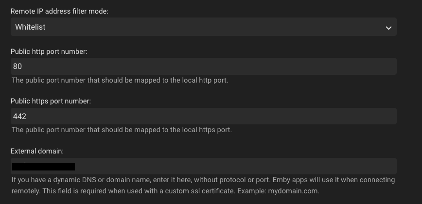

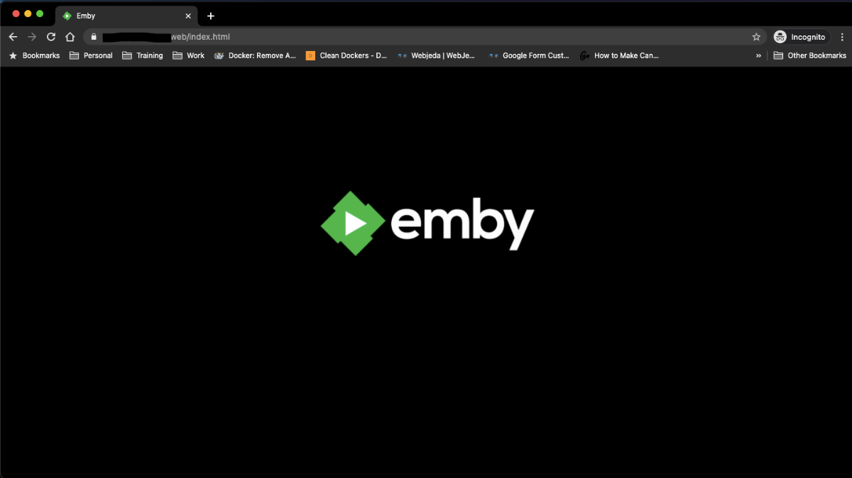

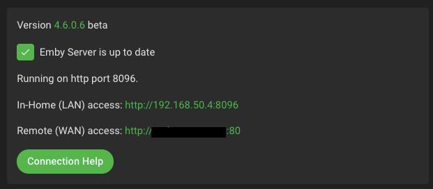

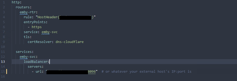

jhyoung09 0 Posted November 30, 2020 Posted November 30, 2020 Ok. I've come to the point where I can't beat my head against the wall anymore. I'm looking for some help here. Here's the setup: Windows VM set up with Emby installed as service Docker host running Treafik I have multiple containers being proxied through this, I know it works When I got to the URL I'm using I am obviously being piped to the emby server because I get the Emby splash screen. It will spin and act like it's loading something but not go anywhere. Attached are some of my screen shots on configs. I've looked through the forums and haven't been able to find anything that helps.

Carlo 4561 Posted November 30, 2020 Posted November 30, 2020 Hi, So you're using double proxies of both Cloudflare and Treafik?
Spaceboy 2573 Posted November 30, 2020 Posted November 30, 2020 i'd put my money on image caching at cloudflare. i've had similar issues in the past 1

ttgapers 99 Posted January 7, 2021 Posted January 7, 2021 Have you tried putting CF in Development mode temporarily? I've seen this as well with caching. 1. What are your cache settings in CF? Standard, Respect Browser TTL? 2. What are your page rules? I am Bypassing Cache for sub.domain.tld/web/* and since then I do not experience your issue (that I previously had) So, putting CF in development mode temporarily essentially bypasses CF cache and fetches from your origin (in this case Traeffik then Emby). 1
