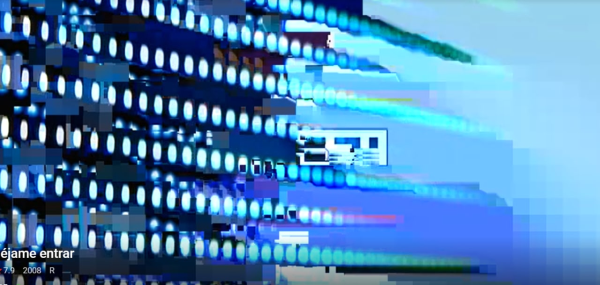

LeidenSpain 33 Posted November 29, 2020 Posted November 29, 2020 (edited) Hi, I bought premier to be able to use hardware transcoding, but I just found (just tested it) that the image quality is terrible I have tried several videos (avi and mpeg) and the same thing happens: image corruption I have followed these instructions: ffmpeg-transcode-ce1850d2-2772-4913-8e25-bb1a31f1d5b4_1.txt hardware_detection-63742276132.txt embyserver.txt Edited November 29, 2020 by LeidenSpai

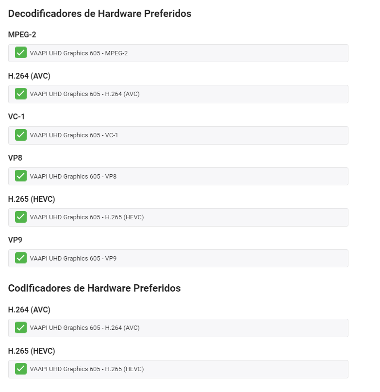

LeidenSpain 33 Posted November 29, 2020 Author Posted November 29, 2020 For what it's worth, I see it uses VAAPI, and it won't let me select QSV. Maybe using QSV would look better?

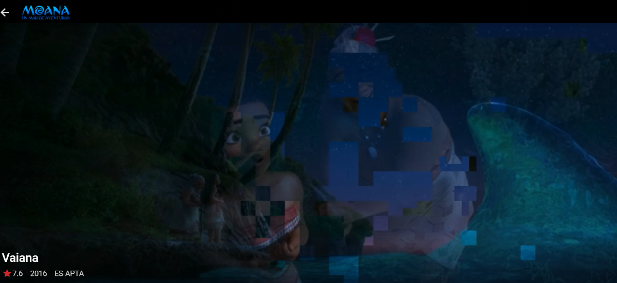

LeidenSpain 33 Posted November 30, 2020 Author Posted November 30, 2020 Hi, I have tried from the emby app and it looks perfectly, without problems (but because on the mobile it did not do transcoding). I have tried lowering the quality to form the transcoding, and it looks bad too. In Windows it looks bad in both Chrome and Edge Regards

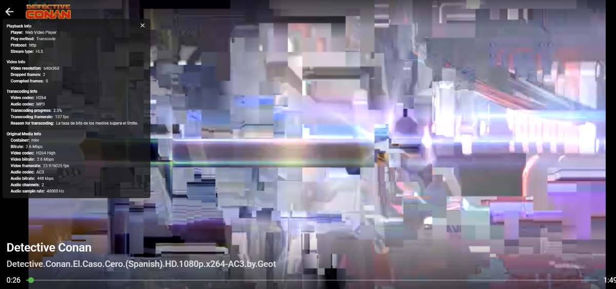

Luke 42246 Posted November 30, 2020 Posted November 30, 2020 Can you provide the log from an h264 example? Thanks.
LeidenSpain 33 Posted November 30, 2020 Author Posted November 30, 2020 49 minutes ago, Luke said: Can you provide the log from an h264 example? Thanks. OK, I try tomorrow. And, now, I can't disable the hardware acceleration. I can wait for an hour, but it is not saved. And not in advanced mode either.
dEeds83 0 Posted December 1, 2020 Posted December 1, 2020 Attached a log from Live TV via Transcoding... ffmpeg-transcode-bb5b719c-3e58-4b8c-8aa8-2b9efc0c7c1a_1.txt

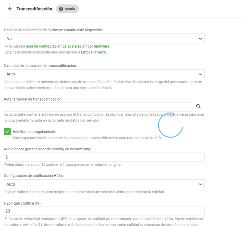

LeidenSpain 33 Posted December 1, 2020 Author Posted December 1, 2020 16 hours ago, Luke said: Server log from that? Thanks. I have finally disabled hardware transcoding through the mobile

LeidenSpain 33 Posted December 1, 2020 Author Posted December 1, 2020 27 minutes ago, Luke said: Did that help? Hardware transcoding continues to fail, so at least for now I use software transcoding

LeidenSpain 33 Posted December 2, 2020 Author Posted December 2, 2020 I have tried with the i965 and i965-shaders driver, but the result is the same

LeidenSpain 33 Posted December 3, 2020 Author Posted December 3, 2020 I have looked for information to test if the hardware acceleration of my computer works, and if it works. So the problem seems to be with docker or with emby
