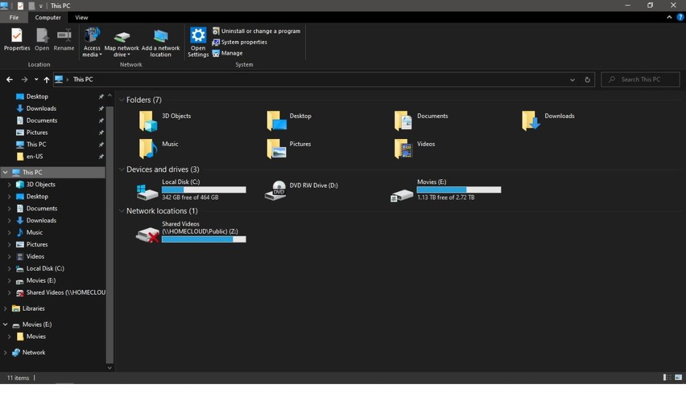

BuckeyParker 1 Posted November 29, 2020 Author Posted November 29, 2020 The \\192.168.10.100 is a static IP. It hasn't given me any troubles at all oddly enough. Enclosed are screenshots of my file structure and emby server Library page. File names show timeline. Thank you embyserver.txt hardware_detection-63742190092.txt
BuckeyParker 1 Posted November 29, 2020 Author Posted November 29, 2020 Movies are in E:/Movies TV Shows on the Network drive. Network drive is fine. E:/Movies is what is not scanning into the library. It was there once and as I added new movies to it, I noticed it wasn't adding the newly added files. Scanned, scanned, scanned. Restarted server, remove source, restarted, added source back. Scanned - No files showing. Ive even uninstalled the server altogether. Server is running on Windows 10 and E:/Movies is an external USB HDD

Carlo 4561 Posted November 29, 2020 Posted November 29, 2020 I don't see The \\192.168.10.100 at all on your Filemon pictures. In Emby I'm seeing .113 and on Windows HOMECLOUD. Are these all the same thing? Can you not use name so IP isn't important?
BuckeyParker 1 Posted November 29, 2020 Author Posted November 29, 2020 Yes, they are the same. 113 is designated by the router and somewhere in between either my PC or emby is changing it. BUT, the HOMECLOUD drive is seen. It recognizes new files perfectly. It plays perfectly. It's the USB external that's not being seen. I enabled debug logging, restarted, and scanned files again and not so much as a flicker on the light of the drive. No green bar in emby that denotes scanning is taking place. It will scan if I scan everything,. But when I click on the actual E:/ movies library and select scan, nothing happens. The log file after debugging enabled is enclosed. embyserver.txt
