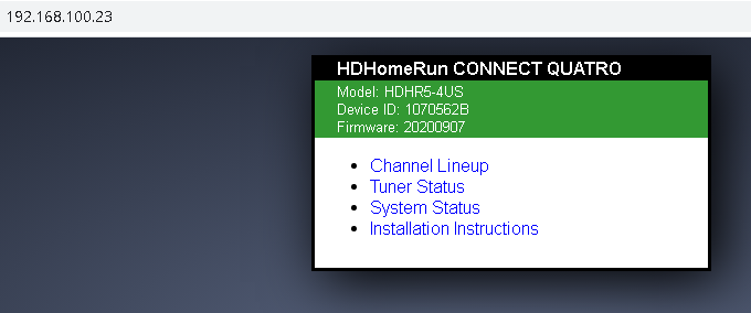

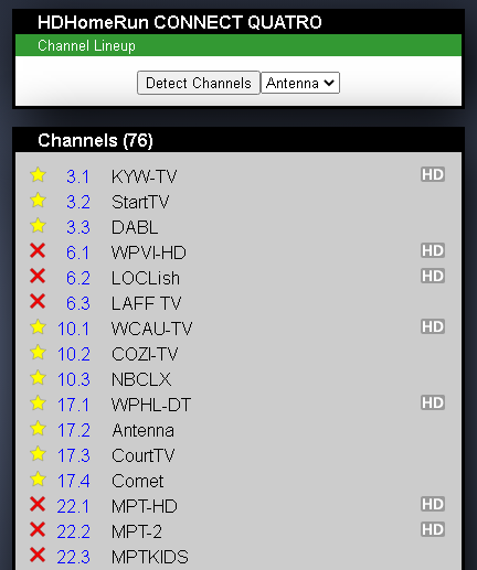

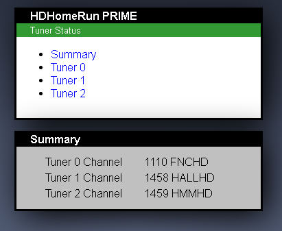

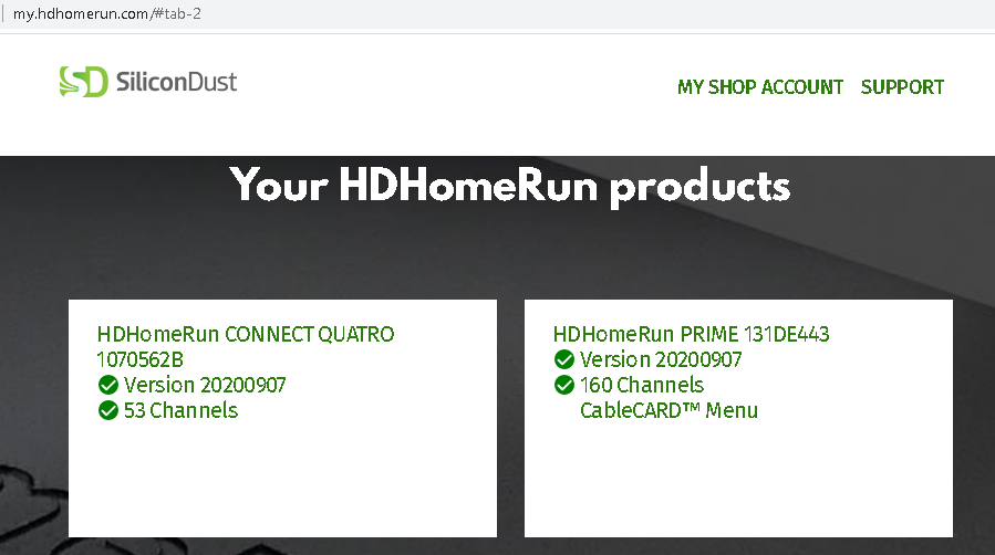

Carlo 4561 Posted November 28, 2020 Posted November 28, 2020 You can open the web app in a browser using http://my.hdhomerun.com/ Click on a tuner and you'll get this: Now Click on Channel Lineup and you'll get a similar screen If you click on the left icon you can make them a yellow star which is a favorite or a red X. Anything that's a red X should not import in Emby. So what you can do is configure so only one tuner has that channel active. Then reload that tuner in Emby so it pulls the new channel list. When testing again in Emby you can use the Tuner Status menu in the hdhomerun web app to see what's using the tuners such as: That will help you very what tuner is being used. Let me know if this helps, Carlo

pwhodges 2028 Posted November 28, 2020 Posted November 28, 2020 16 minutes ago, cayars said: You can open the web app in a browser using http://my.hdhomerun.com/ Note that this can fail. On my desktop that website says it cannot detect my device - but on the same machine I can connect to it directly and configure it. But other machines on my network find the device as expected. I have as yet failed to find out what's different - I guess I need to go network sniffing... Paul
Carlo 4561 Posted November 28, 2020 Posted November 28, 2020 I'd check to see if you're blocking UPnP messages as I believe that's what's used to discover the devices.
pwhodges 2028 Posted November 28, 2020 Posted November 28, 2020 UPnP is on (well, network discovery is), and Windows shows the device in the network map. But that website doesn't see it, in any browser (Opera, Firefox, Edge). Paul
Carlo 4561 Posted November 28, 2020 Posted November 28, 2020 Probably should ask about this over on the SD forums. Have you rebooted your router lately?

pwhodges 2028 Posted November 28, 2020 Posted November 28, 2020 35 minutes ago, cayars said: Probably should ask about this over on the SD forums. Have you rebooted your router lately? (Last reply on the OT subject) SD forums failed to find an answer; router reboots - several over a year or more! Paul
