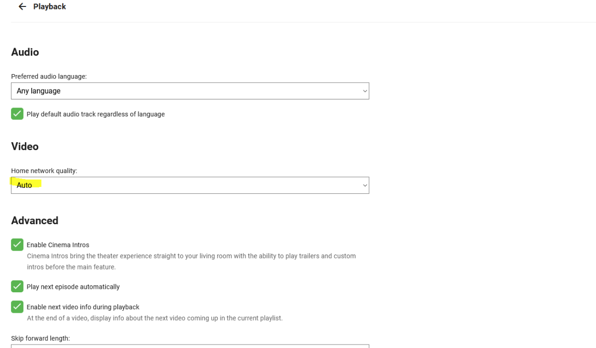

Happy2Play 9802 Posted November 25, 2020 Posted November 25, 2020 What is your device playback quality set to? Is there a ffmpeg log? 2020-11-24 16:54:18.750 Info App: Bitrate exceeds DirectPlay limit: media bitrate: 6521069, max bitrate: 1500000
Exodus743 0 Posted November 25, 2020 Author Posted November 25, 2020 Hello! Playback on the server is set to Auto from the looks of it and I do not see any ffmpeg log as shown below. Just server and hardware detection! Thank you for your help.
Carlo 4561 Posted November 25, 2020 Posted November 25, 2020 Those are settings for the web player for THAT ACCOUNT ONLY and not server settings. There are similar setting in EVERY client. If these are devices on your home lan where the server is location you may want to try setting them at the max setting and not using auto.
