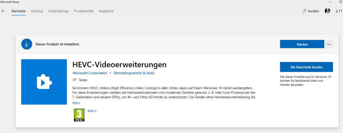

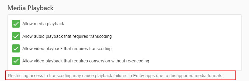

Happy2Play 9811 Posted November 21, 2020 Posted November 21, 2020 First question would be does you Windows 10 system support HEVC as the Store app is dependent on the platform. App: Emby for Windows 1.1.326.0 >>>>>> User policy for fam.rudi EnablePlaybackRemuxing: True EnableVideoPlaybackTranscoding: False EnableAudioPlaybackTranscoding: True
grudi 5 Posted November 22, 2020 Author Posted November 22, 2020 15 hours ago, Happy2Play said: First question would be does you Windows 10 system support HEVC as the Store app is dependent on the platform. App: Emby for Windows 1.1.326.0 >>>>>> User policy for fam.rudi EnablePlaybackRemuxing: True EnableVideoPlaybackTranscoding: False EnableAudioPlaybackTranscoding: True Yep. HEVC is installed
grudi 5 Posted November 22, 2020 Author Posted November 22, 2020 (edited) 16 hours ago, Luke said: Hi, Thanks. Indeed, I disabled "Allow video playback that requires transcoding" because emby want's always to transcode movies due to the high bitrate. Effectivly my network can handle high bitrate videos without any problem. But that was the only solution to force emby to not encoded the video. What is strange though is that VLC can play the same movie without any problem. But emby can't. Is this normal? Thx, Giuseppe Edited November 22, 2020 by grudi
