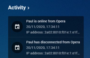

pwhodges 2028 Posted November 20, 2020 Posted November 20, 2020 (edited) I have a full IPv6 service (as well as IPv4, of course) from my ISP. My system and router are all set up using both IPv4 and IPv6, including specifying the IPv6 local addresses in Emby - which seems happy to accept them. It works just fine: But I don't know if Emby Connect handles IPv6 addresses, as I don't use it. Paul Edited November 20, 2020 by pwhodges

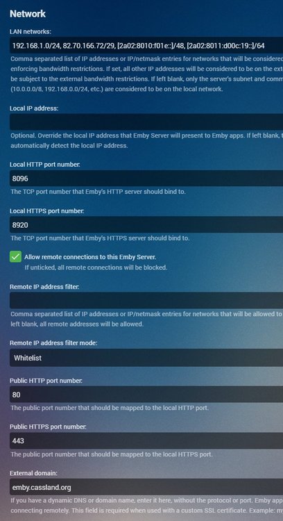

Midaz 3 Posted November 20, 2020 Author Posted November 20, 2020 2 minutes ago, pwhodges said: I have a full IPv6 service (as well as IPv4, of course) from my ISP. My system and router are all set up using both IPv4 and IPv6, including specifying the IPv6 local addresses in Emby - which seems happy to accept them. It works just fine: Paul Paul could you send a screenshoot of network config ? . . .. did you put ipv 6 on config .. or ipv4. ( And what is appearing on your dashboard as remotly access) ? Im asking that due carrier are giving just private ipv4 ( people call it as cgnat). And as per i read looking on the web . Ipv6 has the posibility to setup as stable and also talk about we have public ipv6 - ( i don't know if it is true and how to perform this setup )
pwhodges 2028 Posted November 20, 2020 Posted November 20, 2020 (edited) For the local network I specified all possible internal addresses the local IP address of the server is optional (it takes it from the OS, which has both IPv4 and IPv6 addresses), and the external domain is specified by name: External access comes through a reverse proxy (Caddy), but that handles both protocols, and nothing is specified numerically in its setup. Paul Edited November 20, 2020 by pwhodges
