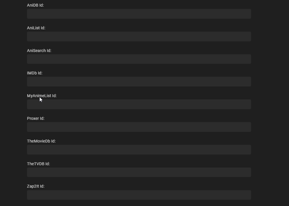

WolverineKnight
AniDB, AniList, AniSearch, IMDB, MyAnimeList, Proxer, TheMovieDB, The TVDB ID, Zap2IT.
Zap2IT has it right, is there a way to pull from there instead of TVDB because TVDB is wrong.

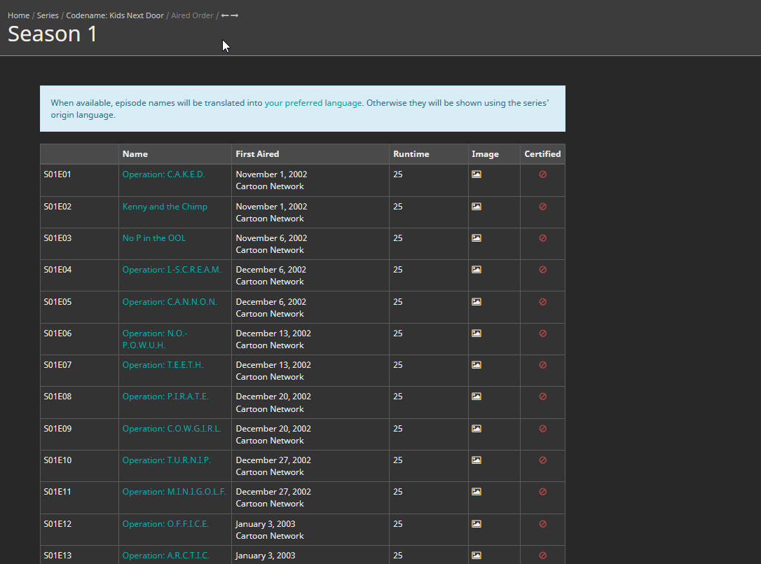

So make this easier. This is how it is listed in TVDB (the show is Codename: Kids Next Door). This is incorrect. I will try OMDB but how do I find the ID?

This is a common issue with all multi episode cartoons as the multi episode do not match provider metadata.  TVDB breaks them out per episode so you would need to name them accordingly.  So IMDB episode S01E01 would be TVDB/TMDB S01E01-E03 and so on, S01E02 would actually be S01E04-E05.
But this is actually dependent on what the files contain, but this Show would appear to be the way I have shown above.

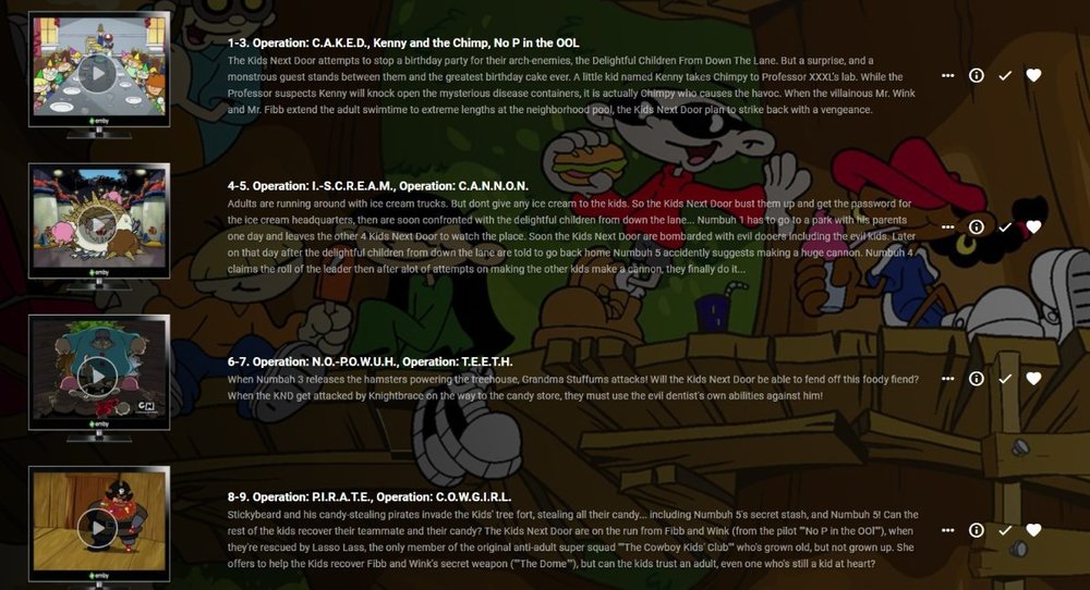

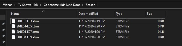

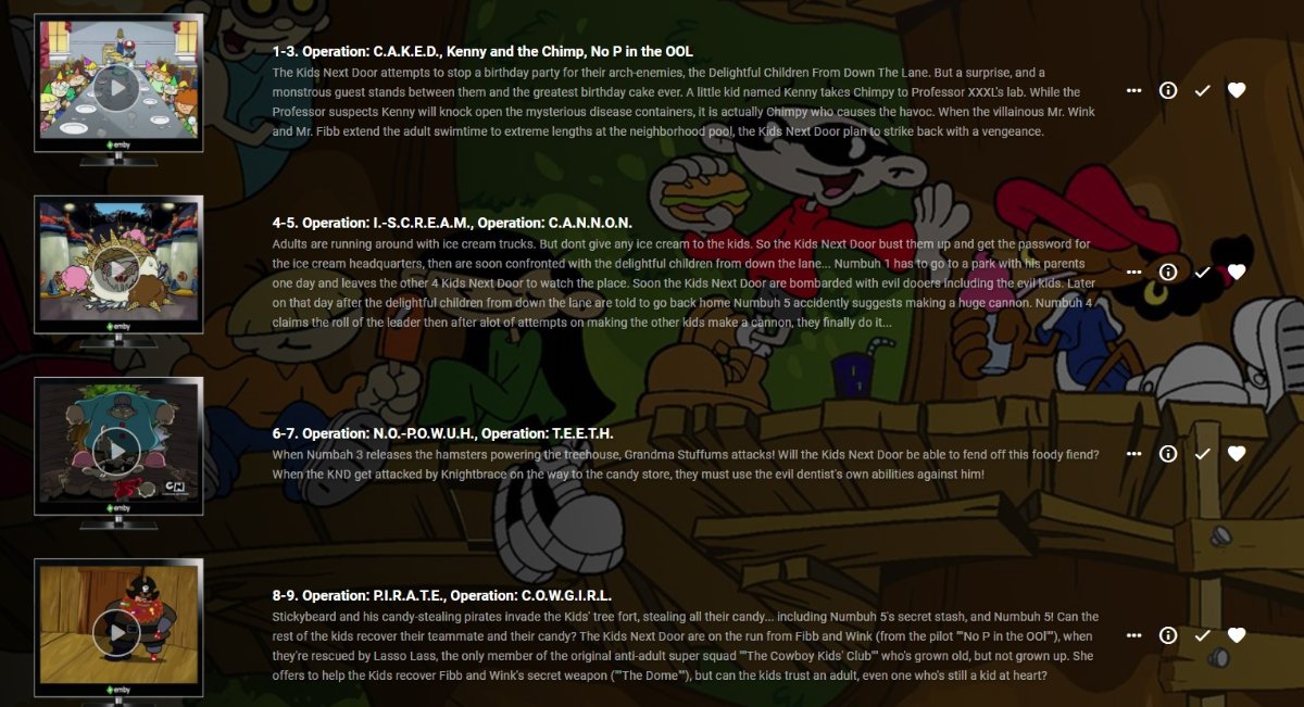

So I kind of got it work. Here the end product. I used TVDB and used S01 E01-E02 format.

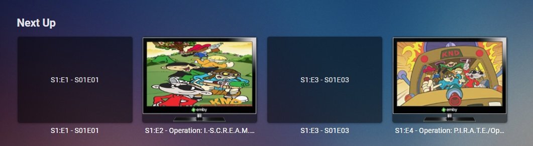

WolverineKnight
I labeled them S01 E01-E02, etc. based on how they are listed in TVDB. But I don't see the multiple titles. When I tried to use OMDB, it listed them wrong using the same format.
Happy2Play
5 minutes ago, WolverineKnight said:
S01 E01-E02
You can not have the space the name as it is not supported.  Only the naming schemes listed in the KB.

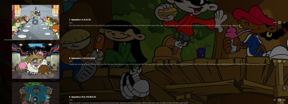

Here is what I tested with and got the above image.
