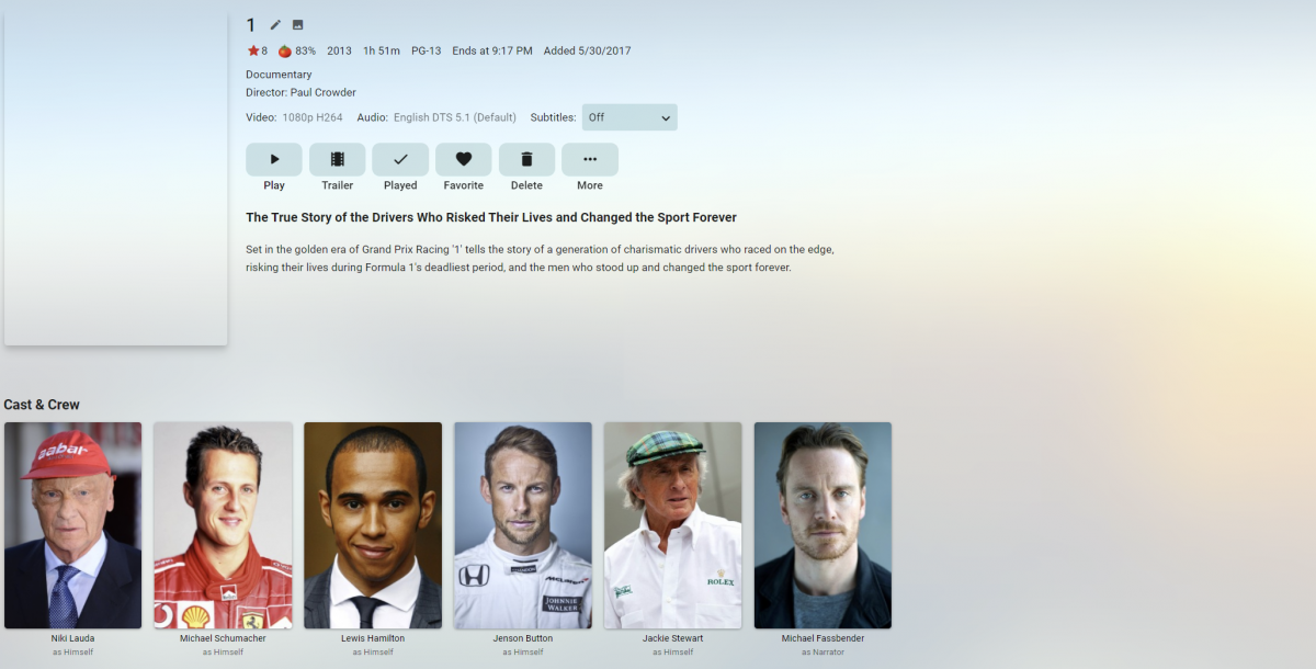

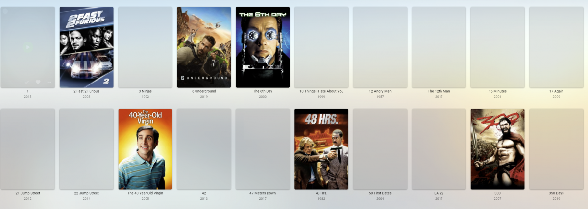

NanoboyDK 1 Posted November 15, 2020 Posted November 15, 2020 Hi all Long time Plex user here trying out Emby. Installation went pretty smoothly and I managed to add my movie and series directories in the library manager...Everything is found but for both movies and series I have no "'Main" posters for multiple items...maybe only 20-25% of movies have posters. It seems metadata is perfectly downloaded for each item as shown below. Am I doing anything wrong or am I facing an issue of sorts? Let me know if I need to supply any relevant logs or similar. Thanks in advance.

NanoboyDK 1 Posted November 15, 2020 Author Posted November 15, 2020 1 hour ago, cayars said: Hi, Was you library still loading/refreshing at this point in time or has it completed initial scanning? I finished the installation a week ago or so and It completed since then. Also, I've tried refreshing metadata and pictures a time since then, same result. No backdrops are displayed neither.... 1 hour ago, Happy2Play said: Can you post a server log as it may shed more light if there is a issue. I'll try and figure out how to get them out of my docker image, bit of a Unix rookie thanks.

NanoboyDK 1 Posted November 15, 2020 Author Posted November 15, 2020 Thanks a ton to cayars Took a look at my installation and found that I had configured it to write to the same folder as media contents which is in fact read-only - Made some modifications to the installation and voila, pictures downloading! Really appreciate it mate, thanks! 1
