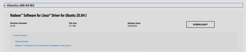

flexage 125 Posted November 15, 2020 Author Posted November 15, 2020 Sorry, default negative mode after a long night. Honestly didn't mean to sound ungrateful for your advice. With the drivers, I followed the GPU selection tool on the AMD drivers page, and installed the next revision up, 20.40, this was on both the bare metal Ubuntu, and also in the Ubuntu VM previously. I suppose I assumed they'd want more details than I had gathered here, and I'd already destroyed my previous test environments - but I suppose grabbing the information in this thread, including the references you kindly sourced would go a long way. I agree, support ticket or phone call would be the way to go, will check out their support portal tomorrow, and see if they get back with anything. Sorry again for sounding ungrateful, just tired, there's been quite a bit of leg work (metaphorically speaking) on this one, will have to change my handle to Grandpa Flex
