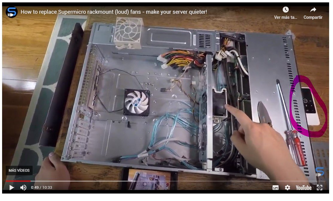

sooty234 266 Posted November 15, 2020 Author Posted November 15, 2020 I haven't bought it yet, but this is what I would have to do with all 7 fans (I have better tools than this guys).

vdatanet 1619 Posted November 16, 2020 Posted November 16, 2020 9 hours ago, sooty234 said: I have better tools than this guys But they have an Apple TV!!! 1
sooty234 266 Posted November 16, 2020 Author Posted November 16, 2020 I did say I have better tools 2
